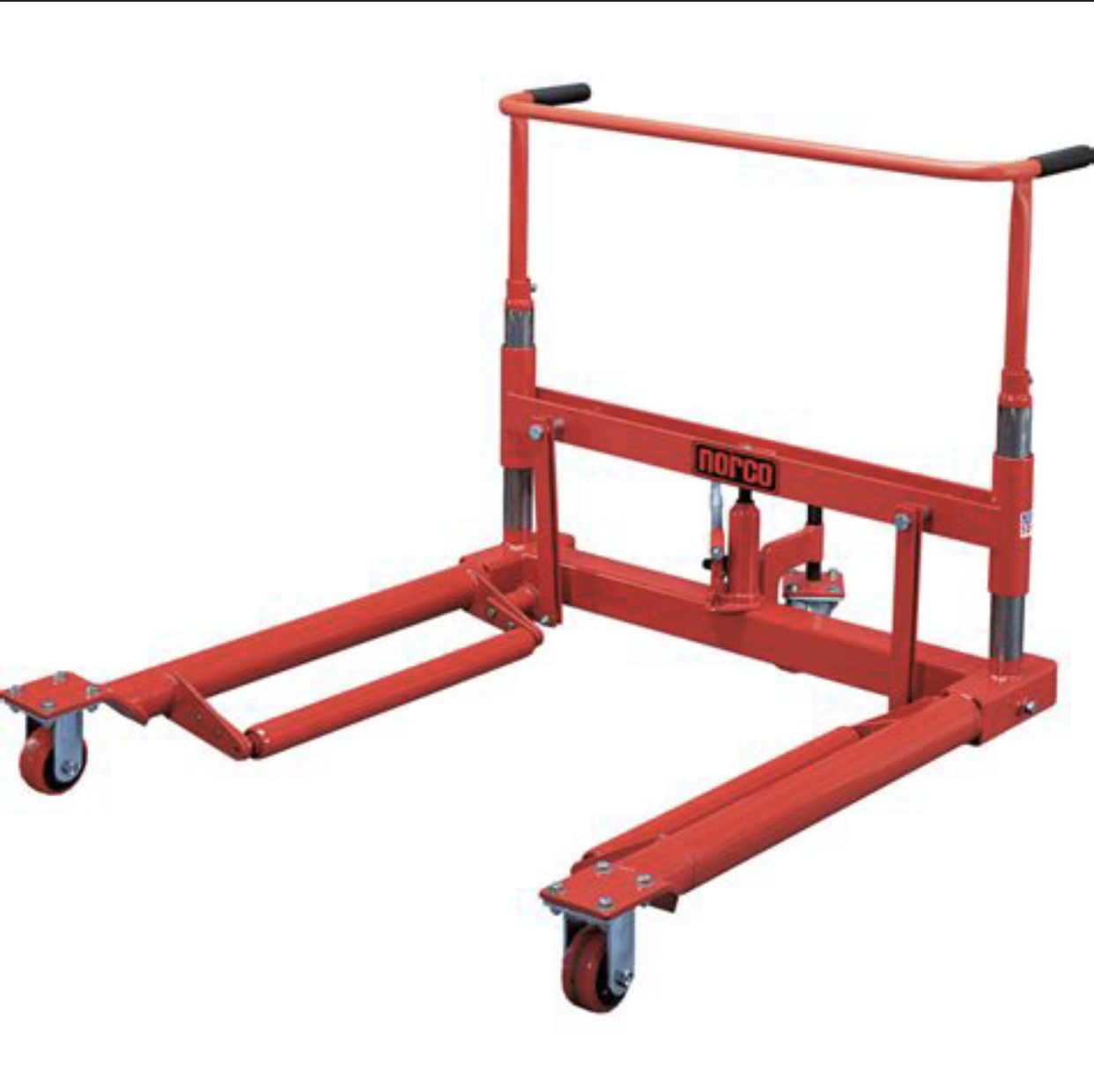

When I worked in heavy equipment this is how we got wheels off machines however they can be expense, you may be able to rent one. Search for a “tire dolly”
cheaper and not as stable option. but should work

Thanks @Crash277 - I was considering using an engine hoist but the dolly might be a more stable option.
Another possible option would be a pallet jack but you need at least one helper to keep the tire standing straight. It worked with the Space Shuttle main landing gear tires, at least for a while.
