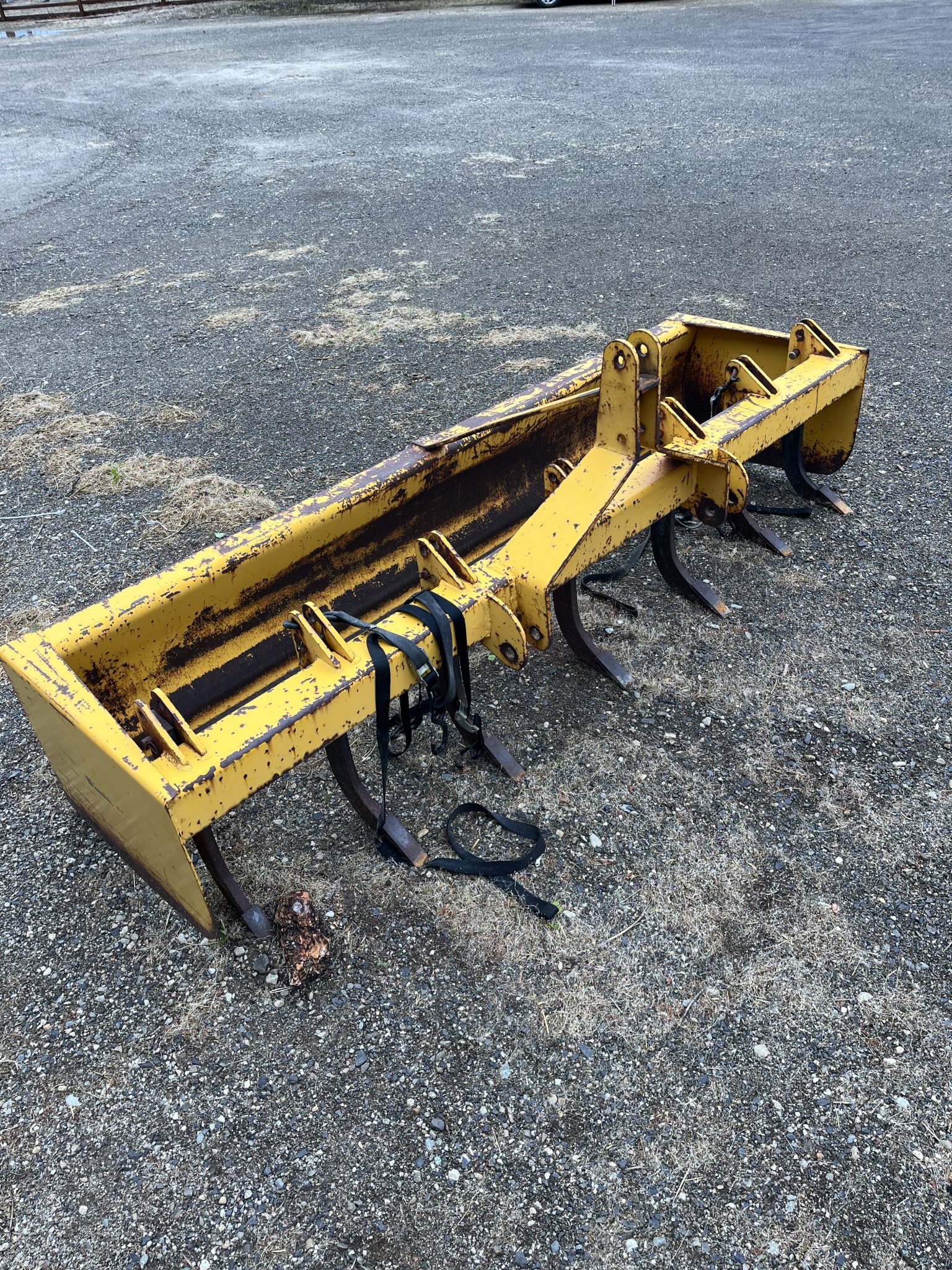

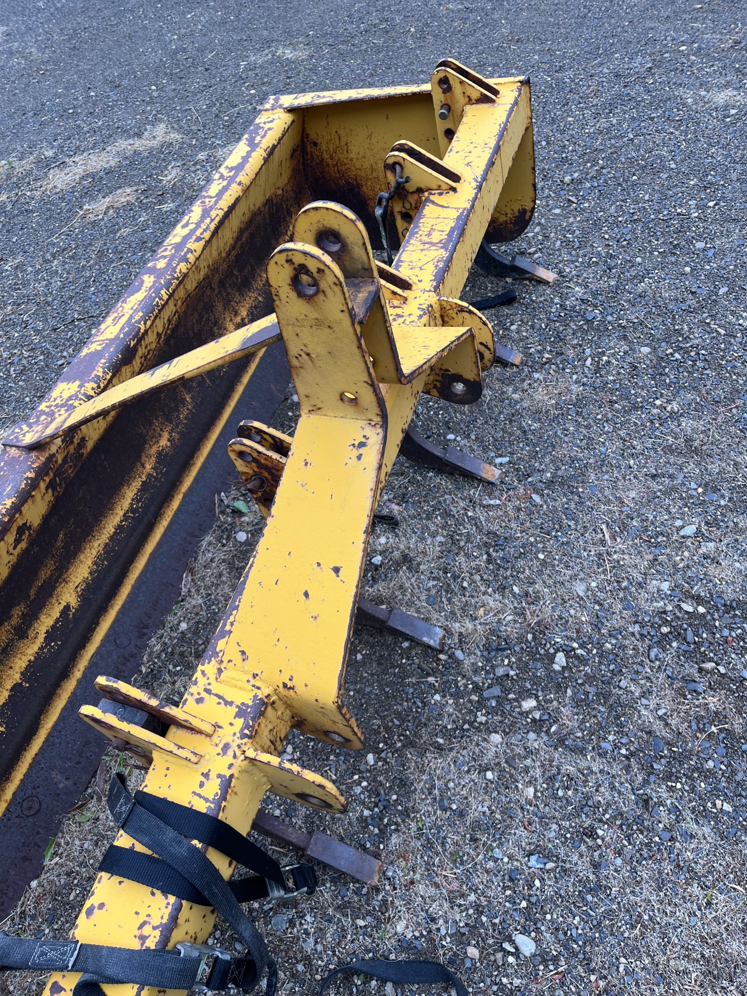

I picked up this box blade. And I’m thinking about converting it to work with my quick hitch. Anybody have any slick ideas how to do that? I have some ideas, but if anybody’s got a better one or has done it before I’d appreciate some insight.
Thanks, Ben

May have to move the flat bar down lower, put a piece of pipe between the holes in the top and put bolt in and tighten.

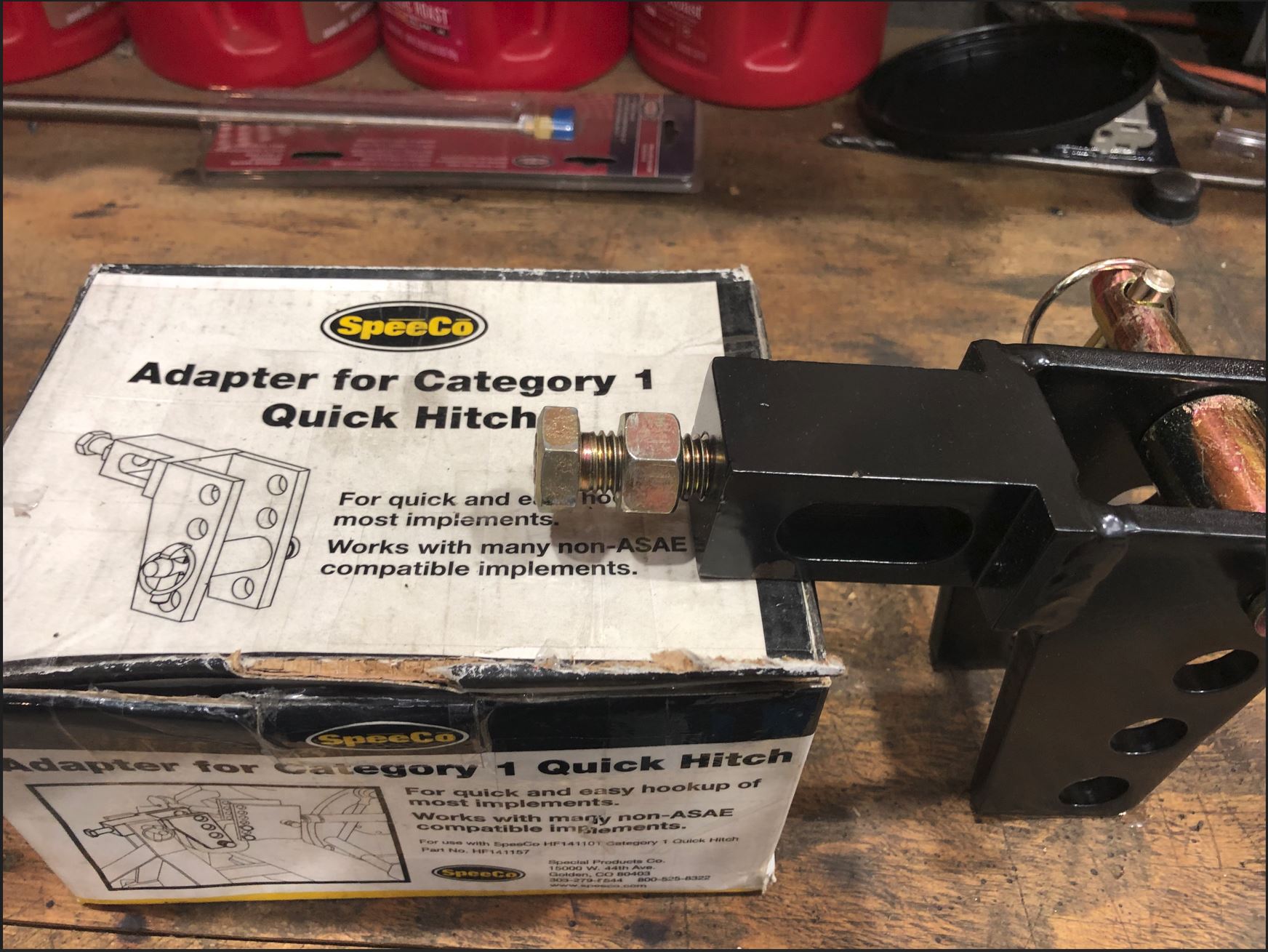

Simple...
28,973
5,318
Weld a plate on the back side, cut the plate out in between the center, then put a spacer pipe/ bushing and a bolt through the top.

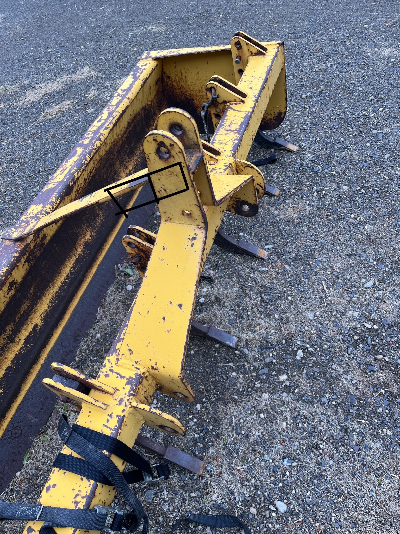

First thing that came to my head was...
Weld a plate on each side like this. You might have to put a "jog" or "step" (middle vertical line) in it to account for the thickness of the vertical part. Be sure to go back on that trailing piece a few inches.
Then cut out the bottom plate that is in the way and run a bolt/bushing through the holes.

Mine came with the speeco e-hitch but somehow I ended up with two of them. Since my hitch came from EA, maybe that's why they went bankrupt?
The style that WFM posted above is pretty common. Amazon or tractor supply will have them in stock.
