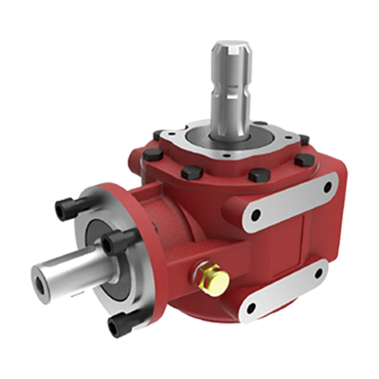

This is an example......
I could see something like this, bolted to the outside case, aligned with the pto shaft connected to the pulley. It is at 90 degrees, the pto shaft and the pulley. Im thinking this will be trial and error...
