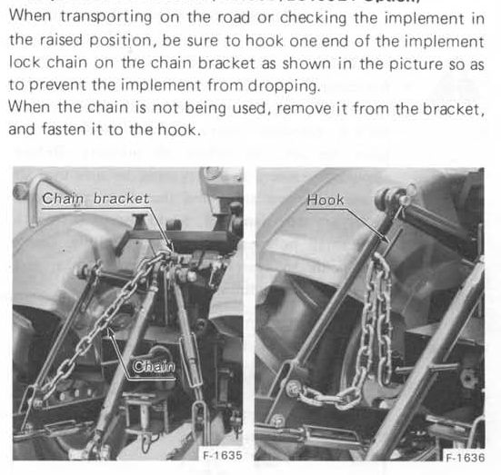

I've got a "chain claw" on the back of my B6100 just above the top link mount. I'm positive it's factory and I've always wondered what its intended use was?
I've found various use's for it over the years, but never understood its intended use. When I had water contamination over the winter, I was able to lift up the three point with a jack and hook the chain on the three point linkage there too keep my weight rack off the ground. Speaking of chain, I don't understand that either, its attached to the LH lower link, and just stays looped up out of the way.. I know that's factory because those links were for my TLB and had never been used.
Obviously it wouldn't get used for pulling... that would be asking to get hurt.
28,878
5,264
It's there to hold the transport holding chain.
It's a chain for holding up the 3 point while transporting implements any distance or time.

No its actually there as like a top link on some tillers. If you've ever seen pictures of a grey market B6000 or B6001 with a permanent mounted tiller the top link on it was a chain and not a threaded top link. It allowed the tiller to float and not launch back up.
