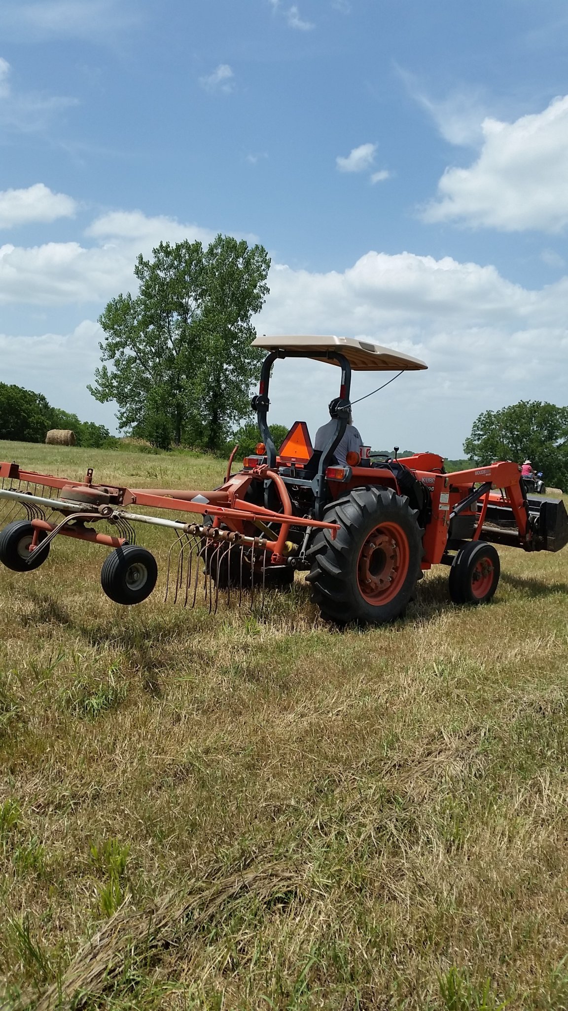

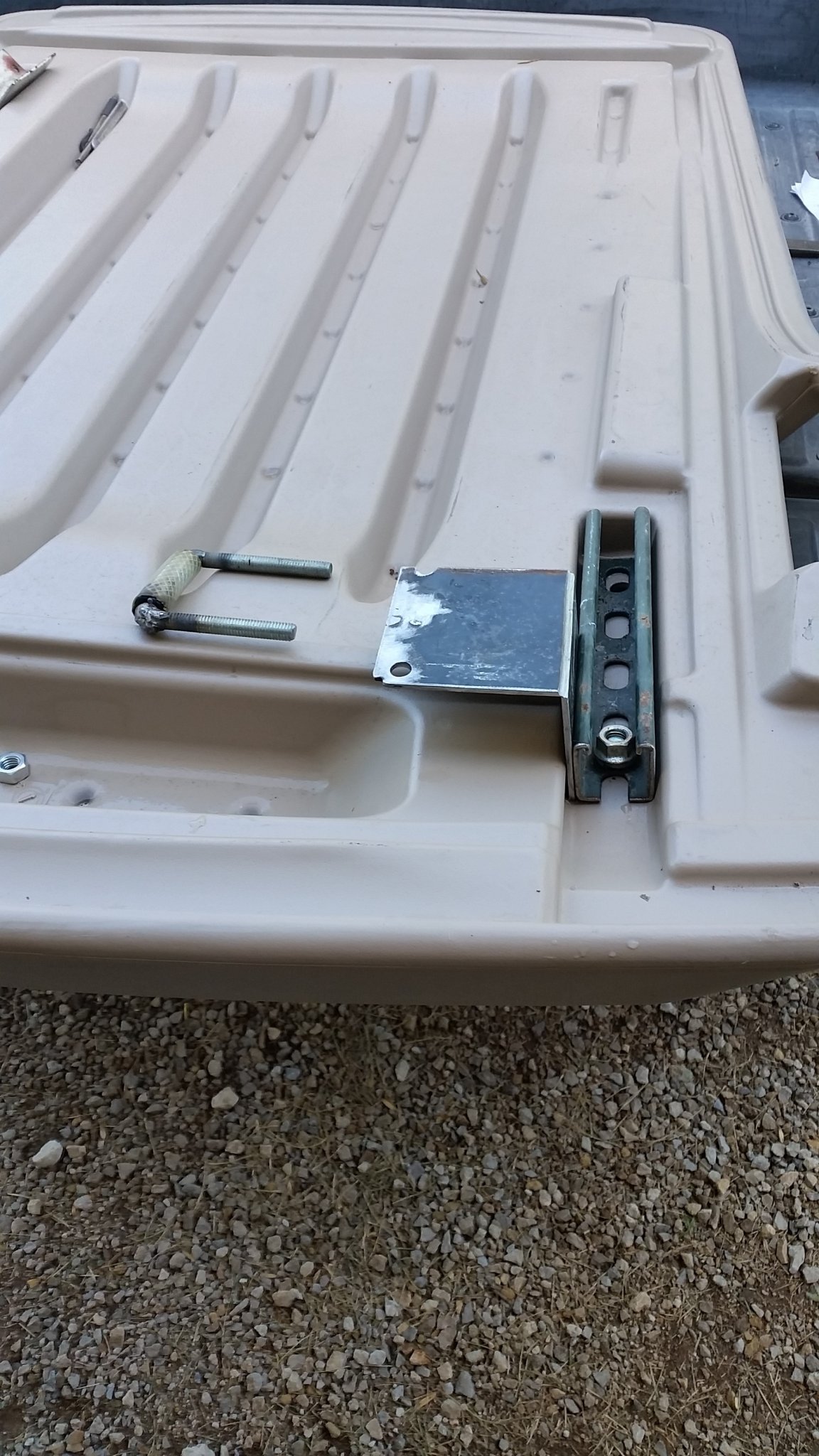

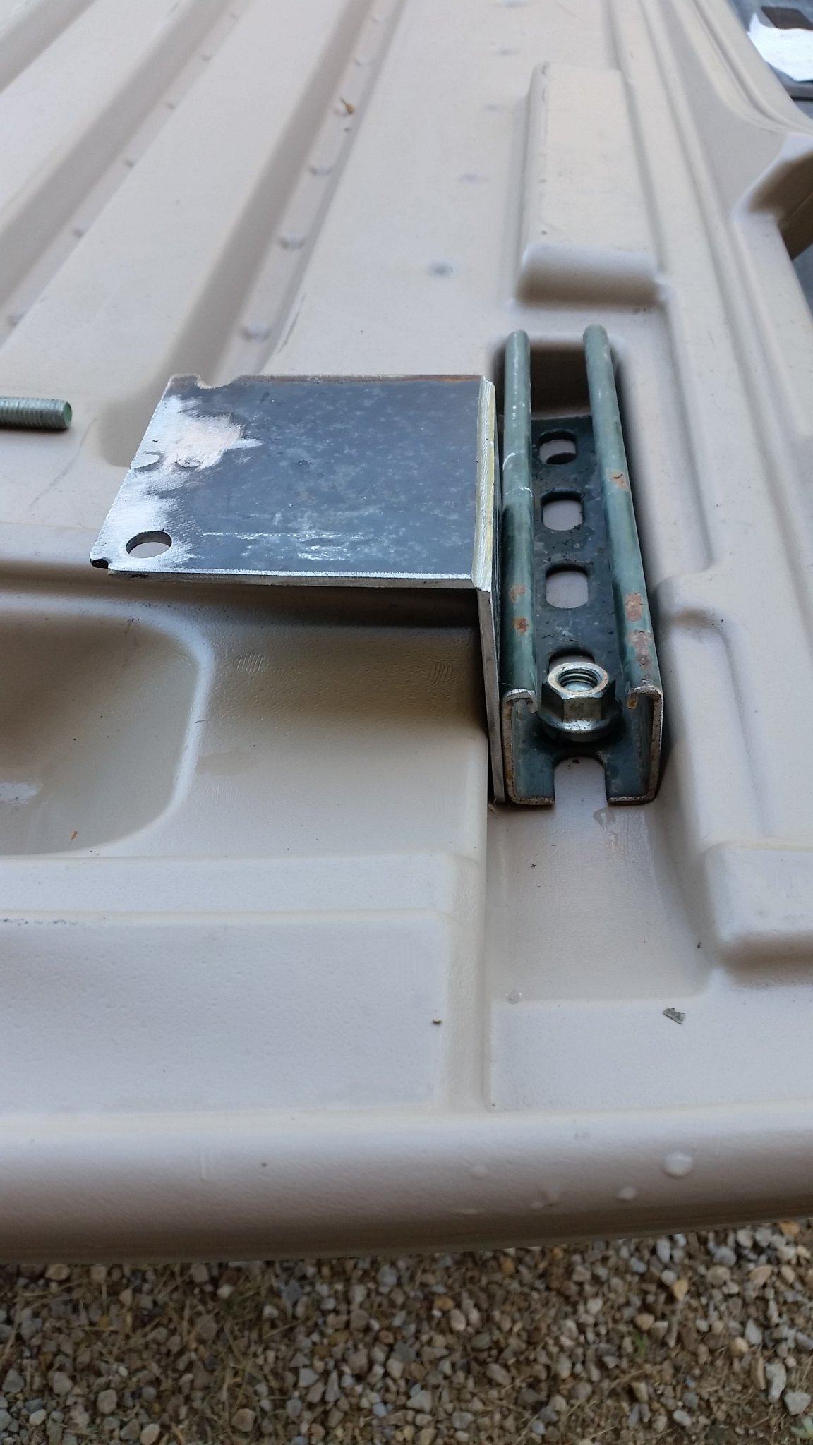

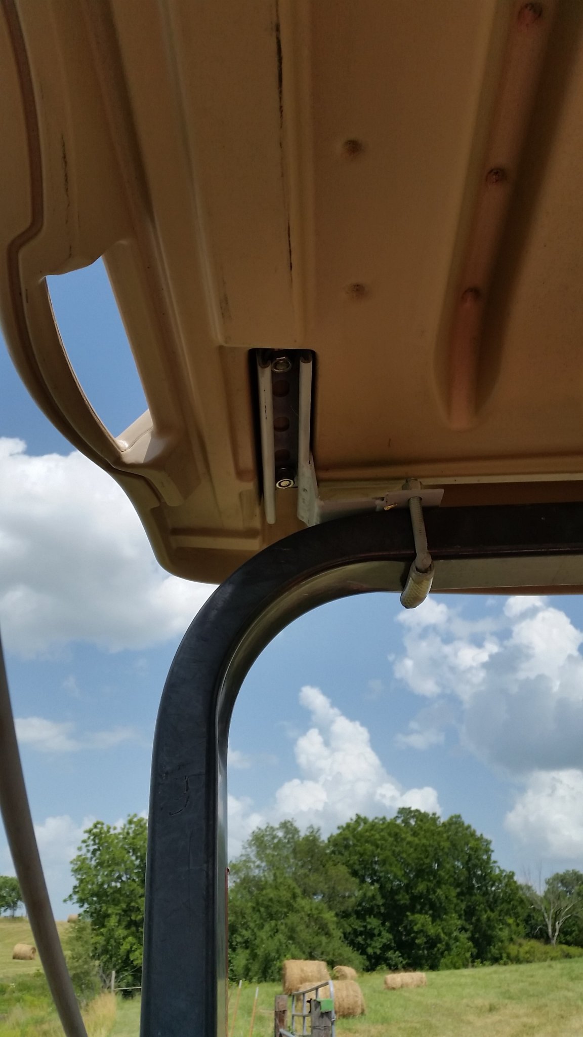

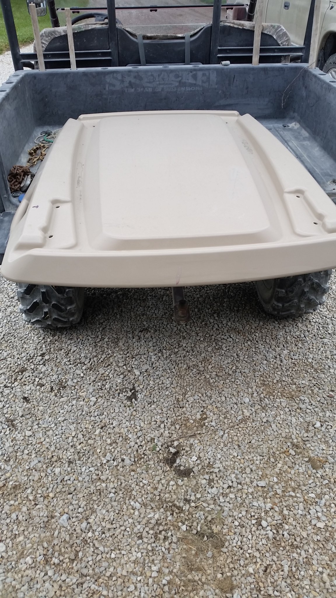

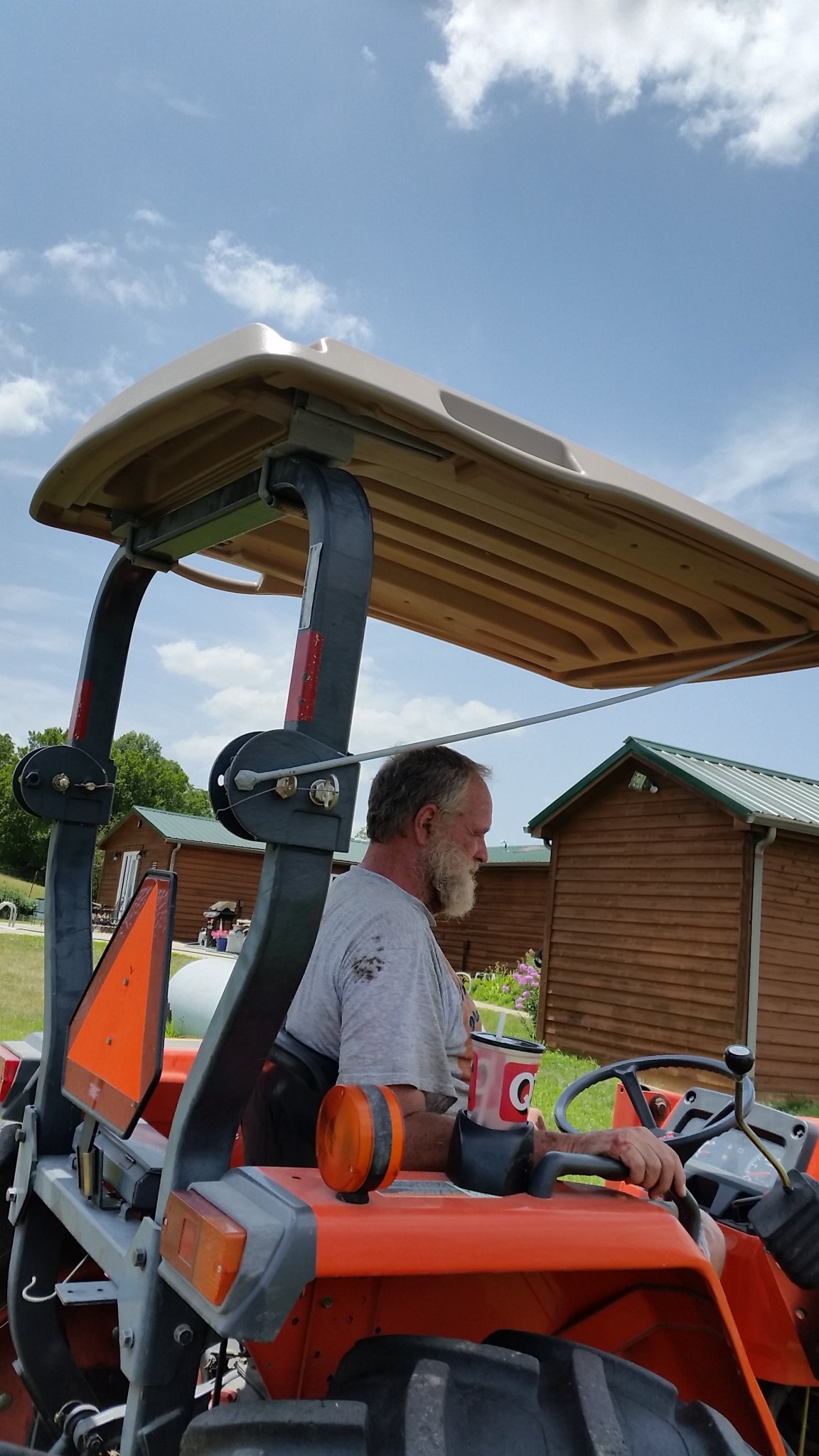

If you have a supplier of golf carts nearby, they have tops they replace with custom parts. I got this top for $25. The mount is whatever you have available and your fab skills.
View attachment 45132 View attachment 45133 View attachment 45134 View attachment 45135 View attachment 45136 View attachment 45137
I like this idea. Practical and inexpensive. Not sure I can obtain a golf-cart canopy in my area, but worthwhile looking into. Could be an eBay search or Gumtree maybe. I'll also check out wrecking yards / bone yards of other machinery like mini excavators to see what they have available.

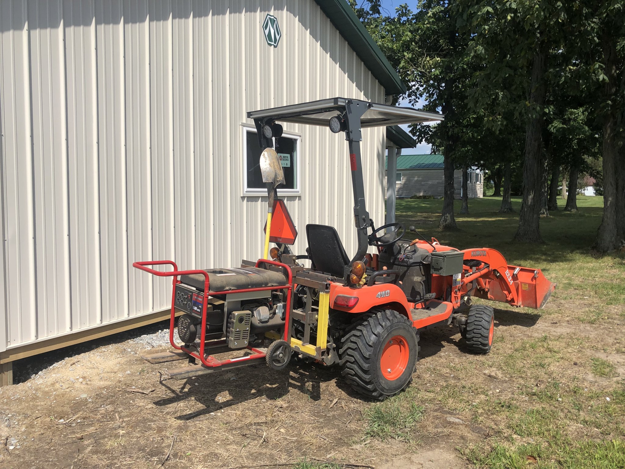

I have another canopy I made for my L4240. I leave the ROPS folded down because I'm on flat ground and in trees. This canopy is made from scrap pieces of a large umbrella. Alum pieces about 1"x 1/2" tubing and were 5' long, or so. I made the frame so it mounts into the folded ROPS. Put canvas on the top and held there with plastic ties. Took an hour, but keeps me out of the sun, and come off when I'm done. I might have a picture.

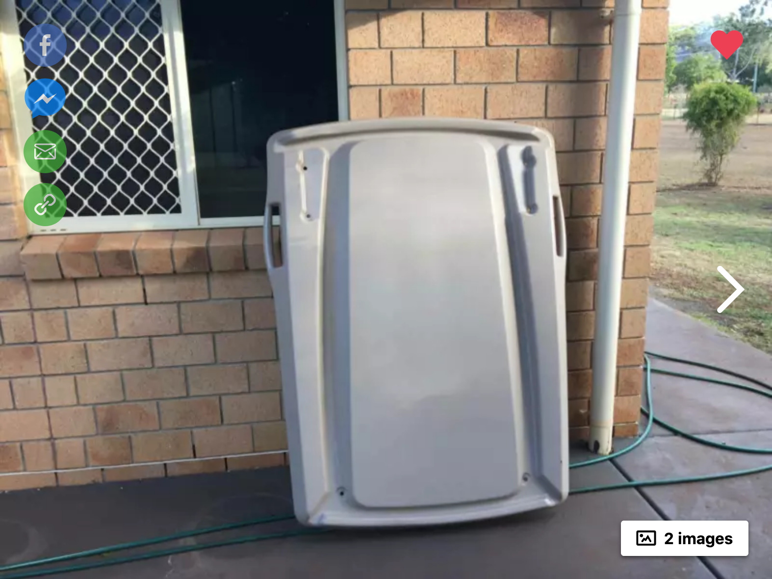

Decided to browse through Gumtree listings looking for a GC canopy and came across this. Seller is based on the other side of the country and says 'pick up only' but I've asked if they would be willing to ship to me (I pay for shipping obviously). Looks identical to your canopy NHSleddog and at $120 plus shipping, it fits my budget. Fingers crossed this pans-out.
Screenshot_2020-06-29 EZGO golf cart roof Golf Gumtree Australia Toowoomba City - Toowoomba 12...jpg
13,023
4,393
If you look at the first picture I posted with the piece laying in the back of the Ranger, it's identical. They are a standard golf cart top.
