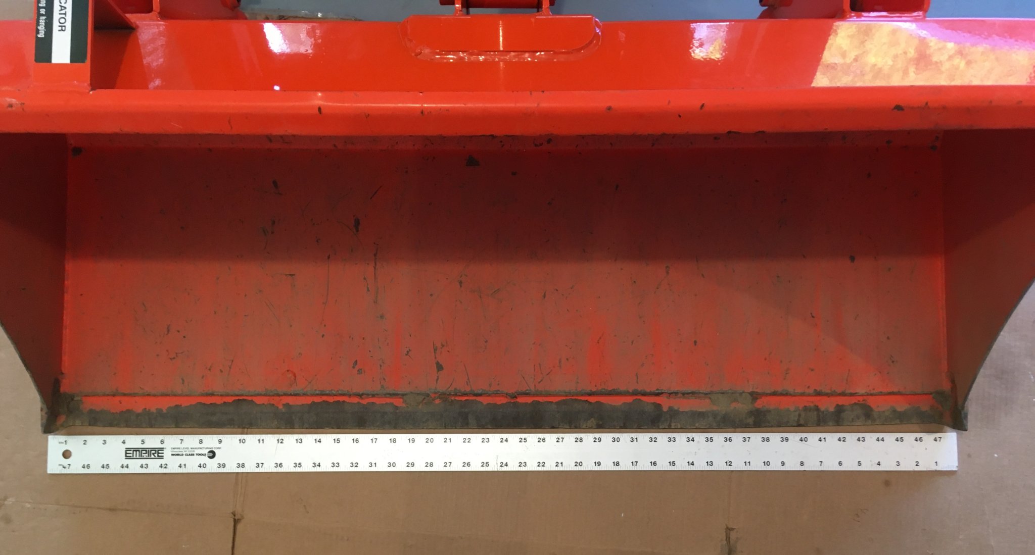

Just purchased a one-owner BX24D with 200 hours. Seems to be in great shape.

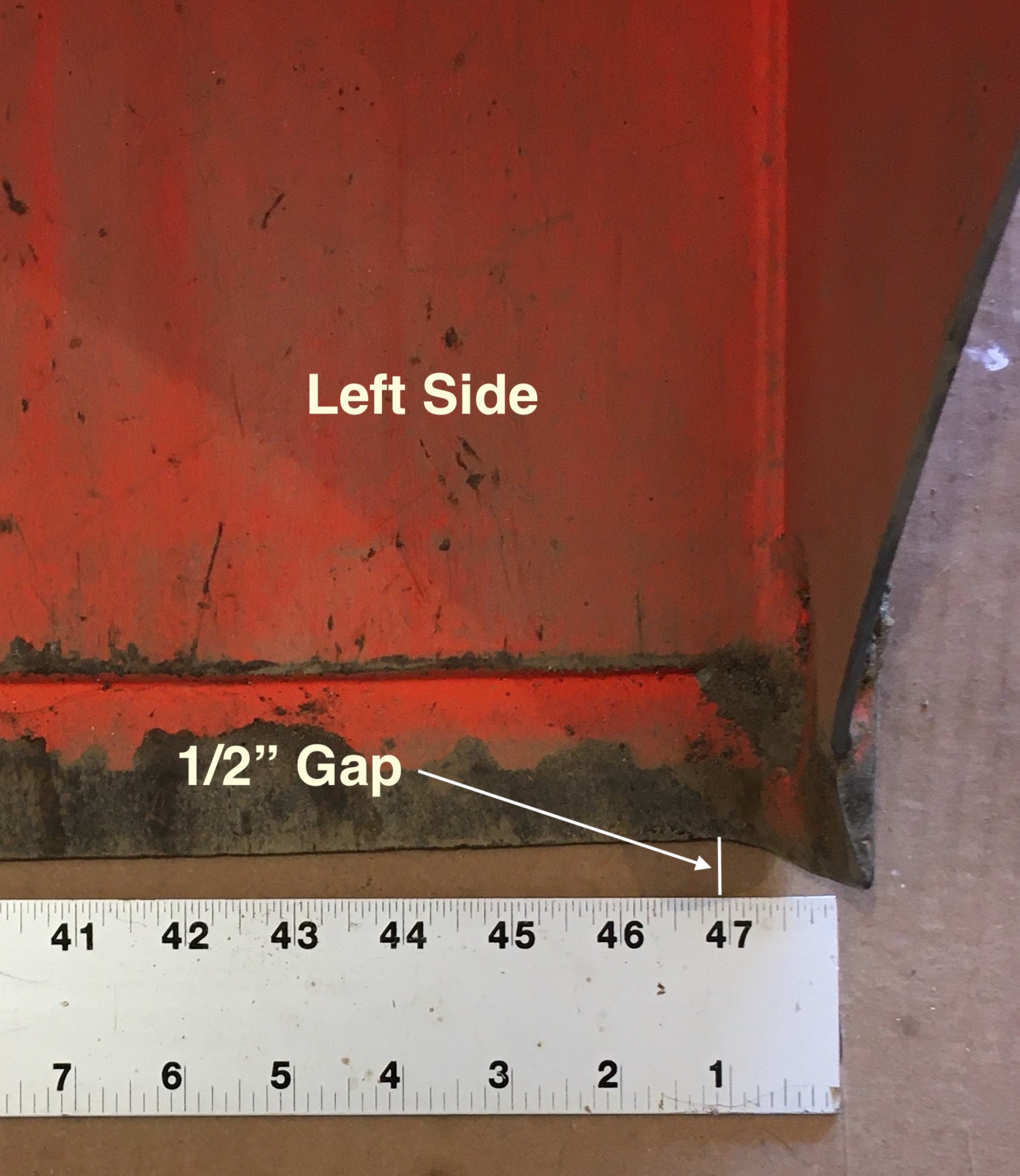

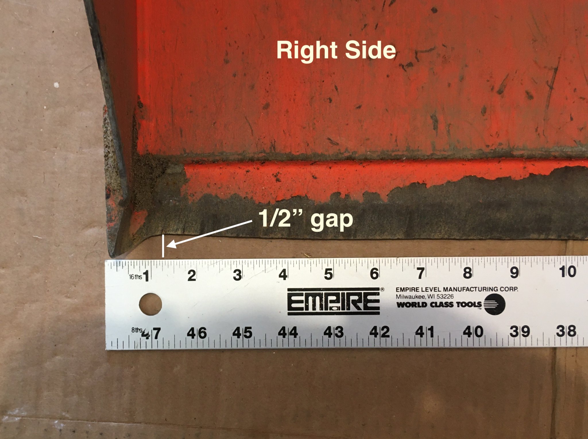

The photos show the current state of the bucket's original cutting edge. I assume that when it was new that the edge was perfectly straight?
As shown in the photos it looks like the center of the cutting edge is worn back 1/2" and both the right and left sides of the cutting edge are worn back 1/4". Is my understanding correct?
In any event, is there anything about the shape and amount of wear of the original cutting edge that might preclude properly attaching a new bolt-on cutting edge?

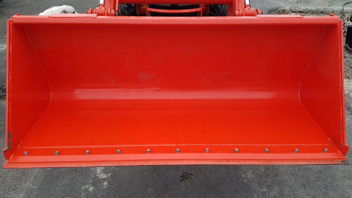

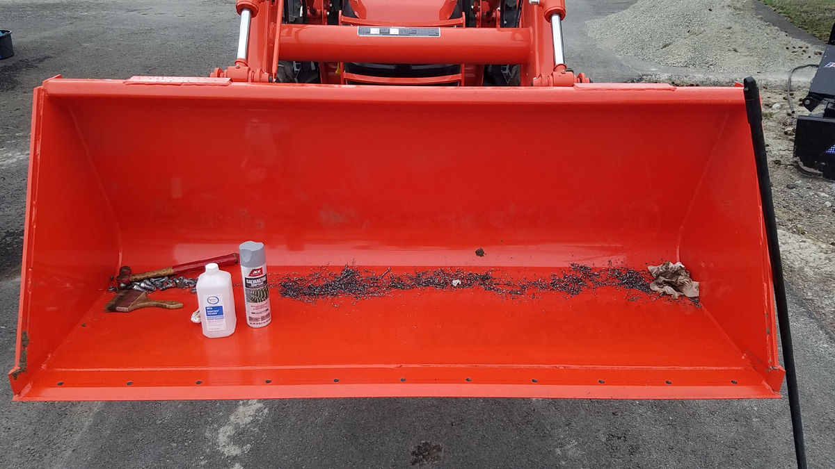

You shouldn't have any problem drilling and bolting on a cutting edge given the location of the bolt holes. I drilled out the bucket that came with the M6060 to accept the factory cutting edge that came with the MX6000. The MX6000 got an Everything Attachements Wicked Tooth Bar (shown below).
Here are the holes I added to the M6060 bucket to work with the factory cutting edge.

Great. Now I have to ask: how did you manage to drill all those holes perfectly aligned / positioned? Did you use any sort of jig and perhaps a drill press too?

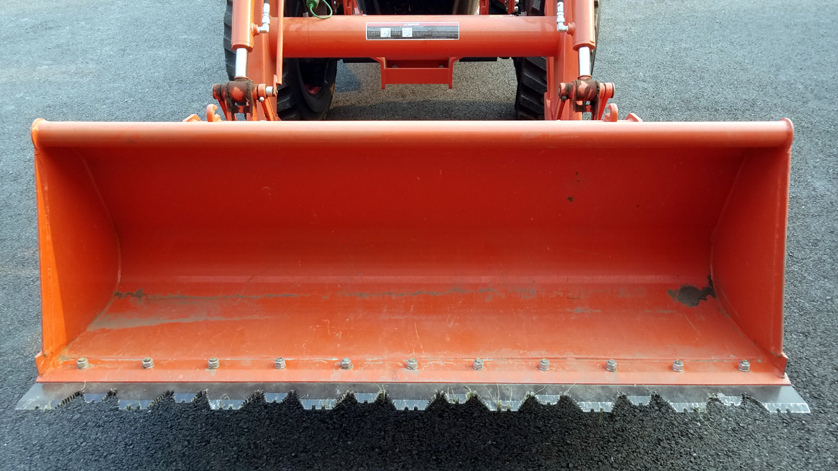

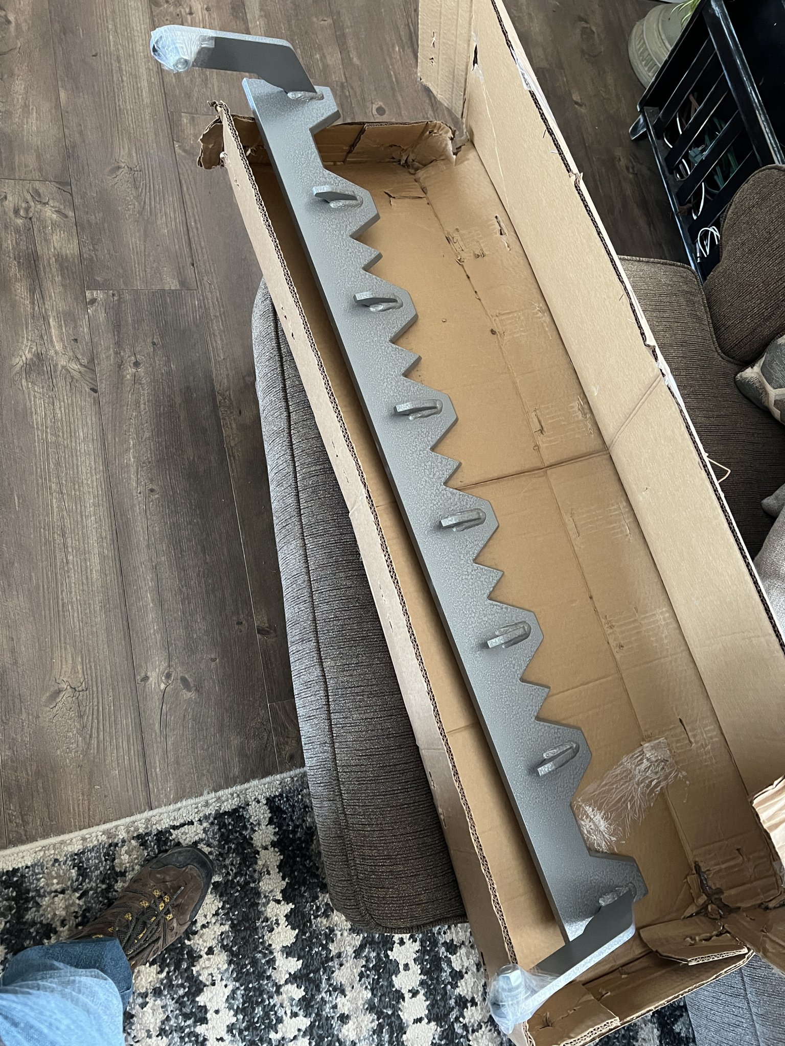

I bought a piranha bar for my BX23S from bxexpanded. It works very good and is very easy to install. Just drill two holes and bolt it on.

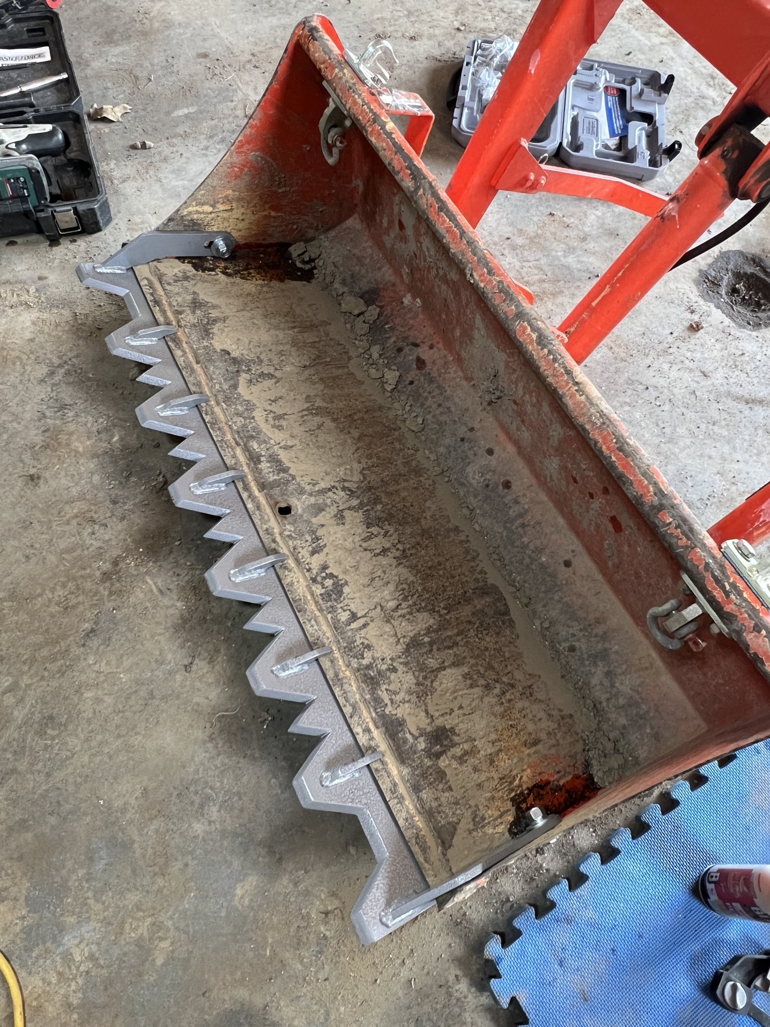

Agree with rec for Piranha bar (come in toothed or straight edge configuration) from Bxpanded. I have one of each, Easy to install by drilling 2 holes, one on each side of bucket. Solid construction, prompt shipment. Good luck.

I too agree - the piranha toothbar is a perfect solution, it will protect your old edge and will allow you to dig at 3 times faster than the old edge. Matter fact, you probably will NOT ever take it off.

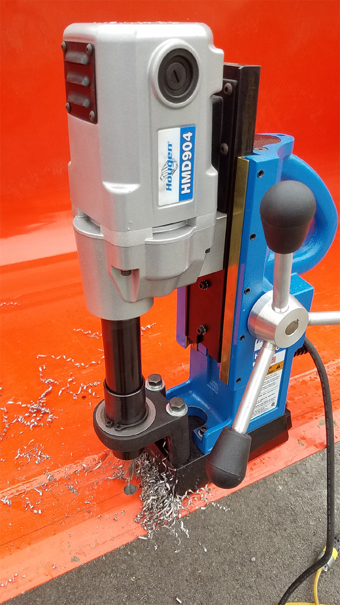

How does the expression go ..... "measure twice, cut once". I was careful to lay out the holes with the proper spacing, but a mag drill really helps to make this type of project go well. The plate is thick, and most will struggle to keep a drill bit perpendicular to the work surface so errors stack up. I have a Hougen mag drill which is great for these kind of projects and a tool I should have bought decades ago.
As always people here will recommend a Piranha tooth bar but I prefer the look and functionality of a factory type installation with a fully bolted on cutting edge. BXpanded offers a "pro" tooth bar that is fully bolted. Since I already had 11 holes in the MX bucket it was a no brainer to order the EA Wicked Tooth Bar, and since I had a virtually new factory bolt on cutting edge from the MX, it made sense for me to drill holes.
Post some photos when you're done regardless of which type you choose. I still think a bolt on edge would be a better solution for you given the state of the current cutting edge. I would clean up the edge so that it's square and bolt on either an EA or BXpanded product. A bolted on edge will provide more support to the underside of the bucket too if that's important to you.

Those holes you did do look like they were done with a press of some sort. Since I do not do much if any steel fabrication, I will not be able to justify the price of a mag drill at this point (didn't know about 'em until your post).
Since it's impossible to use a new edge as a jig or guide to drill holes because it's longer than the approximate 47 1/2" inside width of the bucket (assuming drilling is to be done from the inside of the bucket), what I think I'll do is to use the new bolt-on edge as a template/gig to make a gig/guide out of some 47 1/2" long angle iron or steel plate that I have on hand. I'll elevate the new edge about 1/2" off the surface of the angle iron / steel plate using a good quality wood strip spacer and also use a clamp-on drill guide to ensure drill bit is kept perpendicular to surface. I'll start in the center and work my way to edges bolting down the jig as I go along. I think that will do the trick -- what do you think?

The issue will not be the variation in the leading edge but the wear from the front edge to the rear bottom surface of the existing cutting edge. If it is worn uneven and has some curvature you will likely never keep the edge tight on the base edge.

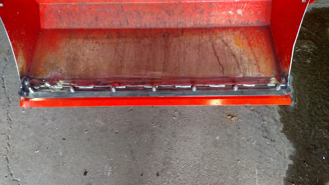

When I bought my BX, the cutting edge was pretty well worn, so I bought a new one and a bolt on cutting edge too. I drilled holes in the new weld-on cutting edge to match those in the bolt-on edge, had the new weld-on edge installed and bolted up the other one. Had worked perfectly for a couple of years.

I went with a Piranha Tooth bar. Less work to install and works better than the factory one.
