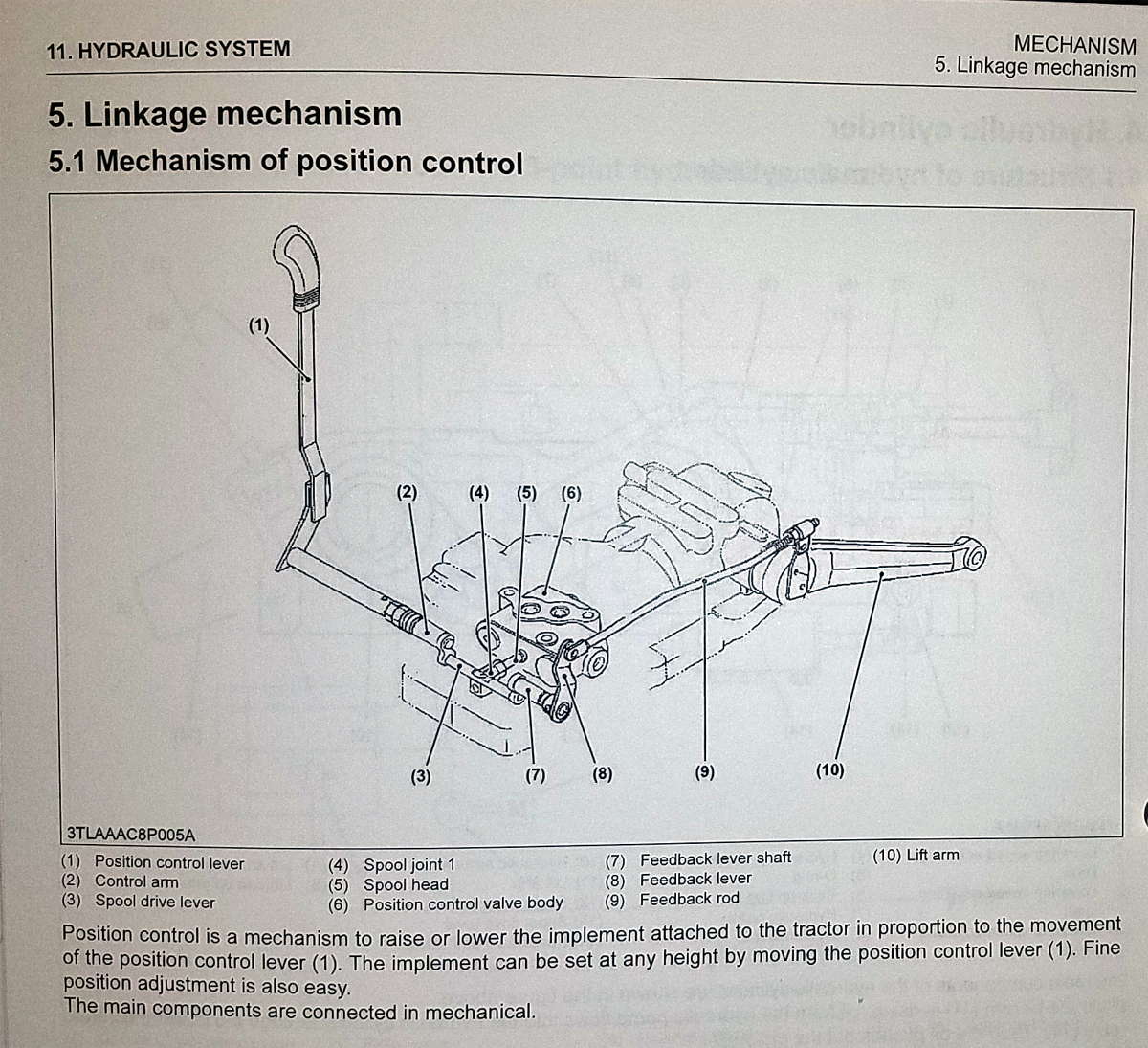

All tractors have a feedback link to trigger a stop to hydraulic flow to the 3 pt lift cylinder.
Usually you will see a small diameter rod attached to one of the upper lift arms.
Here's the feedback rod shown on my MX6000 (see red arrow).

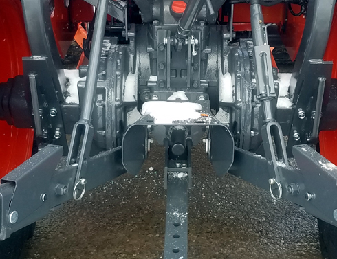

Yes, it does have two holes for the lift arms(vertical arms). It does not appear mx6000 come with multi hole hitch arms(horizontal). It was one of the first things I really noticed different about the l6060, mx6000, and larger compacts vs the smaller ones. Look at the l3560 hitch arms, they have multiple lift arm to hitch arm positions. This will greatly vary the geometry and lift force.
l3560 multiple hitch arm positions. View attachment 73148
mx6000(one hole selection for hitch arm View attachment 73149
I do know that moving the vertical adjustment on the lift arms to the lower hole and moving the top link to the middle hole provides plenty of additional lift. No other adjustments needed.
