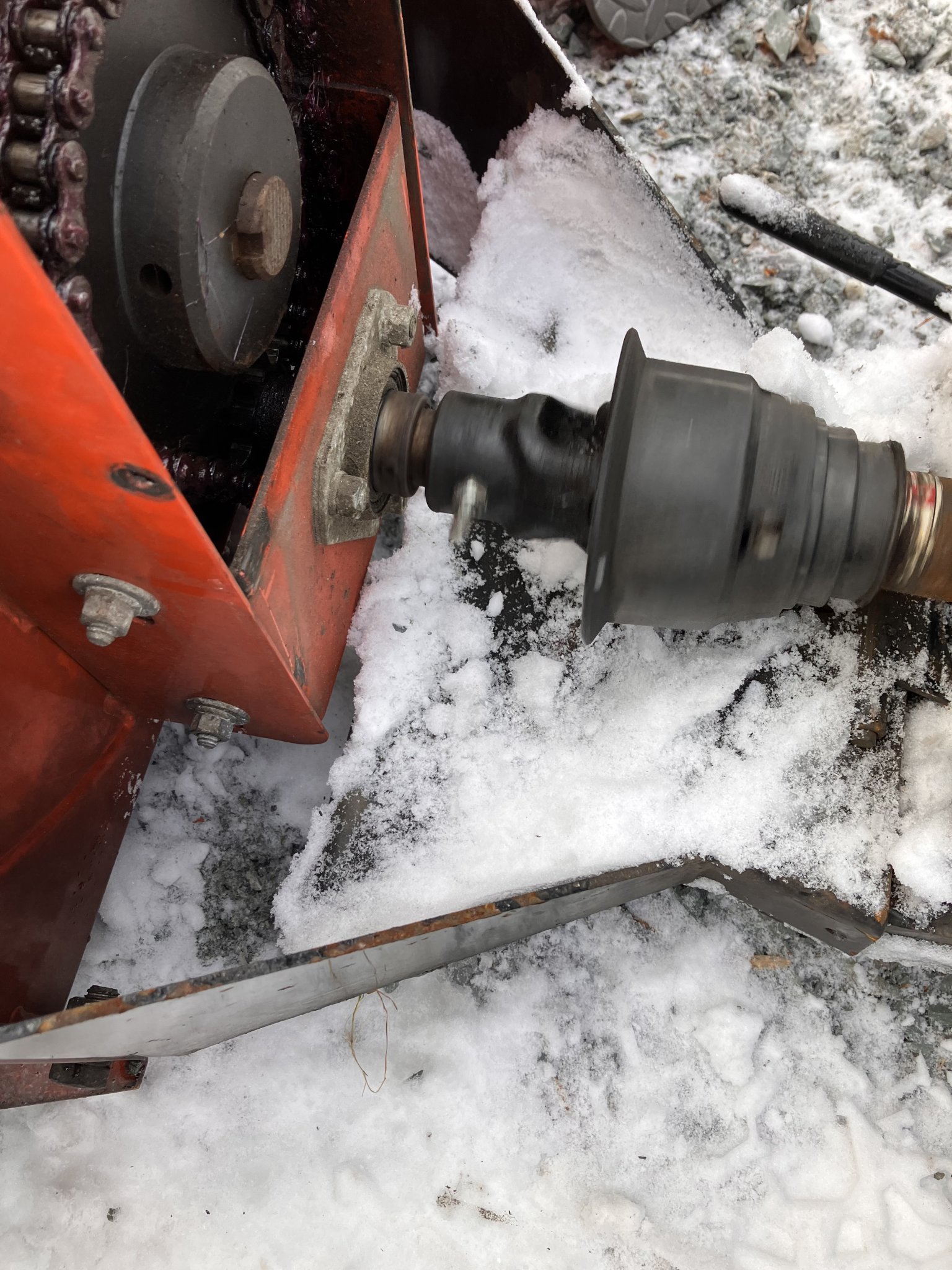

The shaft going into the reduction box spins but the chain doesn't move. I cannot find anything in the schematics I've looked at to see a shear in or woodruff key. I don't want to take it apart without having the piece to fix it on hand. Any ideas? Have you seen this problem before?

Is your driveshaft is turning, but the chain isn't moving, then most likely the allen set screws have come loose and the key has come out of the keyway. Don't be afraid to take it apart first to see what parts you will need, because most likely they will be standard hardware items. You will need the parts breakdown for the repair, and take lots of pictures as you take it apart. They are not that complicated to work on. BX2750 Snowblower Parts Diagram You can print the PDF and I suggest that you do that. Without knowing your mechanical ability it is difficult to give you a lot of guidance. If you need additional help, post here. If you get into needing more help, I can talk you through it by phone. I will send you a "conversation" with my number. Look for the little envelope in the top right corner of the screen and click on it.

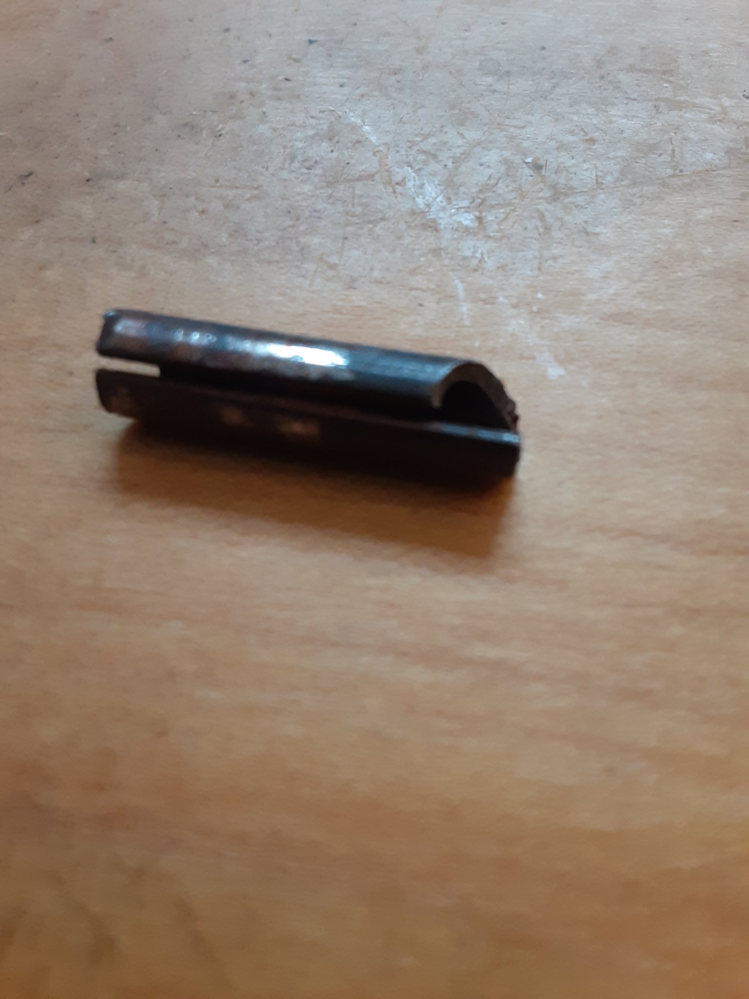

Thanks for the help! I hope to take it apart tomorrow to see what is going on. If the shaft is broken (#2 in photo) are the bearings pressed in or will the shaft just slide in and out. Pressed in bearings means a trip to the Kubota dealership.
Thanks again!

No, they should not be pressed bearings.
10,019
4,115
Looking at the diagram, providing there's no burrs on the shaft, removing bolt,washer,nut(5,6,7) releases bearing (3)and bearing retainers (4). Shaft(2) should come out of the housing.

The solution? A broken pin where all the different schematics for a BX2750 do not show a pin! Thank you everyone for helping me with this. (A warm garage may have speeded up the diagnostic process...)
You might say that the "roll pin" aged out. I used to have a source for stainless steel roll pins, but as with a lot of US-based suppliers, they went out of business because of the "inexpensive" (cheap) imports. I am glad that I still have a good supply of the standard spring steel roll pins (American-made) that we used to use in the large truck equipment business that I was involved in about 40 years ago. Don't know if you know this, however, there are special punches specifically designed for driving them out and installing them.

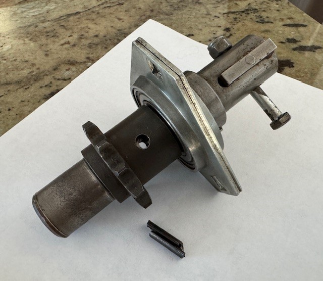

Mine had a rollpin in it also. I think the pin is factory. I also couldn't find it online and the replacement shaft and sprocket are a welded unit. So, like you I'll probably just stick a bolt through.
I took mine apart this afternoon. Also a roll pin. This whole thread is helpful confirmation! Now I gotta go get the punches to get it out, it seems really jammed in there. Will probs replace it with a bolt and locking nut.
