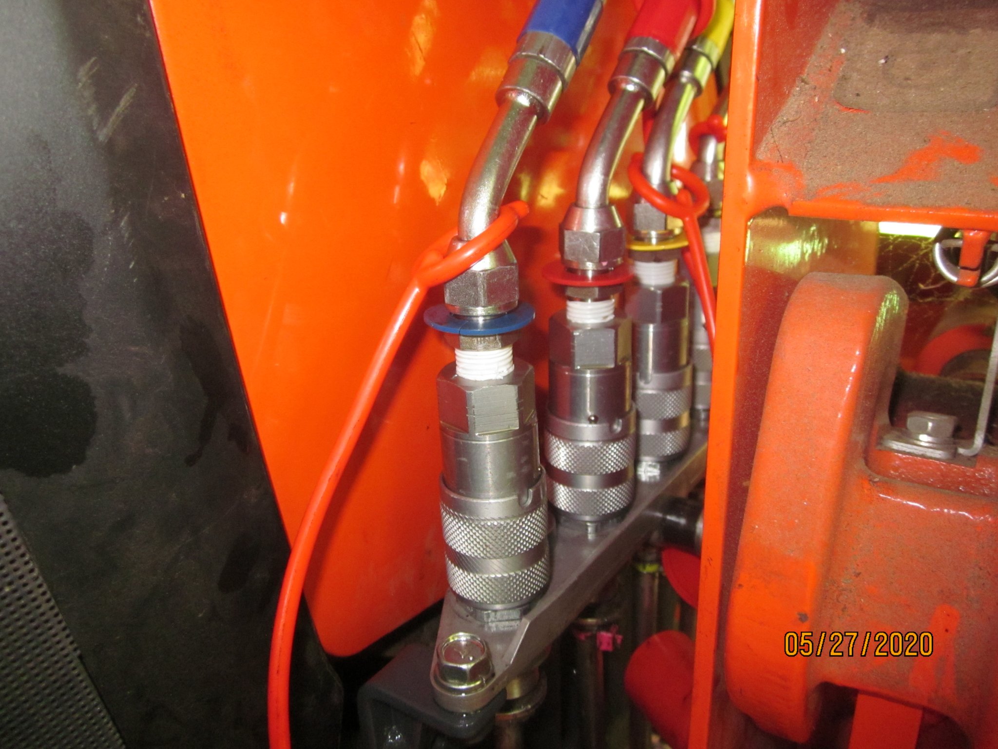

Had the same problem with my BX2380. Repaired under warranty and shortly after began leaking again. I always cleaned the couplers very well before hooking up the FEL and always used the caps when it wasn't hooked up. Replaced the upper (loader side) coupler with 4, 1/4 NPT female flush face couplers from Summit hydraulics. Also required 4, 3/8 JIC to 1/4 NPT adapters. Hasn't leaked a drop since. I guess time will tell if I made the right move, but I'm happy with it so far.
I had the same problem with my BX2380. I found the female couplers and the adapters at amazon using the description provided. Here are the links to the items I purchased:
