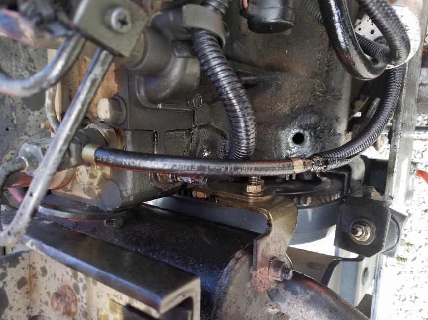

F FatMike New member Jul 29, 2018 7 0 0 St.Mary's, ohio, Oct 21, 2018 #1 Missing some sort of plug here. Thank you! attached a photo. I'm very new to this machine. Attachments 15401454762614660259459882923589.jpg 95.7 KB Views: 109

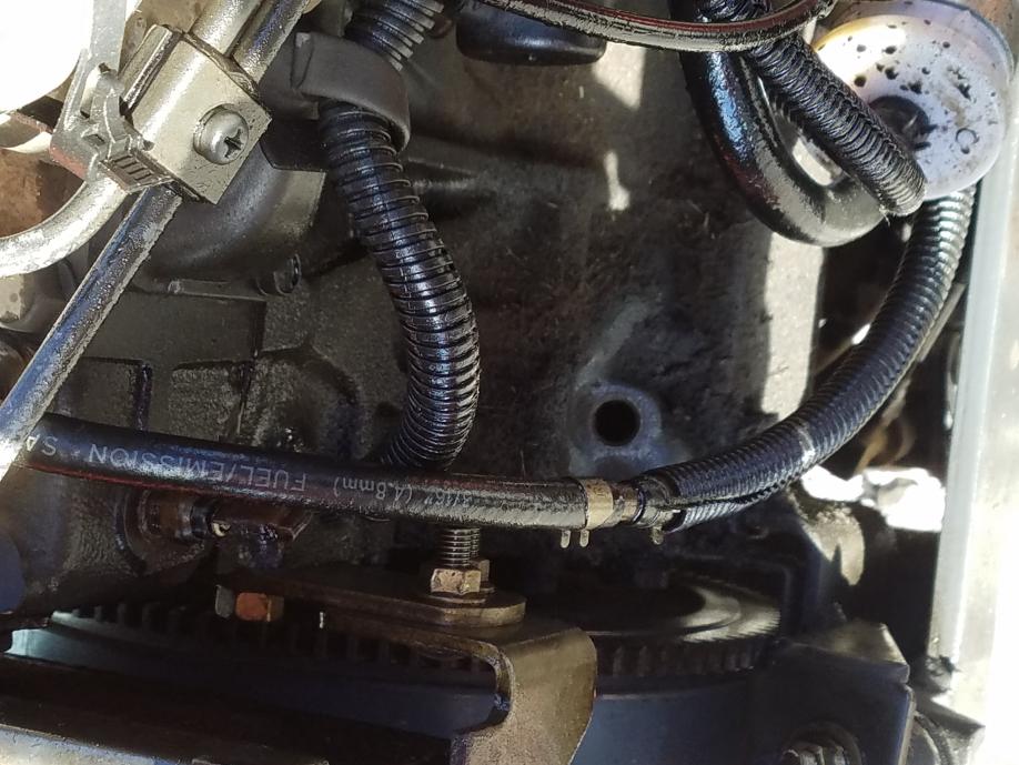

F FatMike New member Jul 29, 2018 7 0 0 St.Mary's, ohio, Oct 21, 2018 #2 another pic Attachments 20181021_151033.jpg 94.1 KB Views: 100
North Idaho Wolfman Moderator Staff member Lifetime Member Equipment L3450DT-GST, Woods FEL, B7100 HSD, FEL, 60" SB, 743 Bobcat with V2203, and more Jun 9, 2013 28,713 5,129 113 Sandpoint, ID Oct 21, 2018 #3 It's supposed to have a rubber plug in it. Oil gauge plug. 1G513-36550 When you get a new plug and install it, if it tries to pop the plug out again or the dip stick, then the valve cover breather is not working right.
