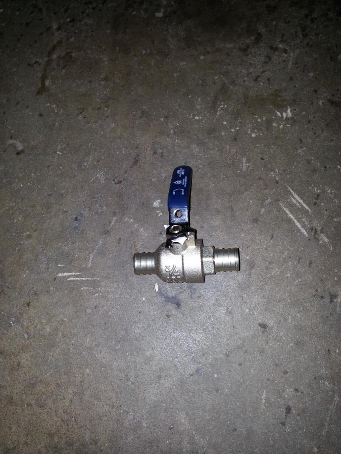

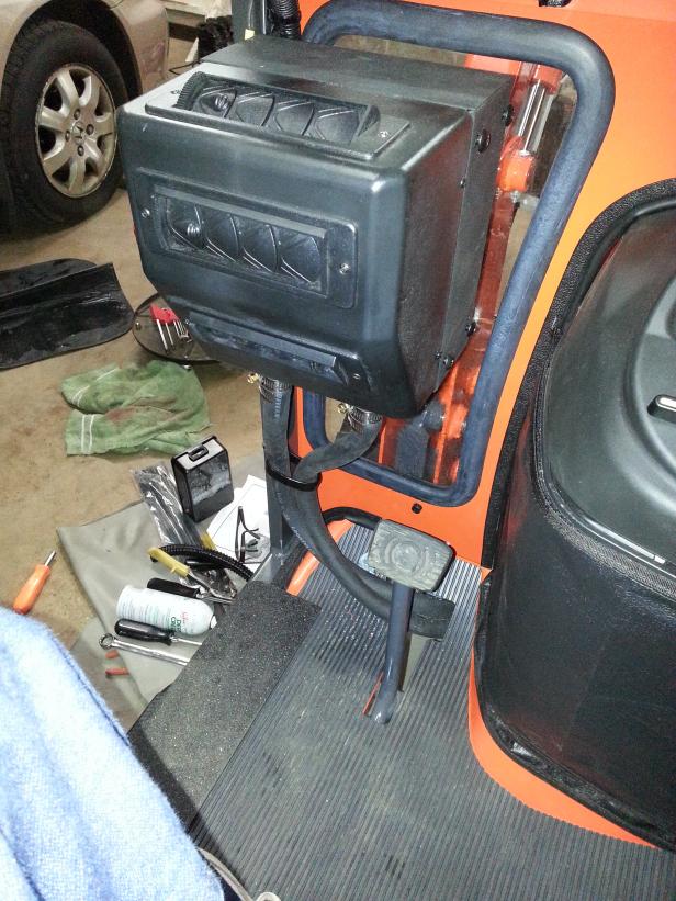

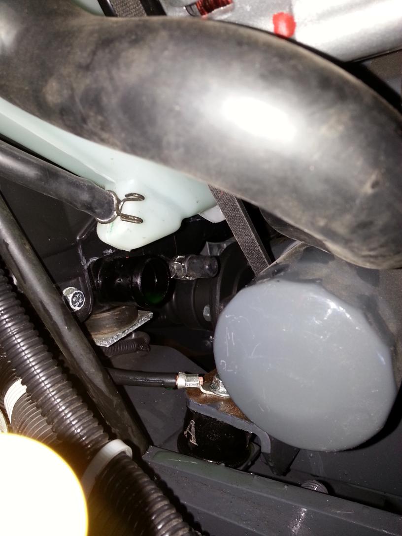

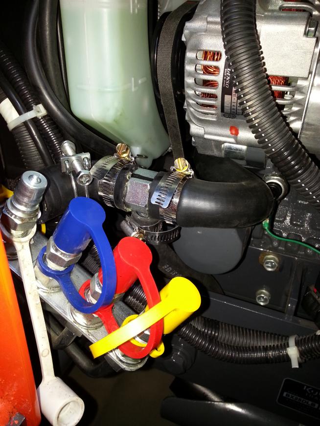

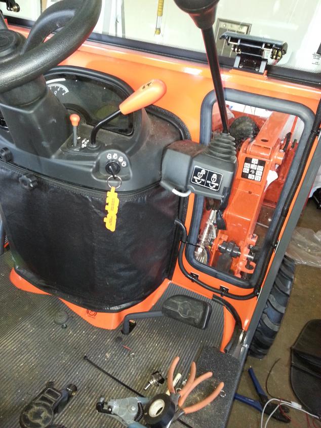

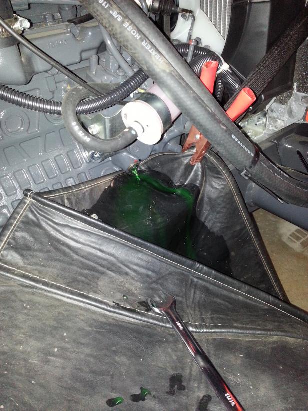

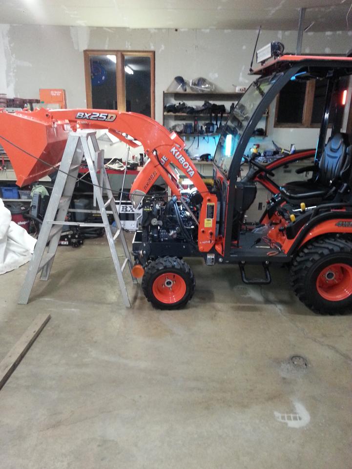

Here are pics to give you an idea how a heater installation goes
Follow the "Curtis Cab", factory instructions, which are very good to get this job done. All parts purchased from "Curtis Cab".
1 removed the cowl from the front ( you could just remove the loader first)
2 drain the coolant from bolt on engine left side and radiator plug (very hard to get to , plus factory had clip turned the wrong way , did fix but was hard to do)

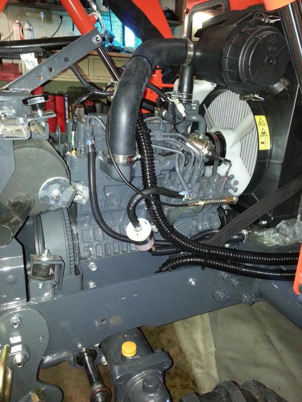

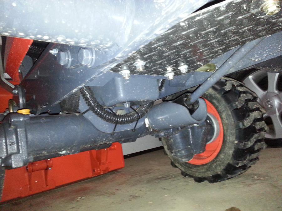

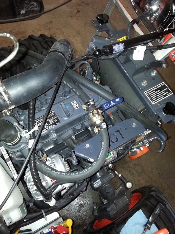

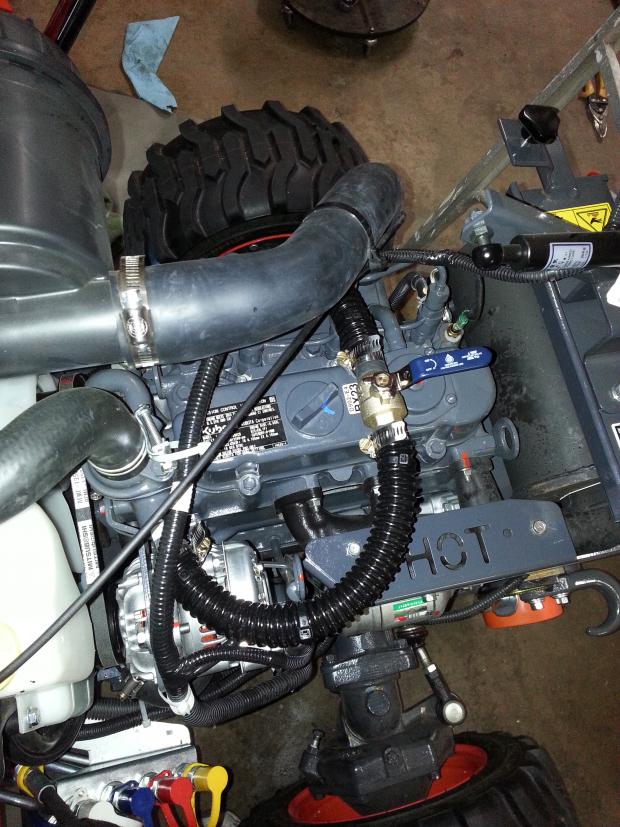

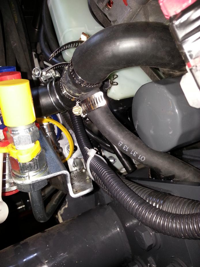

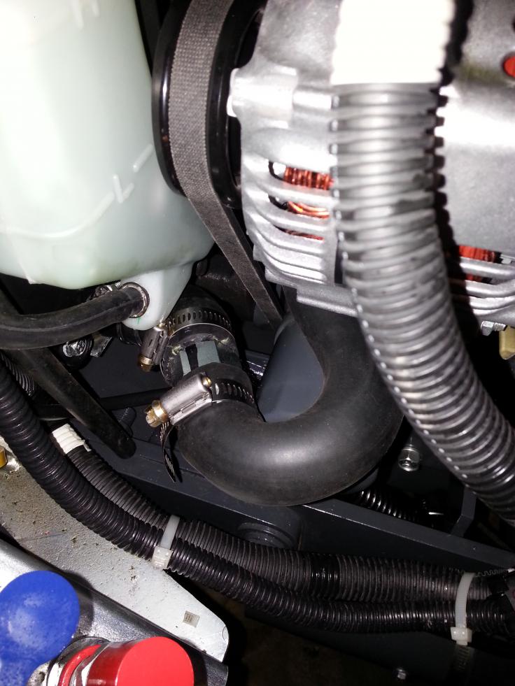

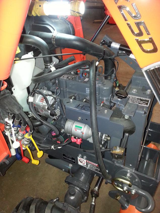

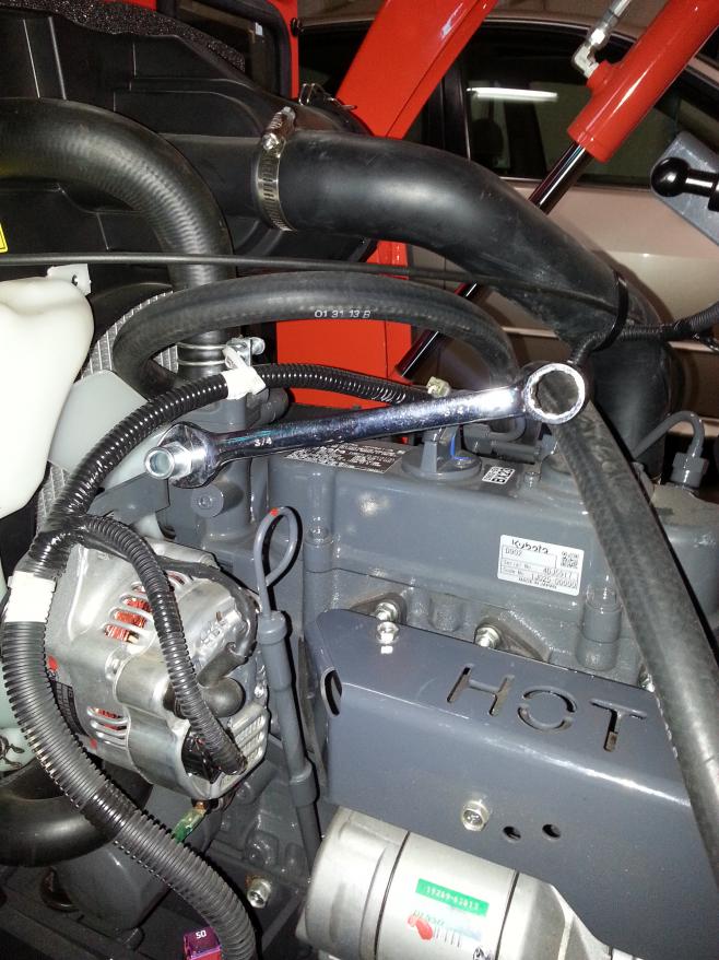

Here is how I routed my second hose
This was much easier than the factory going over the top of engine , which had to get past the oil filter.
so far no leaks , but I did put a covering over the hose to protect it.

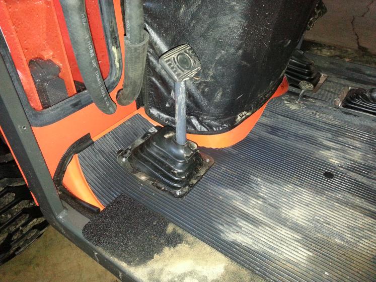

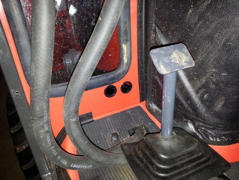

That looks much better and the boots over the pedals are a nice touch. You do nice work.
t33jetman
BX25D, TLB, 1860 bal. bucket, Curtis Hard Cab
Aug 31, 2013
212
Wooster, Ohio
alansz40,
Thank you.
Curtis Cab, gave the first location, but needed to move it to close up those holes. Will work on the hole under the seat next.
