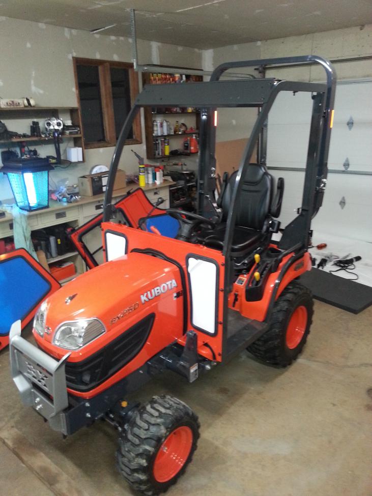

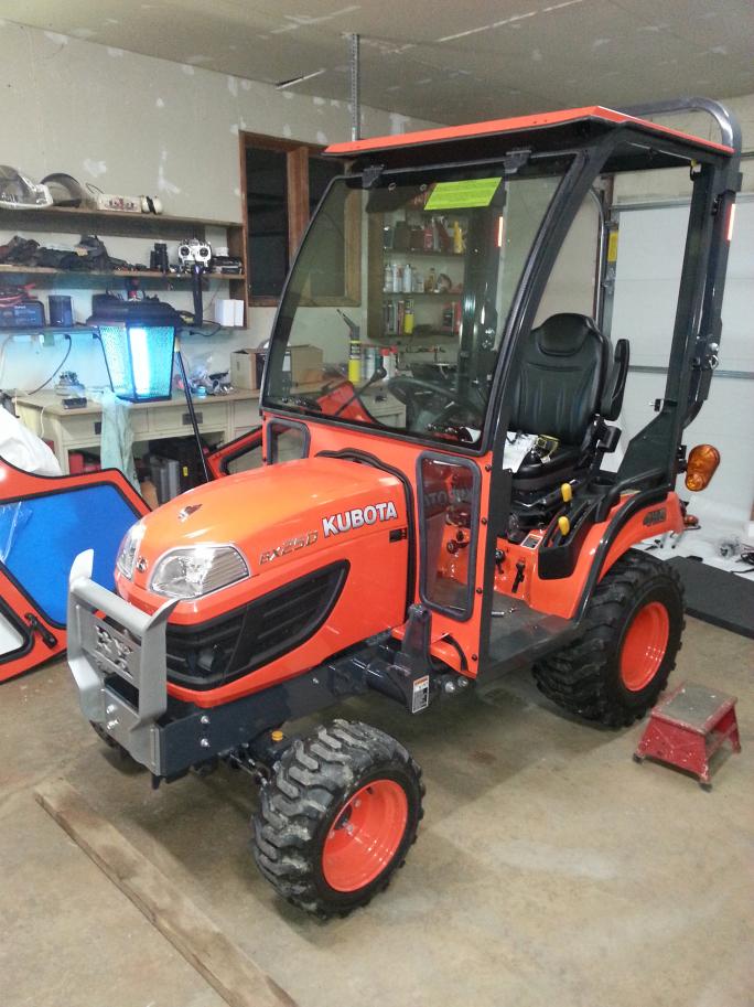

I wanted it , so I got one so I can work all year round no matter what the weather is.
So this is how you start, and the instructions that come with it are perfect , just follow them and you will have no problems.
Pictures are worth a thousand words here.

Gentleman, i feel for you.
Any tree or branch that would have been able to hit and damage my cab, is now Fire Wood in my wood burner. One day with the wife pulling me around in the wagon with my Orange chain Saw and all my problems went a way. You are in charge, so make things happen to make it work. I am just an I.T. guy and I did it so can you.

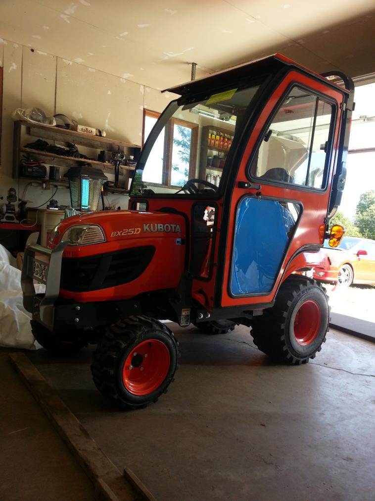

My cab clears my door my 1 1/2 inches, with the ROPS in the down posistion. If it did not clear I was going to take some air out of the rear tires to make it work. My garage is where i do all my maintenance so it had to fit for me.
I have a plow blade already that will work for the snow, but I am going to get all the attachments I want later , because that's how I roll, get what you want and don't care what other think , it's your toy.
No deep snow here, just cutting fire wood in my woods all the time (lost 25 lbs in two months so far)

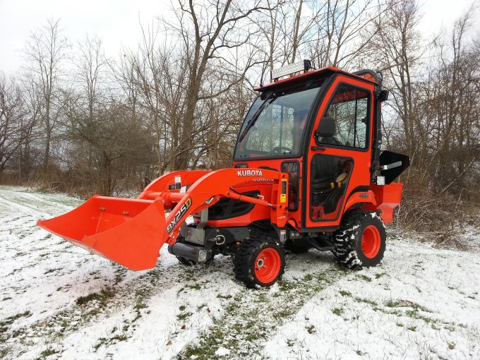

I wanted this steel cab just to go in my woods and am glad I got it , it stands the test for me. I moved my hazard lights up higher inside the ROPS so they would not get hit in the woods.
The 20,000 btu heater works great for front windshield de-frost, and keeps me warm in those late nights I work in the woods.
Because of this cab, I have something to do everyday with no excuse not to do some work out side. The John Deer guys have come to check it out, so that is a big deal out here for me being the only Kubota.

Do I Read this right the rop will still fold with the cab installed, if so what is the height of the cab thanks.
From your picks it looks like it still folds and looking at the top of the cab I would be able to fit my rop is only 2in to tall. I'll stop by Curtis plow and see what they cost if its cheaper than the dealer. Thanks

Looks great and thanks for the info just measured and I got 82ins so good to go. When you buy the cab was heater, lights , and wiper encluded in kit or they all extras. Also what's that attached under the grill guard ? I work in Worcester, Ma and that's where Curtis tractor makes some stuff and I'm stopping by this week and check them out. Thanks

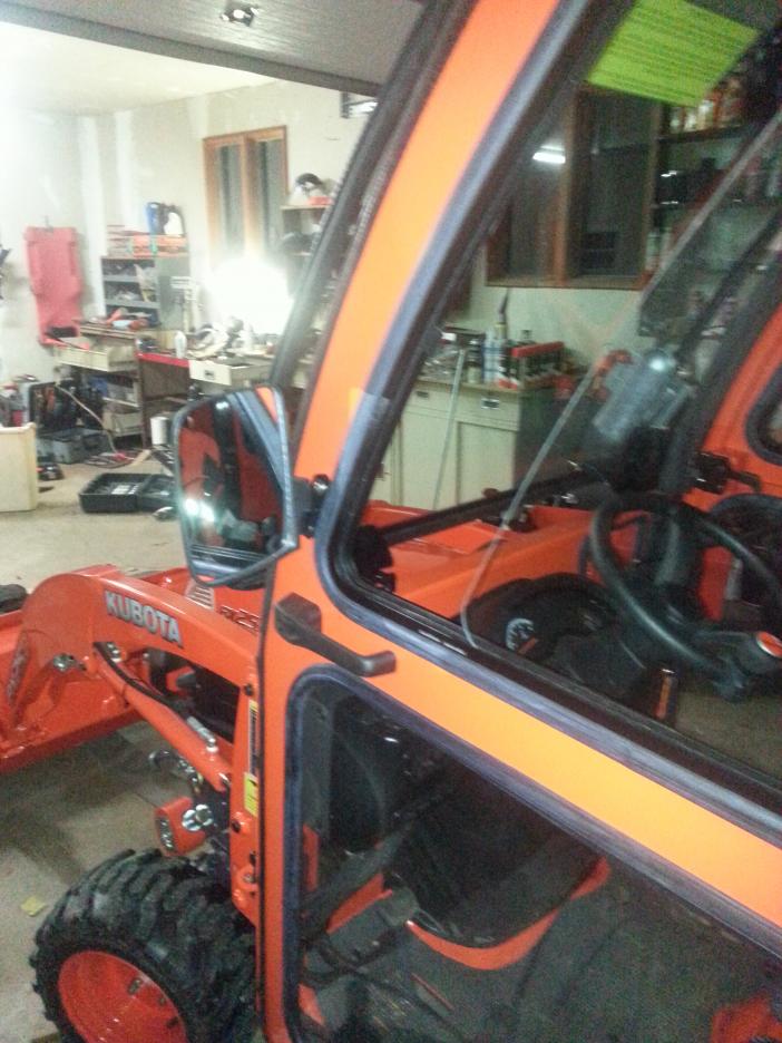

For all the guys who say it is hot in the summer:
The doors are on jeep hinges and lift off in seconds and also the back wall lifts off also in seconds after unlatching it.
Now you have three sides off but the roof and front windsheild stay on.

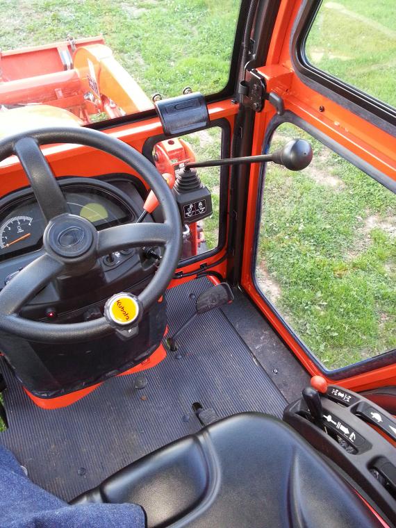

The fan in the over head console is very helpful staying cool in the heat, and the cd/radio will give you music to work by.
Yes you do need ear protection for the noise level. Unless you go ahead and put sound deadening material under the engine hood and all over the inside of the cab.

Very nice work. I have only one question. How do you use the BH with the cab on?
t33jetman
BX25D, TLB, 1860 bal. bucket, Curtis Hard Cab
Aug 31, 2013
212
Wooster, Ohio
Kubota Man,

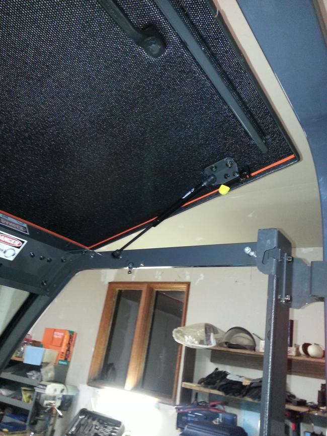

Curtis Cab , made the back wall with two handles and two latches on the inside. You just unlatch the inside, go outside in the back and lift the wall off and rotate your seat around and start using your backhoe.
One person can lift this off and put it back on with no problem. You can get an optional rear window wiper if you want one. When the roof tilts up (for taller guys) the console is still operating , so the music stays on.
Here are some pics to give the idea what is happening
Last is the Brochure that I got my idea for this tractor, that started it all.
