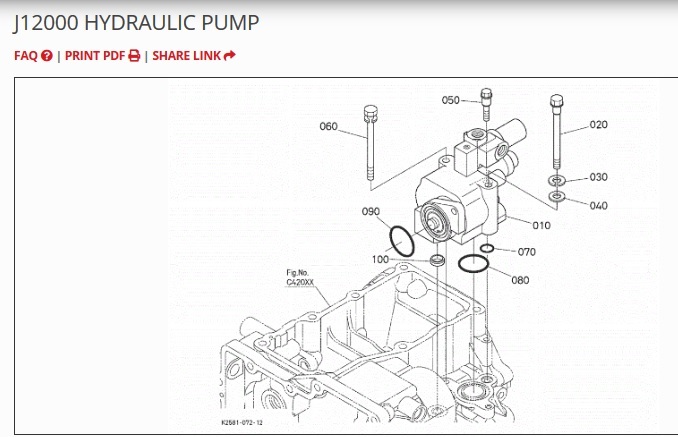

Your symptoms do not sound like a relief valve problem to me.
I just looked on the Messicks site for details on your hydraulic pump.
It is getting its oil supply by being directly connected to the transmission and utilizing O rings to create seals.
Others have suggested the pump is sucking air. If one of the O rings was not sealing well it would allow the pump to suck air.
