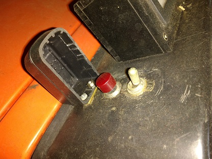

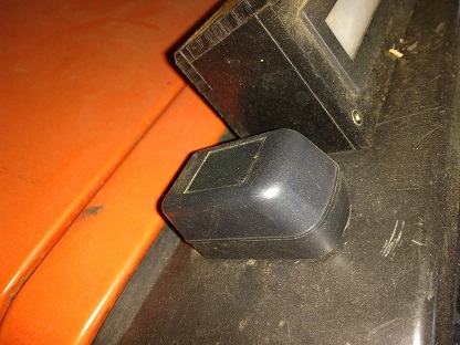

I thought about doing what you did with my BX23, but instead I installed a switch on the dash that disables all the safety switches at once. Gives more flexibility, yet retains the original safety functions. bypass1.jpg bypass2.jpg

I suspect your 'jumper' might have grounded causing the OPC 10A fuse to blow. Electrically a 'jumper' and a 'switch'(when closed) are the same .

That’s a good idea. I really like the cover and light idea for it.
Only thing I would add, is the light would be better if it were in the cover and not hidden when the cover is lowered. Just thinking about how I forget things sometimes...
Seems possible all safeties could be disabled and there would be no indication when the cover is lowered, unless maybe the cover has a window in it on the top...not apparent in the photo.

That is not a light, it is a "start the engine ignoring all safety interlocks". I must now go into hiding to avoid detection by the safety police.
So it's a toggle switch to enable to red push button switch, which when pushed then bypasses all the safety interlocks? I think I got it now...:)
Nope. Switch bypasses all safety switches. Red button will engage the starter under any circumstance , including when the engine is running. May have to rethink that feature.
