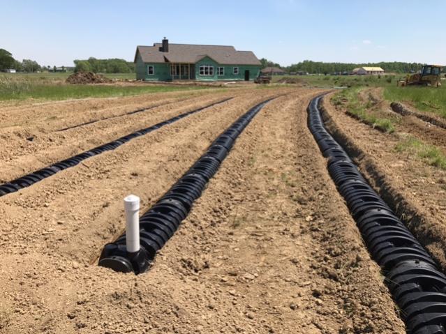

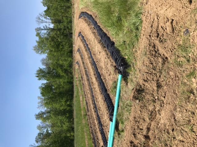

We just built last year, similar size 17+ acres, but around 8 are field. My septic leach system is a raised or mound system with the discharge tubes being housed in a plastic tunnel. No issues on driving over the leach system with my B3200. Watch out for the clean out tubes at the end of each row.

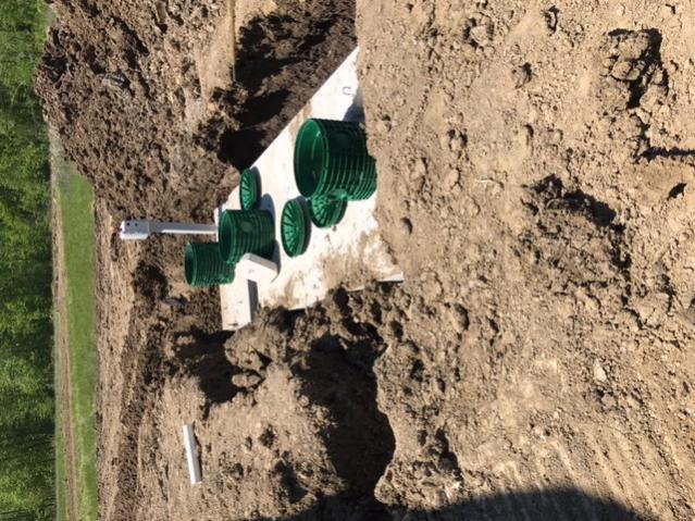

My tank is located about 20' off the house foundation and my access lids (or portals to hell as I call them) are made of green plastic that are held in place by 10 or so screws. I use a string trimmer around the access lids and my pump control box. being close to the house, I either finish mowing that area with a push or small riding mower. I don't have a finish mower for my B3200. Even though the lids to the tank are thick, I don't think they would stand up too well to a brush hog.
My bigger issue was with things settling last summer. The tanks went in when the ground was fairly wet and it settled enough to shear the outflow line to the leach field as well as almost fully pinch the line from the house to the tank. I had the installer come back out and they ended up digging out the tanks, putting in a few tons more gravel, resetting the tanks and fixing the input and output lines.
Take pictures of how stuff is located before they backfill. It is a great reference for when you have problems or are looking to do additional work around the house.
