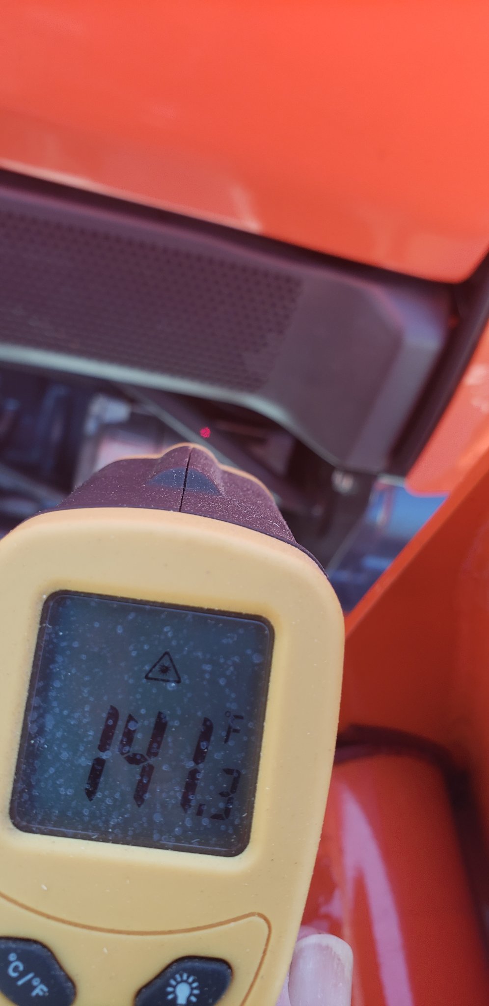

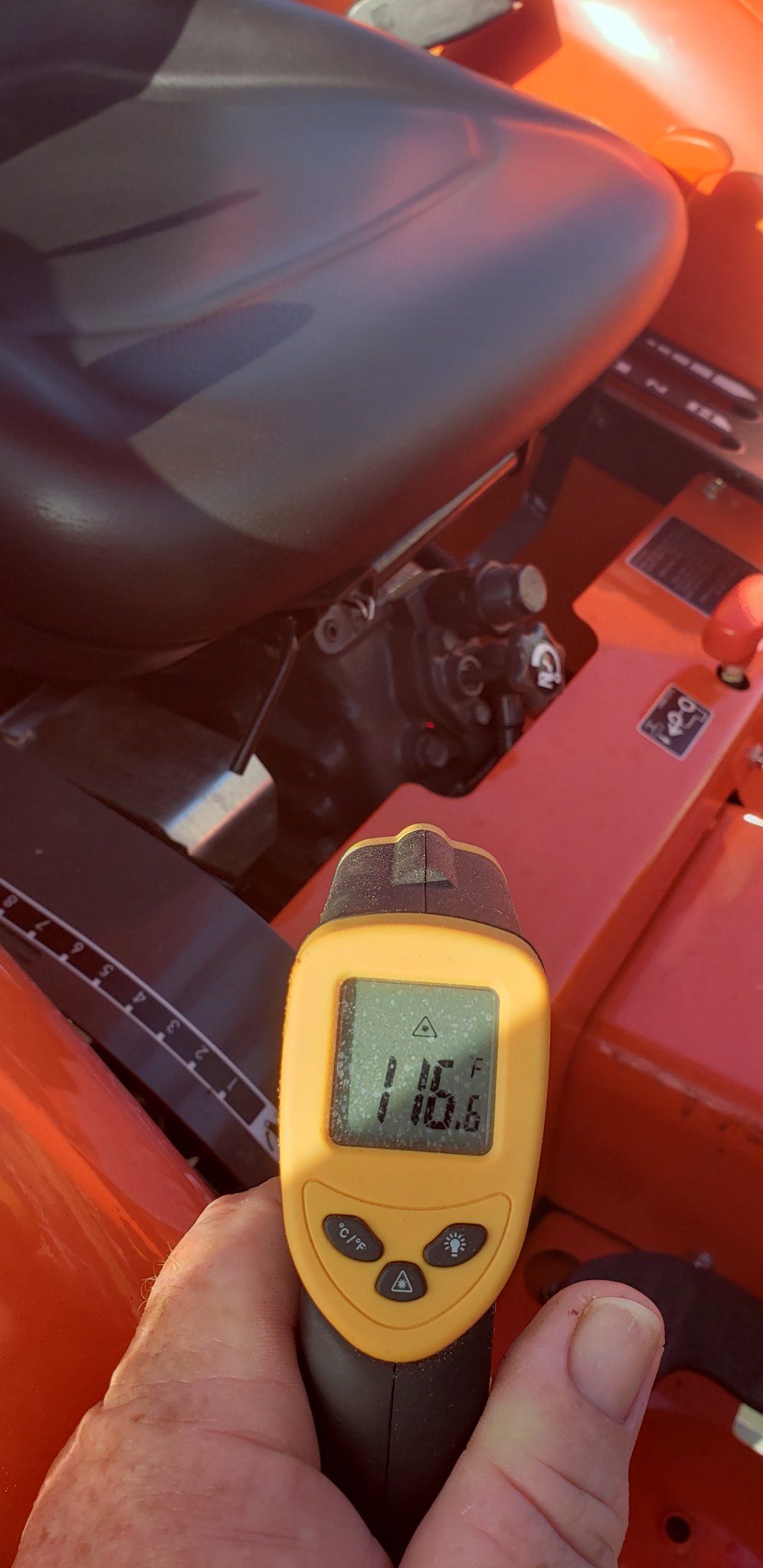

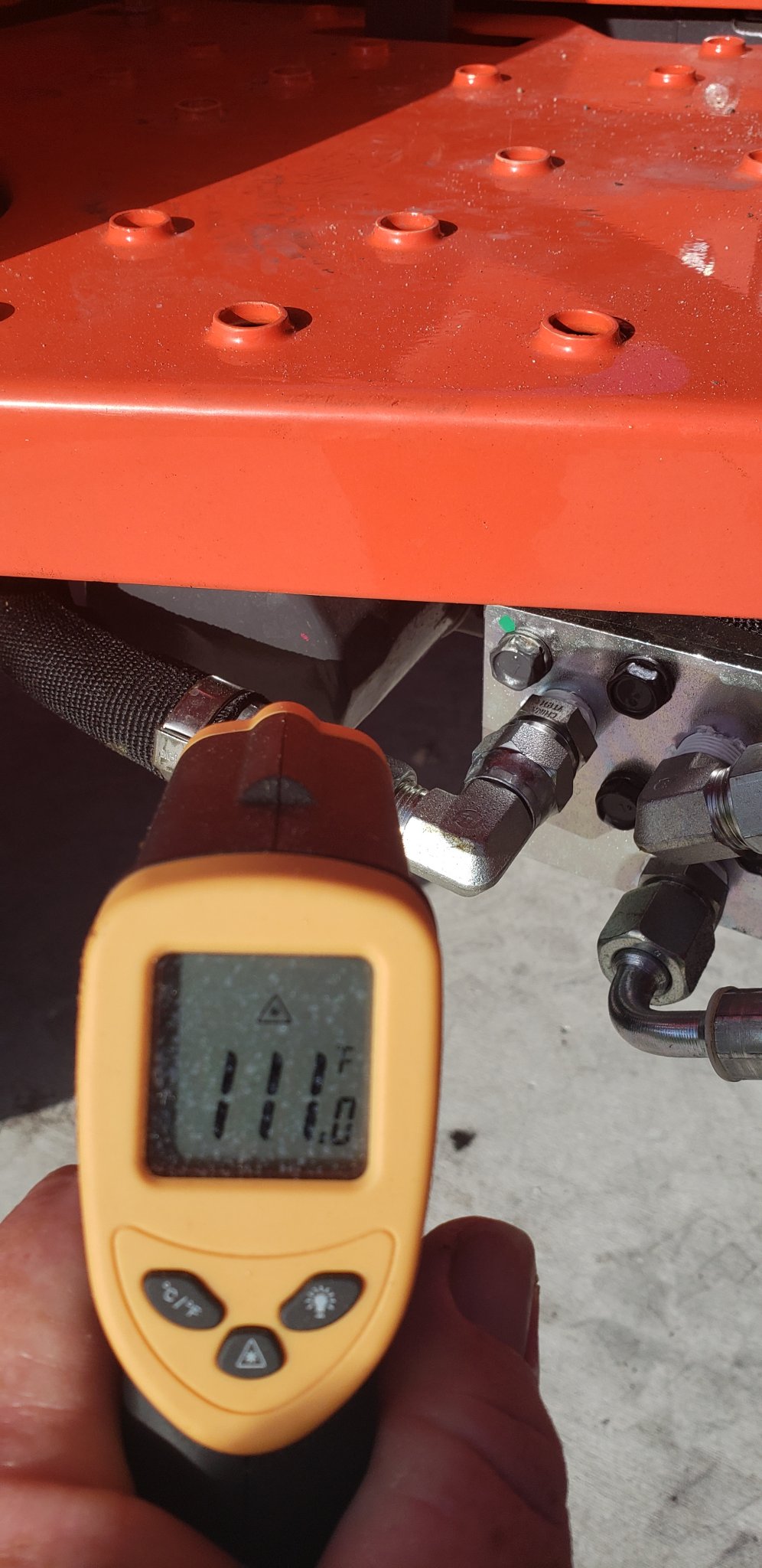

After about 45 min of run time moving my trailer and some pallets of firewood my hydraulic oil filters got to 111 to 121 degrees. The rear differential was 116 degrees at the hottest spot and the metal hydraulic line by the exhaust manifold and starter was 141 degrees.
It's a cool 92 degrees and 80 % humidity today in West Palm Beach Florida..
