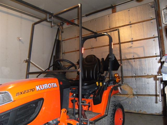

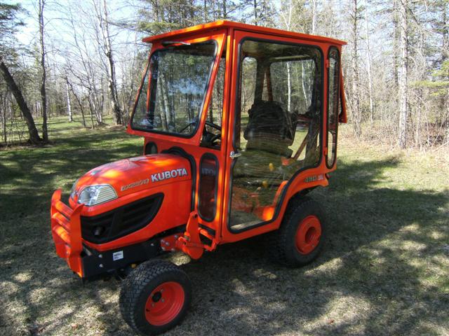

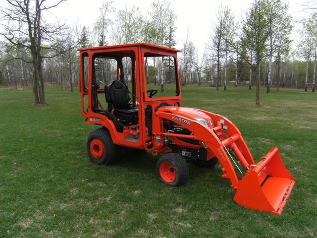

Built a easy removable cab for my BX. I like to have the cab off for summer grass cutting etc; The thing about this cab is that when I made it I have the option of leaving it on for the summer.Both doors are removeable and both the front and rear windows open to allow max air flow.The first thing I did was to shorten my ROPS .Unless your a good experienced welder I wouldn't recomend anyone to do that.{ don't worry if I sell the tractor in the future I'll replace the lower half} I wanted to have a Rops inside the cab rather then not have one at all.Also in the summer the Shortened ROPS holds my sun shade that I had on my BX 2350. [I didn't have a cab for the 2350].First I had to make some mounts the rear uses the rops mounting bolts and the front mount bo;ts onto and into the holes in the loader mount.

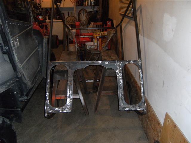

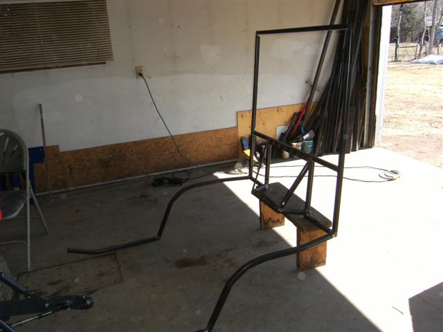

The next thing was to make the back of the cab,which takes some thinking because of the 3 pth top link .Rather then guess what to do I left the top link in the up storage position and worked around that.I left the cross piece in place and cut it out once I had made the frame to fit around the top link.I had to figure out how wide to make the back so that when I attached the sides the cab would still flip over and clear the side grab handles.I also wanted the cab to have a taper from the top to the bottom. The other thing to take into consideration was that I wanted to keep the back as narrow as possible so that when I put on my grass catcher that the chute didn't rub on the cab.
