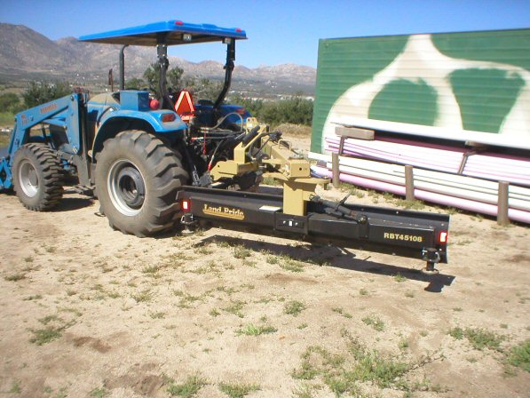

I would highly recommend an 8 foot blade. When you start angling, the blade gets a lot narrower.
A 7 foot blade at a 45* angle is only going to cut about 60 inches wide, an 8 footer is about 67 inches.
I typically run my blade between 35* & 40*.
That's just me, but getting a straight blade to narrow seems to be common. People don't consider how much the cutting width changes when angled.
Bison makes a very good blade for a reasonable price.
I highly recommend getting the skid shoes for it also.

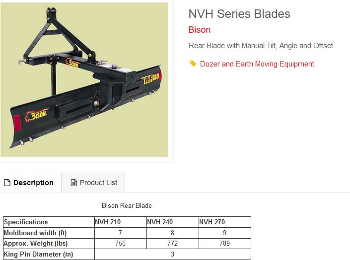

I see that Bison makes a range of rear blades, there was some criticism of their lighter models, the NVH as the 3 point mount frame was just flat strip, concern was bending. The heavier models have box section frames at the 3pt, which look sufficient. From the weight you are quoting you must be looking at the heavier models.
I really like the hydraulic controls that they offer on these blades. I have ended up fitting 2 sets of rear remotes on 2 of my tractors and 1 set on the other. You really do need rear remotes in my opinion, if you are getting them added, go for 2 sets, I've been back several times for the second sets!

Yeah, I am looking a the heavier duty series that averages 1,000 pounds weight with cat 2 pins. The 3 point frame is better designed on the heavy blades.
