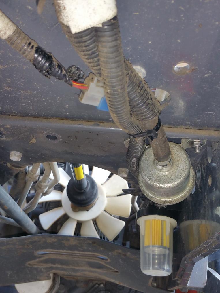

Here is mine***8230;
Uses the factory Kubota filter assembly: 6A320-58862
(https://www.amazon.com/Kubota-6A320-58862-Complete-Gasoline-Assembly/dp/B007S1P7X4)
OR
(https://www.messicks.com/part/6a320-58862/fuel-filter-assy)
Very easy to install and I placed mine where you can get to it easy, but keep it out of the way and safe.
This will probably be your cheapest and easiest solution to the crappy OEM filters. You could even use 2 of them, placing one before the pump, and one in the engine bay after the pump.
