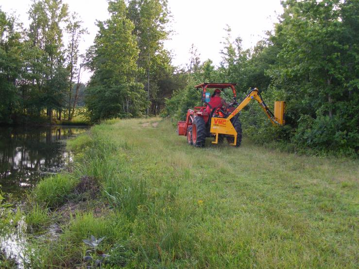

A while back some one on here posted pics of a push mower they had rigged up to hang out 4-5 ft beside the tractor, using the 3 pt to raise it up and down. Can't remember who it was, it's been awhile.
