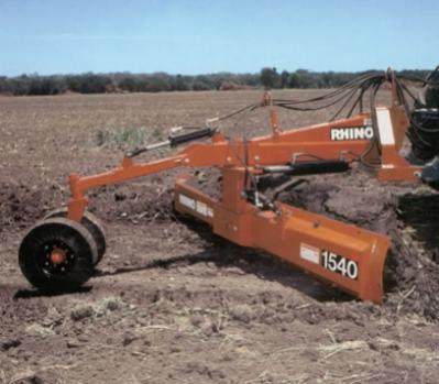

Here are my three picks:

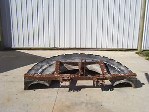

Land plane: I made mine for about $150 copied this one.
Mine is at another forum members house right now being copied and reproduced.
Another cheap tire version:

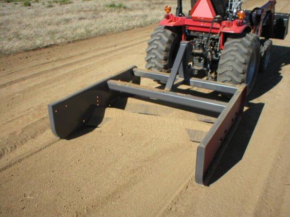

Flat blade with float wheels:

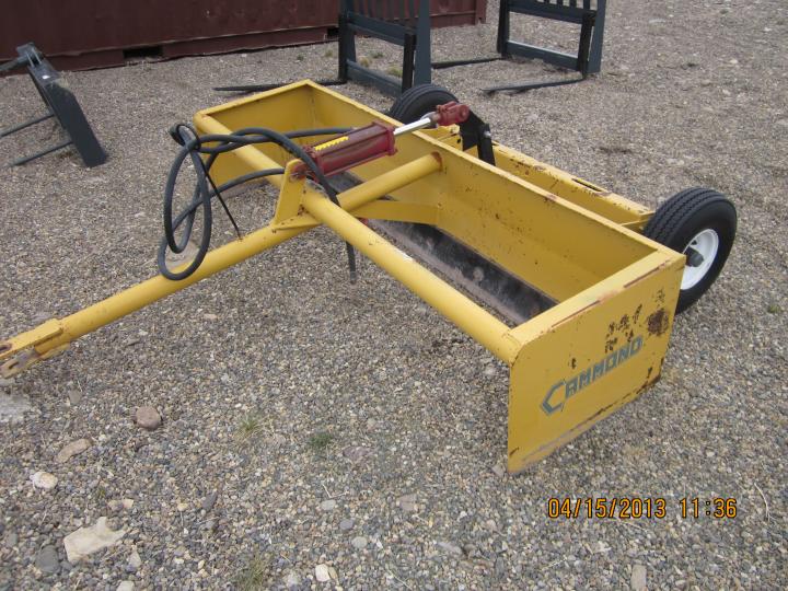

Box with float:
