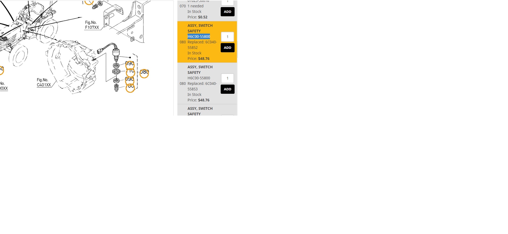

if the problem would be a defective switch, would it be the one in the attached picture?
Thanks,
Looks like the switch.
I would be inclined to adjust it first before replacing it.
Is your clutch pedal's free play properly adjusted to be 1-1.5".
Adjust free play and then the switch.

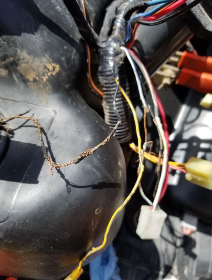

Thanks! I posted a separate question on the solenoid and it looks like I may have found the culprit... wires going to the relay touching each other. Not sure why pressing the clutch repeatedly would have ever helped start the motor, but after adjusting the clutch, the tractor has not started again. Either way, that clutch safety switch is on/off, so as others have said, it should not be the problem if the engine cranks at all.

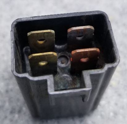

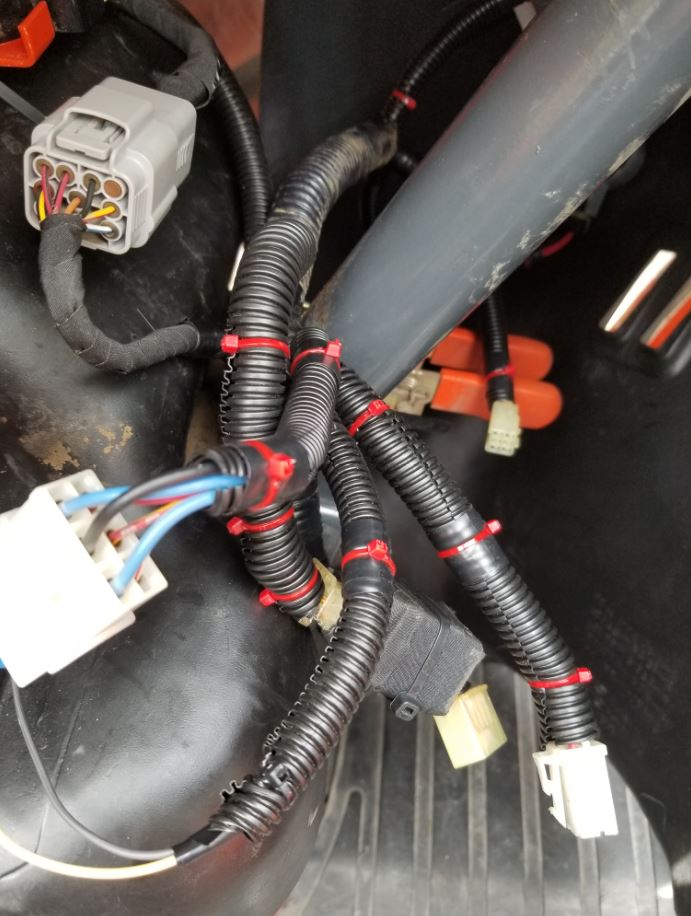

Finally received new relay (Kubota OEM part T1060-33720)) and that was it! Glad I looked at the wiring as it needed some fixin'
I replaced the uninsulated wire sections, and wrapped+ covered the other wire bundles. AND I learned how to adjust the clutch and the brakes while I was at it.
