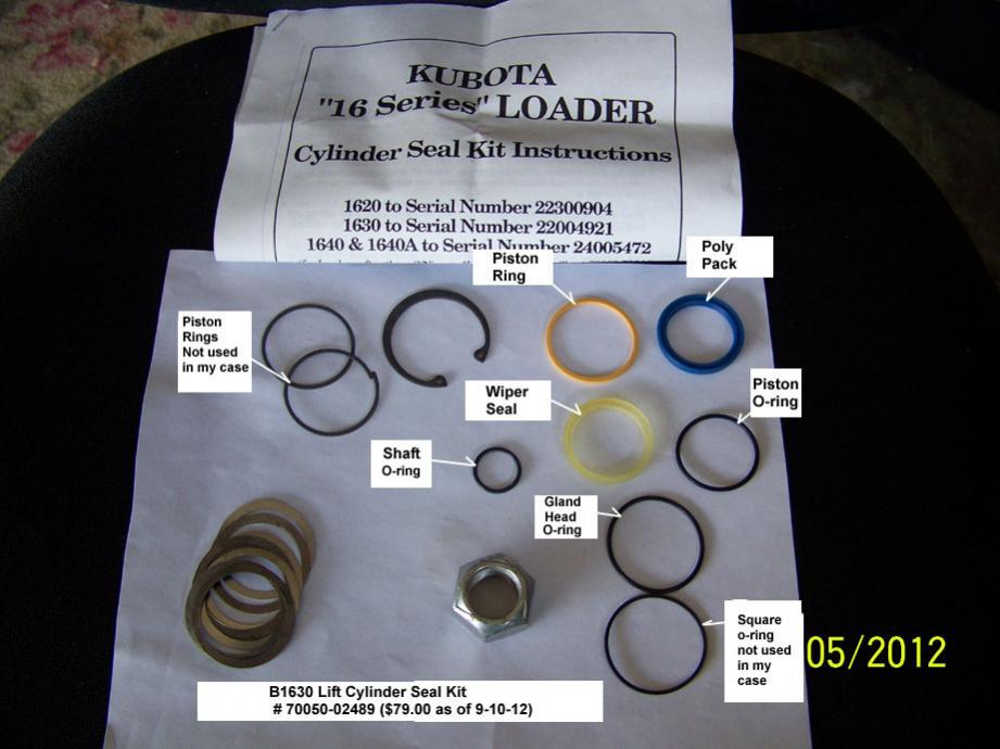

Ok I have a seal kit for a B7200 HST-D loader (B1630),I have torn down the Lift Cylinder, but I am not sure , what goes where.My main question is "on the piston #1 there is a carbon ? ring, do I replace it with the yellow ring #2 (rigid) or the two piston rings #3. any help would be appreciated. Thanks Jim

I have not taken it apart yet, that is the gland (I think) and the piston.
all the old seals are still on, or inside the parts. The seals shown, are parts in the new seal kit. The yellow seal, or gasket, or ring, on the piston is what has me baffled.
#2 in the picture, seems to be the replacement for the
part on the piston (#1). The OD & ID seem the same, but it will not slide over the piston (too small)
But part #3 is a set of piston rings (2)
Thank You for the input
Jim

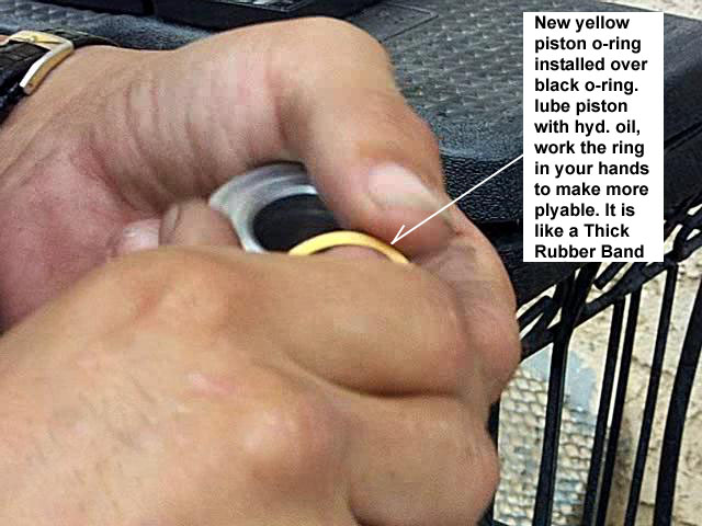

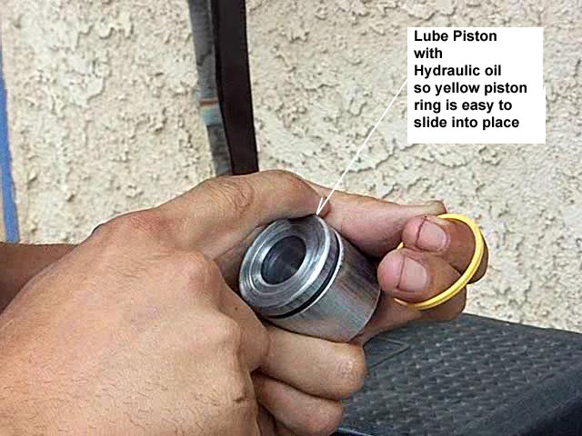

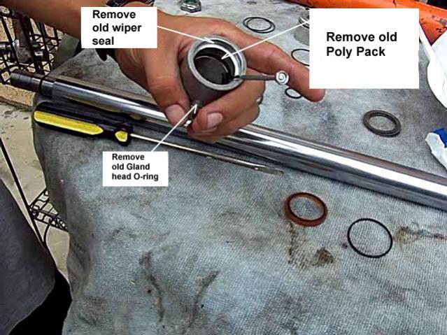

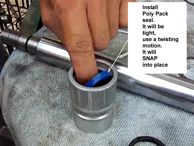

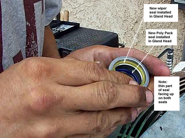

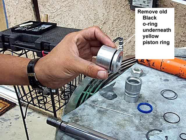

Well Craigslist panned out. I ran an add in the wanted section, and within
an hour, a gentleman called me, and said he was currently not working, and that he was employed, in the hydraulic repair industry, for the past 4 years.
He did the repairs, and let me video tape the repair work (the yellow ring was a piston ring, with an O-ring underneath it !!) he gave me all kinds of advice, and tips while performing the repairs. I would like to Thank everyone for their input.:)

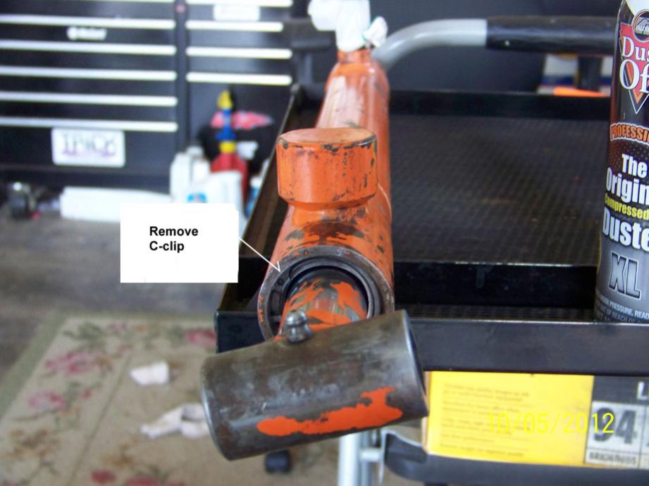

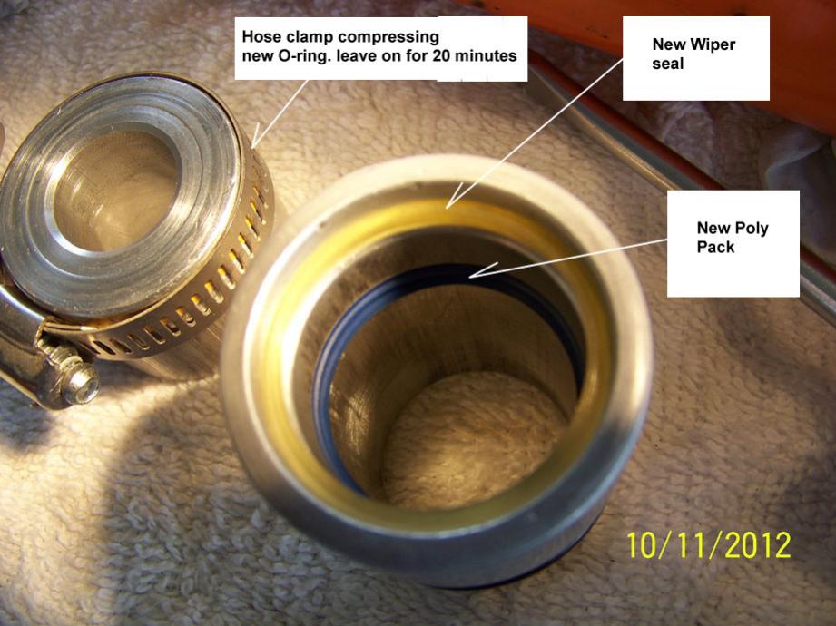

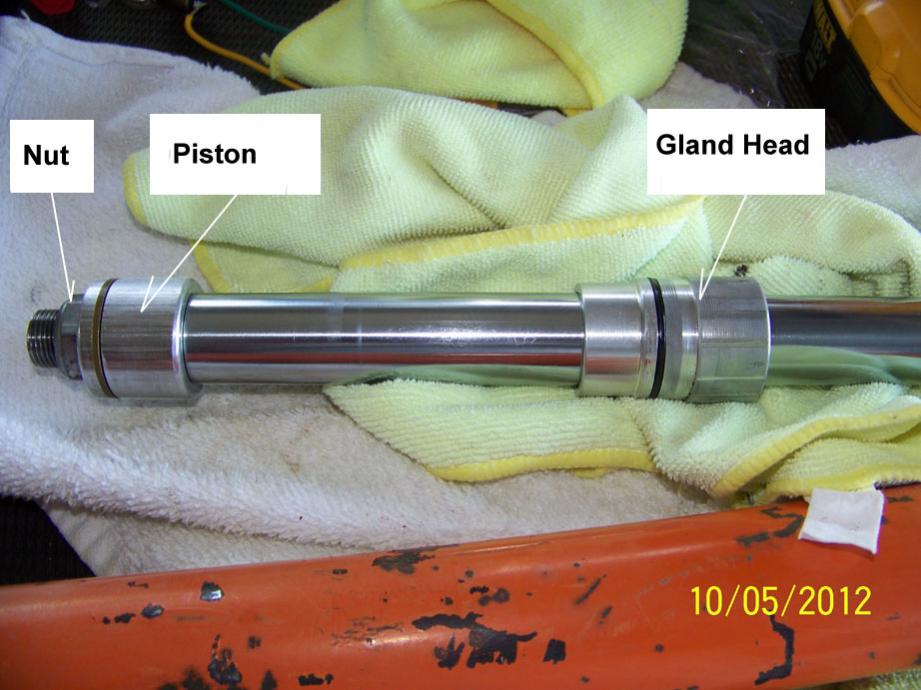

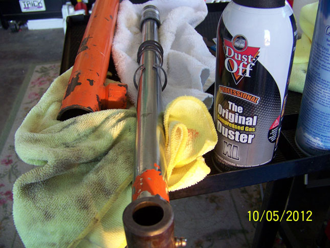

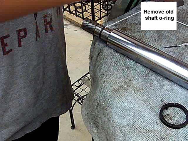

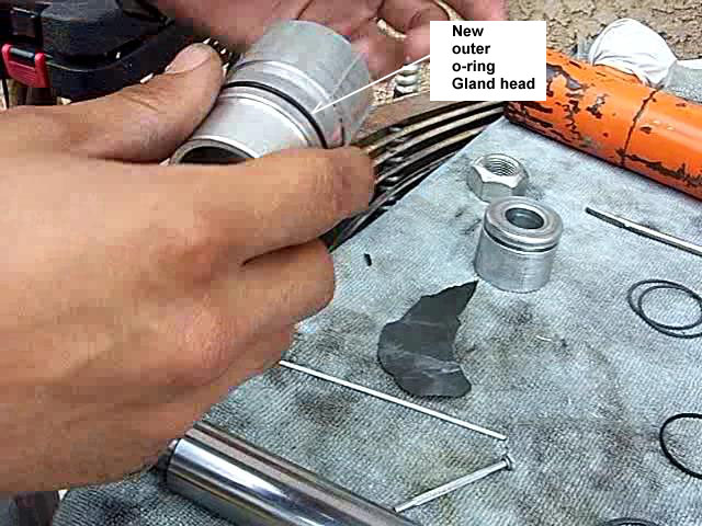

He said I could post the video, but I do have a few pictures as notes.
Maybe these will work
opps 5 max is the upload limit, this will be in parts, Part1

THANK YOU for putting together and posting this B1630 loader cylinder rebuild procedure!
Love the pictures and comments on them! I would rather see then read printed instructions.
