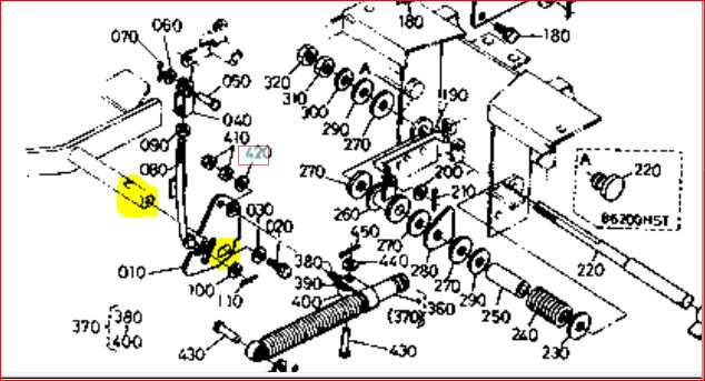

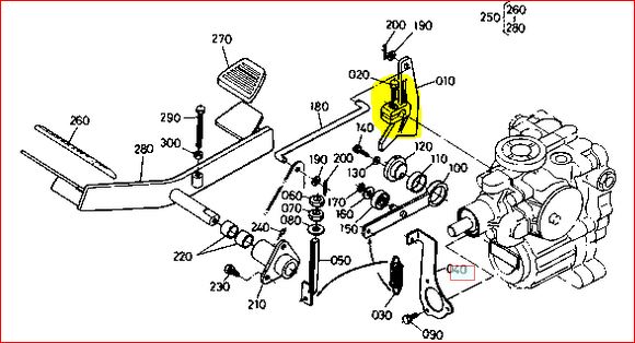

Linkages all have some looseness to them, nothing is ovaled. But differently some slop in the triangle bracket. The rod 180 has a bend (looks like it comes that way perhaps? metal brace welded to it? Same color at least)
I will have to take a picture of my pedal, but reverse a lot higher up than forward. I will have to take a picture later to show how it looks.
Wolf do you have the parts manual with part numbers I can get to? Not sure where you got the pictures?
