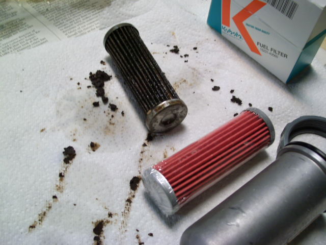

Yesterday I fired up my new to me but well used 'bota to clear some snow. It was cold, but no colder than a few other times I've used it. I got about 15 feet away from the parking spot before it started acting like it was running out of fuel and losing power. I'd let off the HST pedal to unload the engine, it would start to rev back up but bog down again when I tried to move again. I had put in new fresh fuel last week (laced with Power Service "white bottle") and used it some then, so I figured gelling fuel shouldn't be a problem. I nursed it back to the parking spot and shut it down.

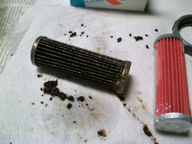

Today I took the fuel filter off, to find YUCK in the bowl! I didn't get a picture of the inside of the bowl, but the filter and SOME of the sediment are shown in the pic I've included. I did not find a small spring to go under the filter element, parts book doesn't show one, but the filter service article on this site talks about it. Can anyone confirm that there is not a spring under an older B7100 fuel filter?

OMG that's your fuel filter? Looks more like a dirty oil scavenge.
Only a suggestion but when you get the chance it would probably be a good idea to clean out the fuel tank and supply line to the filter.

UH brother that doesn't look so good. Either you some how got dirt inside your fuel tank or you've had diesel siting in fuel cans for to long and it started to form a fungus and algae inside the cans.

I didn't think it was possible that a fuel filter could get that cruded up. It must have been there for years. Lot's of years.

I had few minutes today to go play with my tractor. Good news - the bog and power loss are gone! I even manged to get all the lines bled and get it started up on the first try! Thanks for all the info Mr K and Vic!!
As far as the dirty tank and lines someone mentioned - yeah I'm thinking a good cleaning is in order. I don't see a lot of junk through the tank filler, but obviously SOMETHING has gone through it!! Only problem is I just filled the tank before this problem occurred (it was a clean can, and fuel from a busy station, so hopefully fresh), and now I have some fuel I'd rather use than waste.
