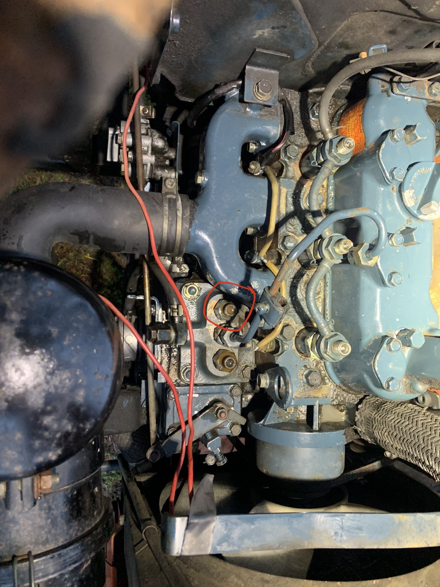

So I disconnected the high pressure lines from the fuel pump to the injectors. One of the connections at the fuel pump was very tight to undo (had to be the bloody middle one, the most difficult to get a good grip on with the wrench) but that one and one of the others (so 2 of 3) had rusty looking fuel sitting in them
I cranked the engine and basically nothing was happening except some movement/bubbling but definitely no ‘fountain’ like I was expecting,
however, when I backed off the bleed screw it was squirting out of there at some pressure, not sure if that is the result of the lift pump or not. Basically not looking great for the injection pump!
what would cause rusty looking fuel. Water been sitting in there somewhere for a while??
Yea water will do that.
It needs a rebuild or replacement.

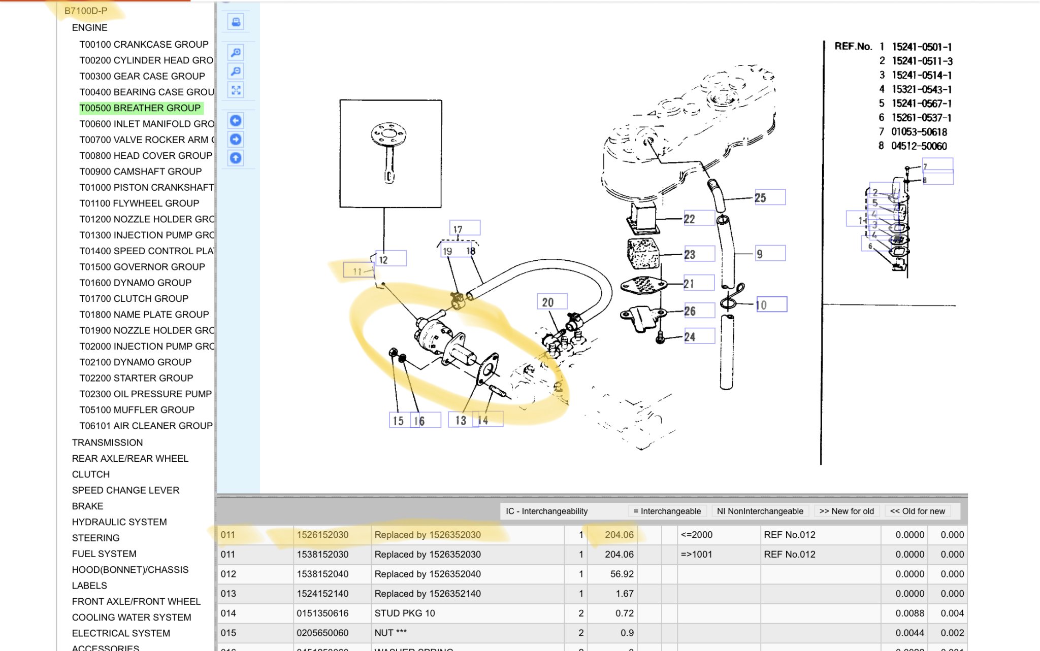

So a couple more questions...I’m suing the kubota parts finder tool and im struggling to identify the lift pump. The closest thing that looks like it is called the ”assay breather” would that be the one. Seems like an odd name. I’m thinking if there is rust in the fuel pump then there is likely same issue in the lift pump so was planning on ordering a rebuild kit for that As that looks like an easy enough job, would you agree?

ok well that’s definitely the same part based on the picture…for some reason the manual available to me puts that part in the breather group category which threw me. The part number for mine is saying that it has perhaps been replaced by a different part number now. The quote for the replacement is quite a

Ok that makes sense if I can find a cheaper one. That picture you sent is very helpful and confirms my confusion as my manual does lump that part into breather group for some reason.
It also suggests there is a newer part number so I’ll get hunting for that. The Amazon link you sent quotes a much cheaper version that the manual is suggesting (CAD$204.06) so I’ll check there.
My local dealer quoted $258 for each injector too and local diesel injector specialists quoted $150/injector to rebuild so I’ll hunt for cheaper versions of those too I think.

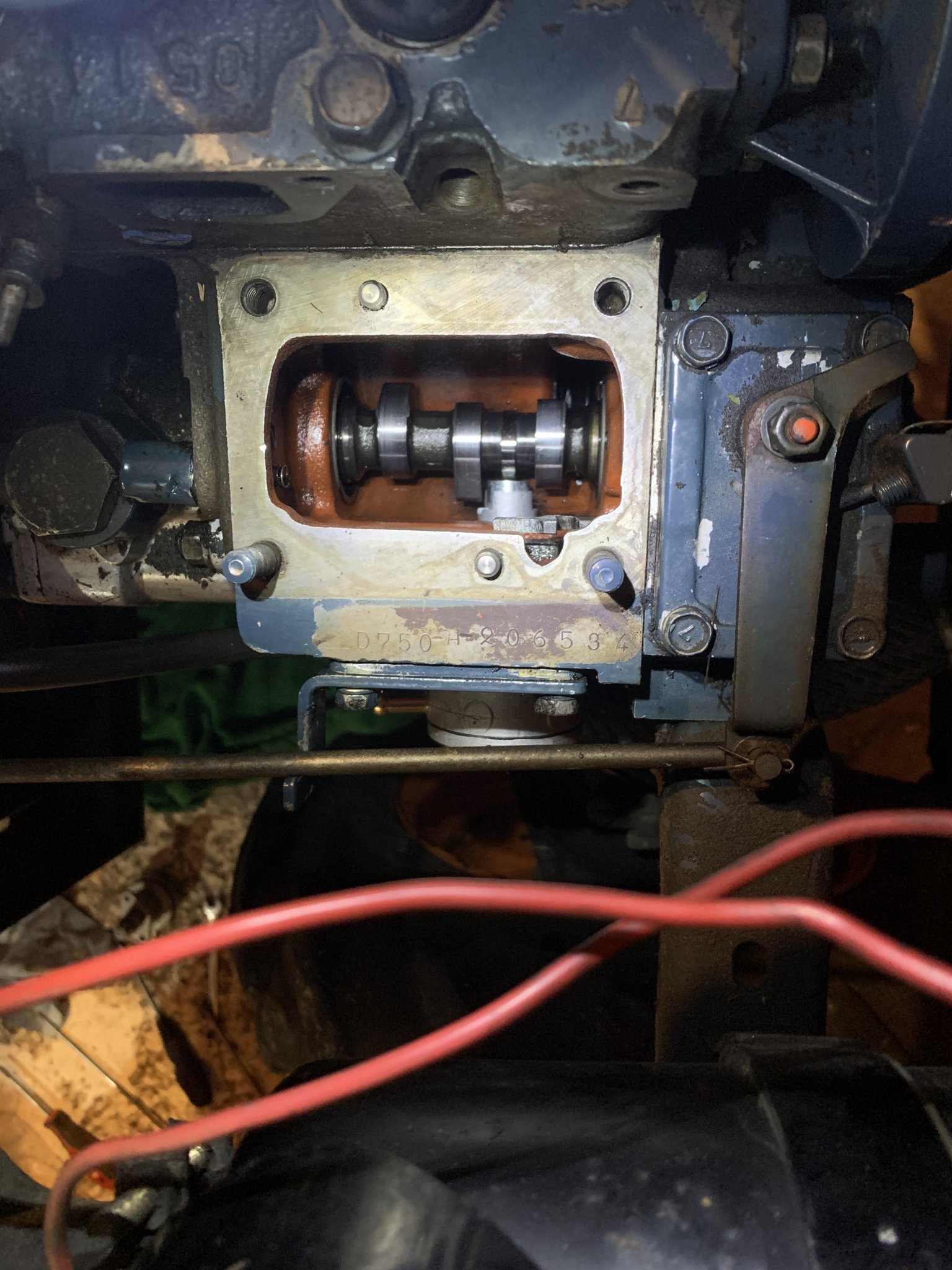

Ok so I’m rebuilding today starting with the new lift pump…I’ve noticed that the notches on the piston sleeve that give clearance for the other cams is not aligned perfectly. I have the pump the correct way up with in and out arrows in the correct placement. It looks like there is still clearance JUST!
I took the old lift pump apart to inspect it and it ‘seemed’ fine…I’m tempted to put the old one back on.

Try turning the pump 180 degrees and see how the clearance looks.
If it gets better then just turn the top and middle section of the pump 180 degrees.
If it doesn't take it apart and grind the flat on the sleeve to make clearance.
