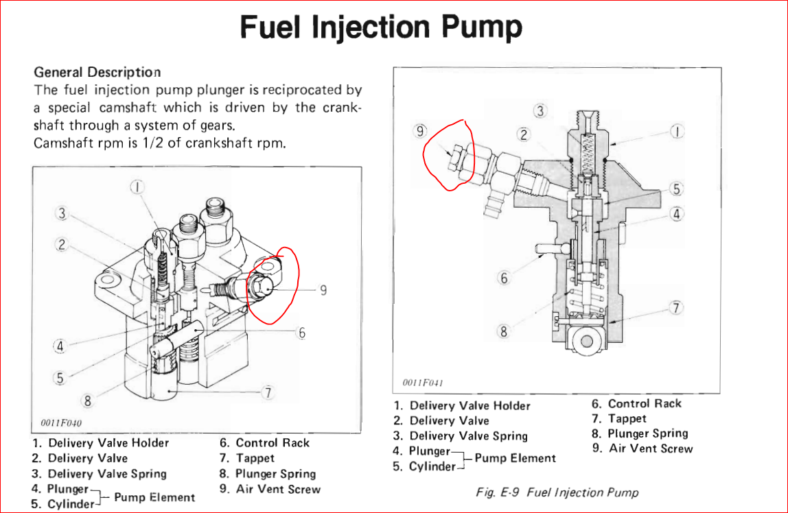

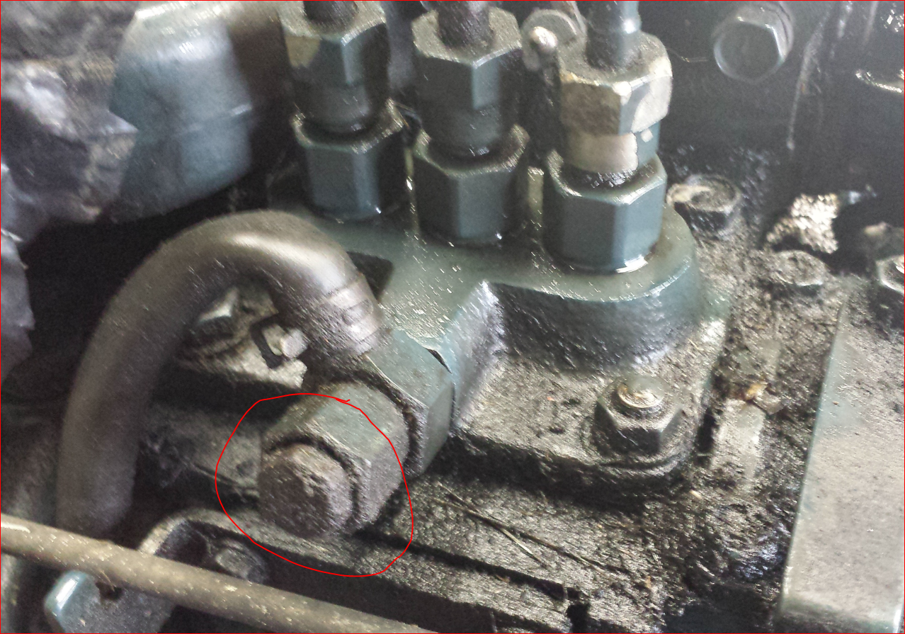

Tell us WHAT you did - specifically, you by chance DO anything to the injector pump?
As you may have read now in the manual ............. take throttle wide open, loosen the bolt on side of the pump............ turn key ......... allow to bleed until NO bubbles..........
5,937
1,732
Specifically did you turn any of the nuts on the lines at the injection pump? The ones on the lines up to the injectors. Did you turn or move the large nuts there?
If you did then you will probably have to get the pump repaired by a professional repair shop.
I did mess with the nut you circled here. I actually took it all the way out and put it back in but not while I was turning the ignition over. I tightened that nut back up then traced those lines above to the engine. I loosened those one by one while turning the engine over until no air was in the lines and the engine started. The tractor ran for about an hour but the whole time I could tell it didn't sound quite right and it didn't operate quite right.
