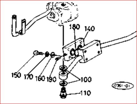

But look at this picture. ;)
Hmmm. That drawing certainly makes it look like the o-rings could be in the hydraulic block side. I guess I better pop mine off and visually confirm before I send this off to farmboy.

Anyway, back to the o-ring issue; the WSM drawing is correct, the parts diagram drawing is wrong:
