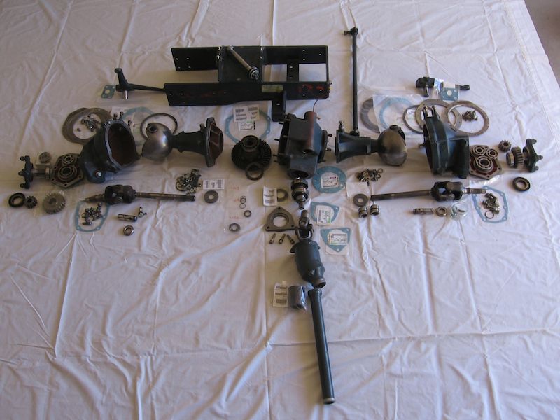

I have seen the grease thing done before, and it's undoubtedly superior to no lube, but I'm just finishing a complete rebuild/repair of my B7100 front axle. I would guess yours is similar, and the thing that would concern me is the ball bearings. The gears would probably be all right, but I would worry that the grease would not reach or stay in the bearings, especially if they have cages as tight as the ones in mine. I think the only way you could get the same "flood lube" effect that you get from oil would be to 100% completely fill the cases with grease. (no air spaces) That way as grease was driven out of the bearings, other grease would have to flow in. Might make an interesting research study.

It looks like your B6000 has the same "ball knuckle" style axle as my B7100- if so, the knuckle seals are probably the main leak (#72,73,75) and won't be found at any auto parts stores- dealer only.
For mine they ran a little over $53, from Coleman. Assuming yours is like mine, if necessary, one could fabricate the gasket, (#75) and the felt wiper (#72), but I see no practical way to fabricate the rubber seal. (#73)

I own a B6000 4wd and have rebuilt the front axle on it.
