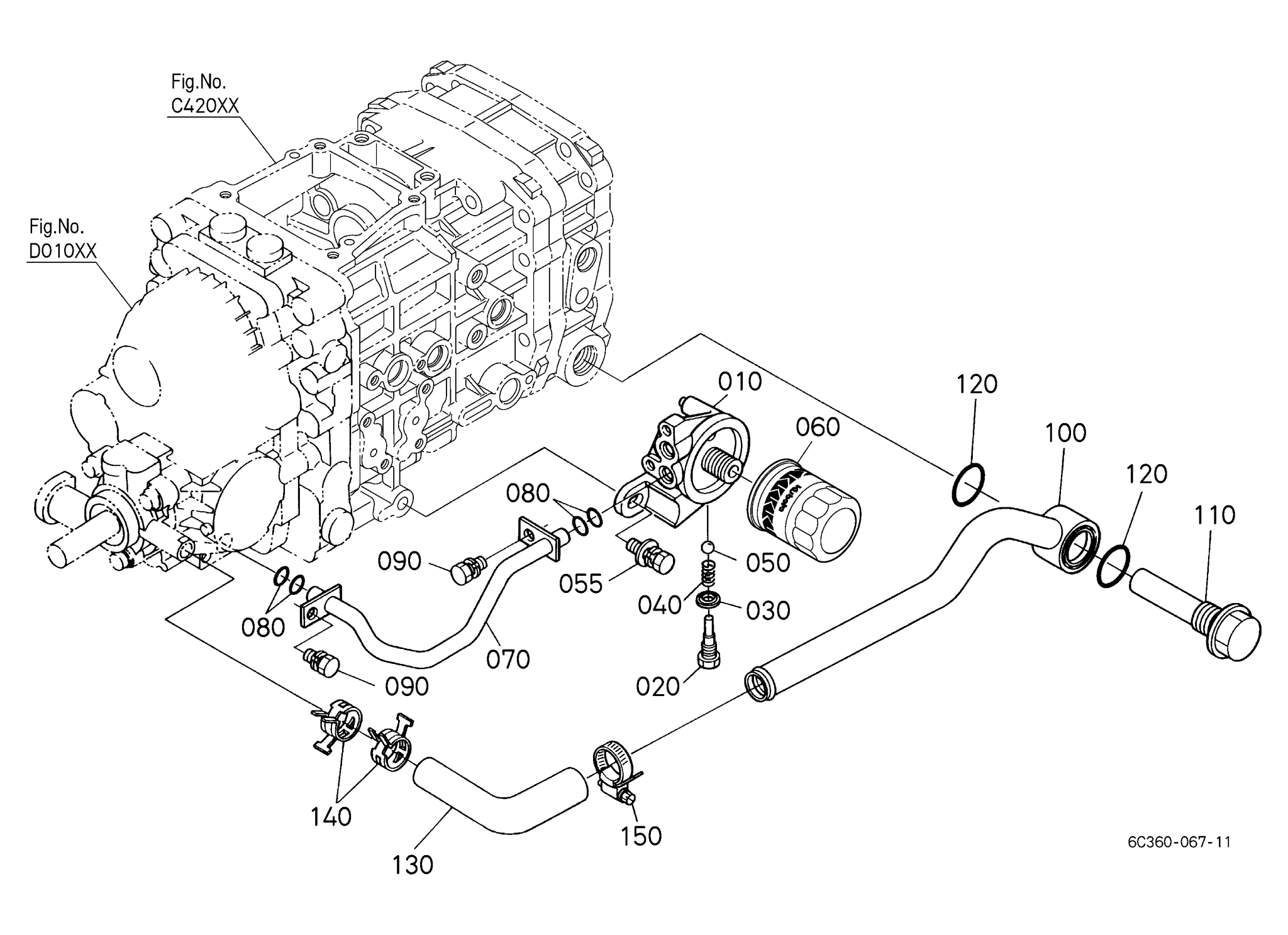

the line goes forward and curves up over the hydro filter. it is the largest line on that side of the tractor
28,864
5,222
#110 is the suction screen oon my b3200hsd
