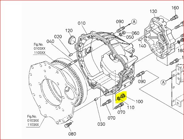

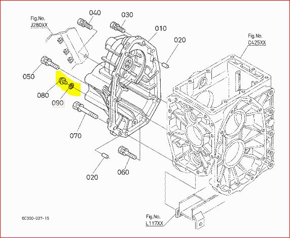

There are several drain plugs (yellow) first is the Clutch housing, No Oil.

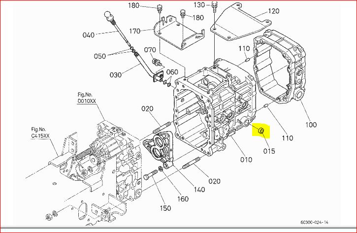

Next is the HST, Transmission Case, LH Axle Case, RH Axle Case, they all have Oil.

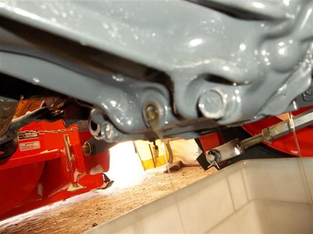

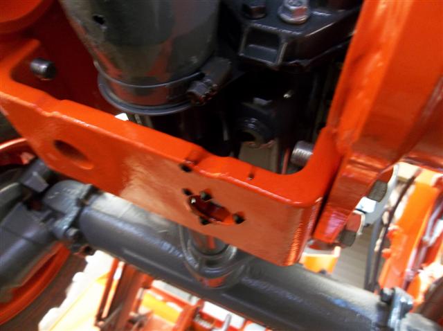

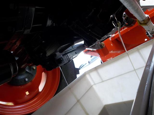

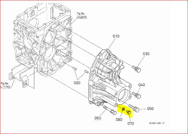

Here's what I found. Pic #1 is what both manuals correctly show.

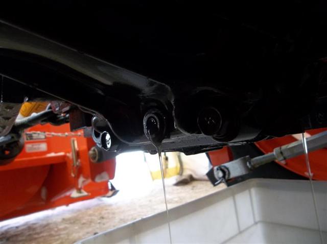

Pic#2 is the 12mm I removed which is a gasketed drain plug. Manuals show you to remove the 14mm housing bolt which is just ahead of it.
Pic#3 and 4 are the 12mm drain on the right side. Again, manuals show it as that 14mm housing bolt to the right of the actual drain plug.
Did I miss anything?? How did I end up overfull putting less than the specified amount back in? Tractor seemed to be level. Had the blower on the 3pt down to the ground and the bucket level flat on the ground. Left it sitting with the drain plugs and filters off for about a half hour.
