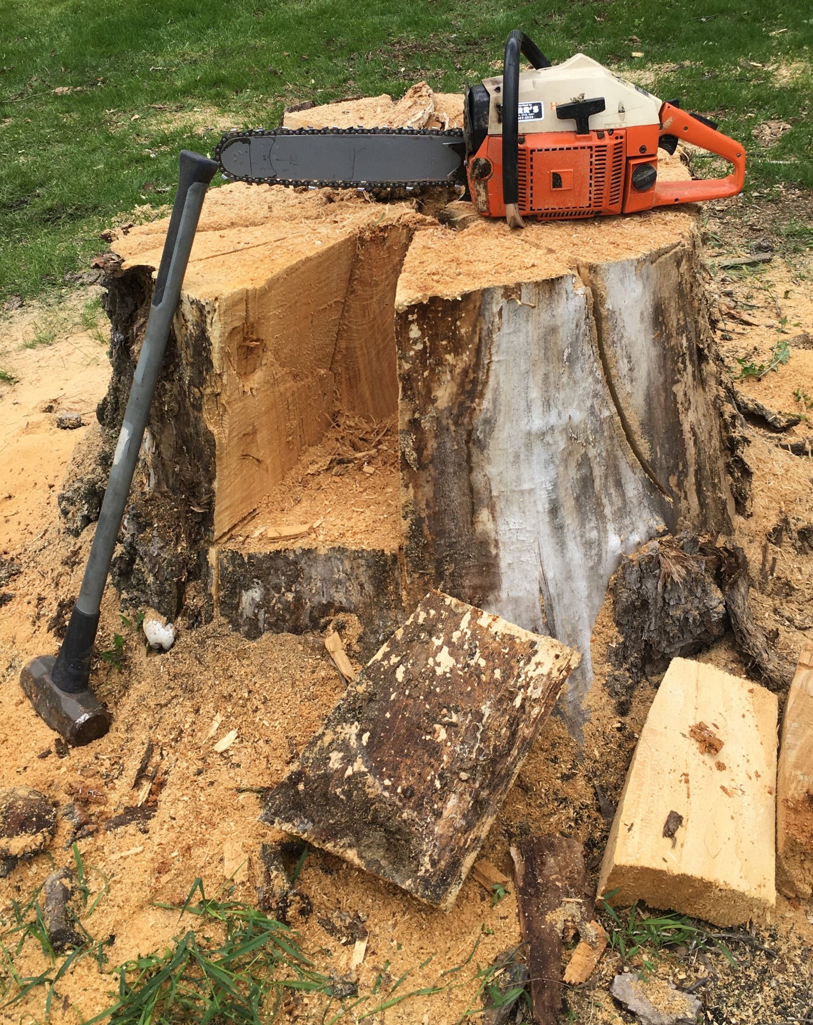

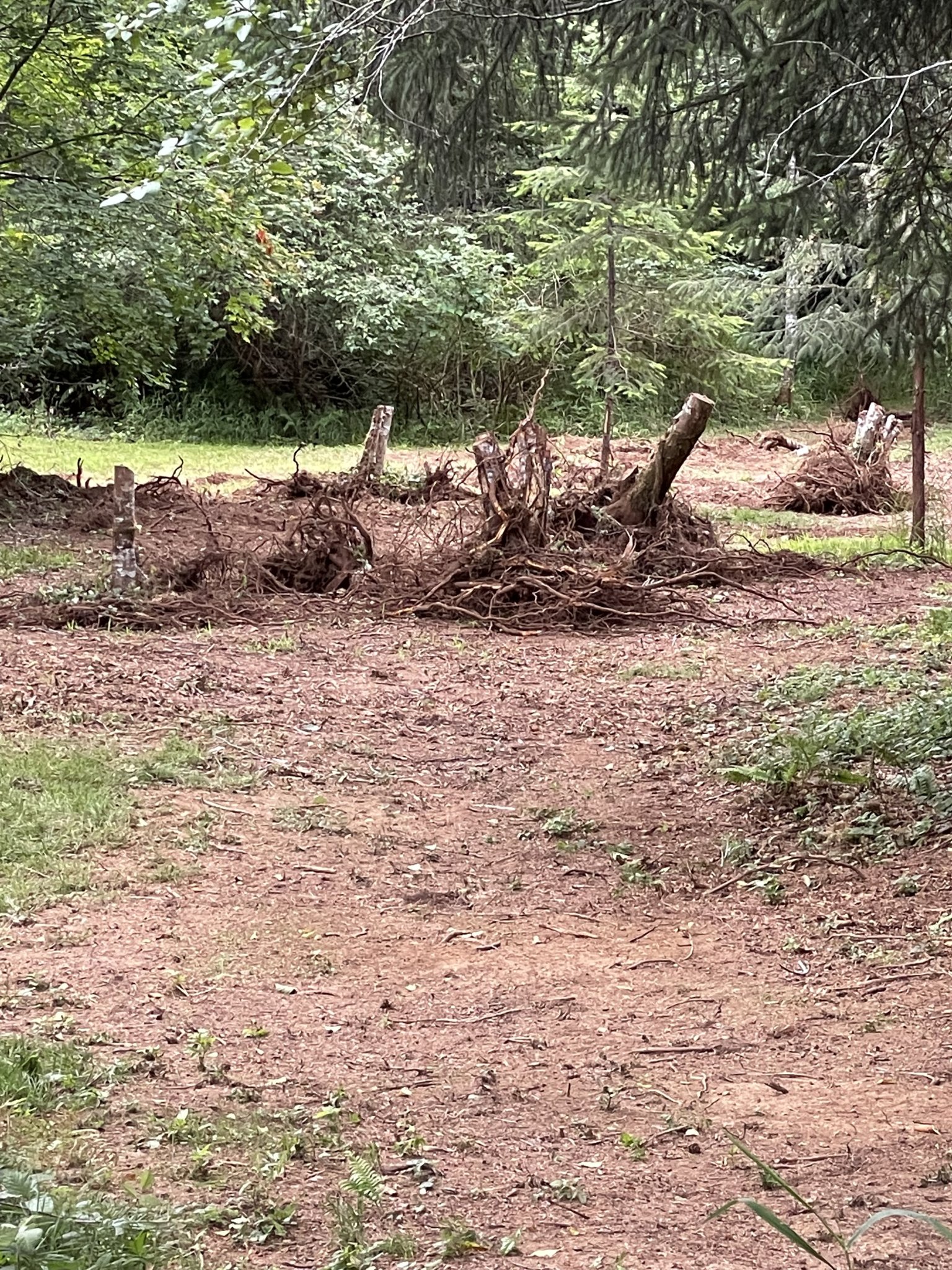

I’m sure stump removal is much easier with a BH or mini-x but;
I leave the stumps a little tall for leverage to loosen them up and dig them up with the front loader. It’s a ton of work but gets the job done. This work was done with my L2501. The B2601 didn’t have enough weight and lift capacity to get these out of the ground.

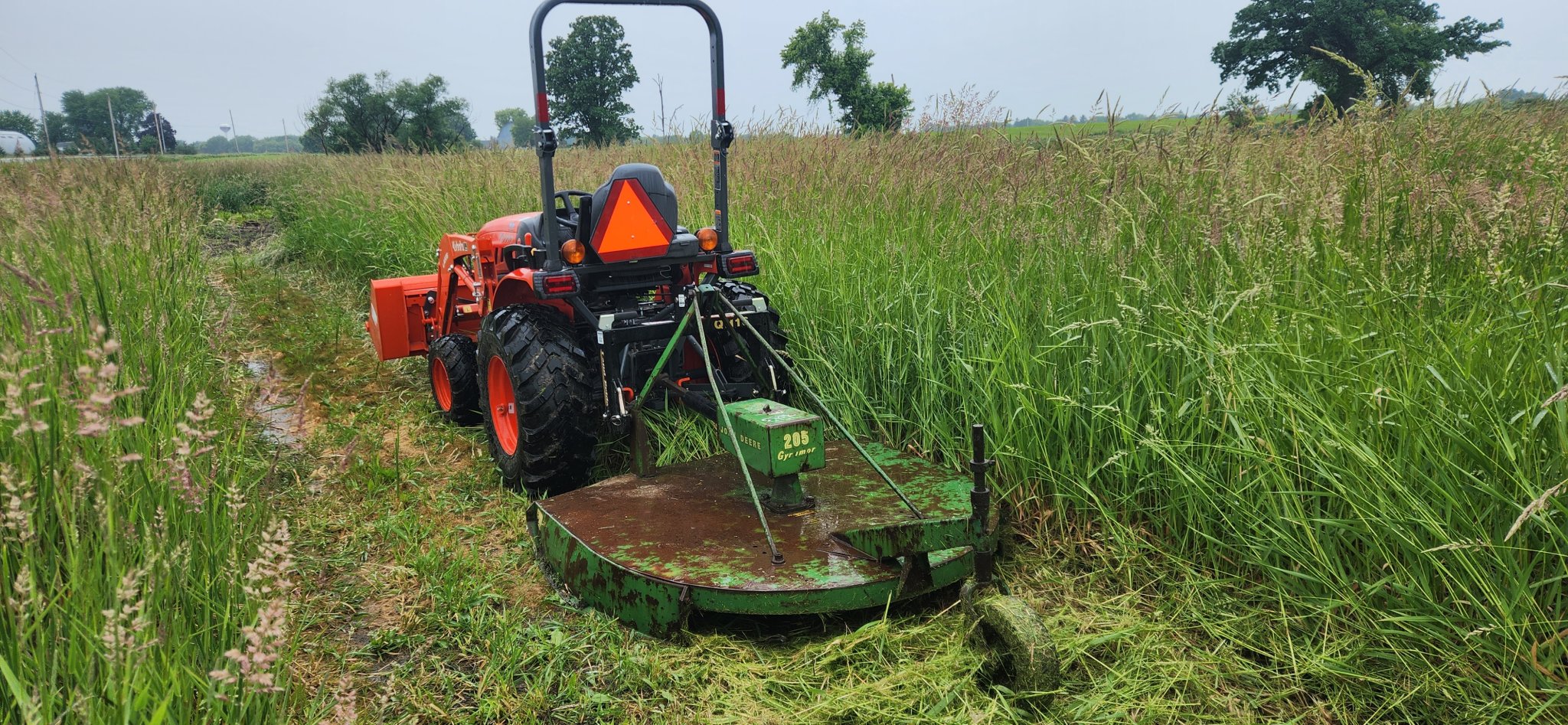

I've had my lx2610 on my 7 acre hobby farm for about 2 months now. An arctic cat 700 atv and John Deere B was my work horse before that. I look at tractors, trucks, and pole barns all the same...... it's easier to get bigger right away and have it than realize " well shoot wish I had more power or room" I wanted a mid mount mower, and the emissions is what dropped me down from an l to the lx. For my needs I didn't bother to look at a bx. They work for some people and others they don't and respect that. So far no regrets on the lx.

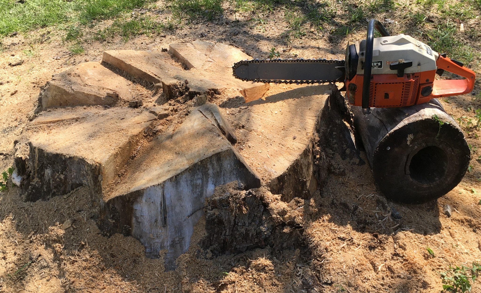

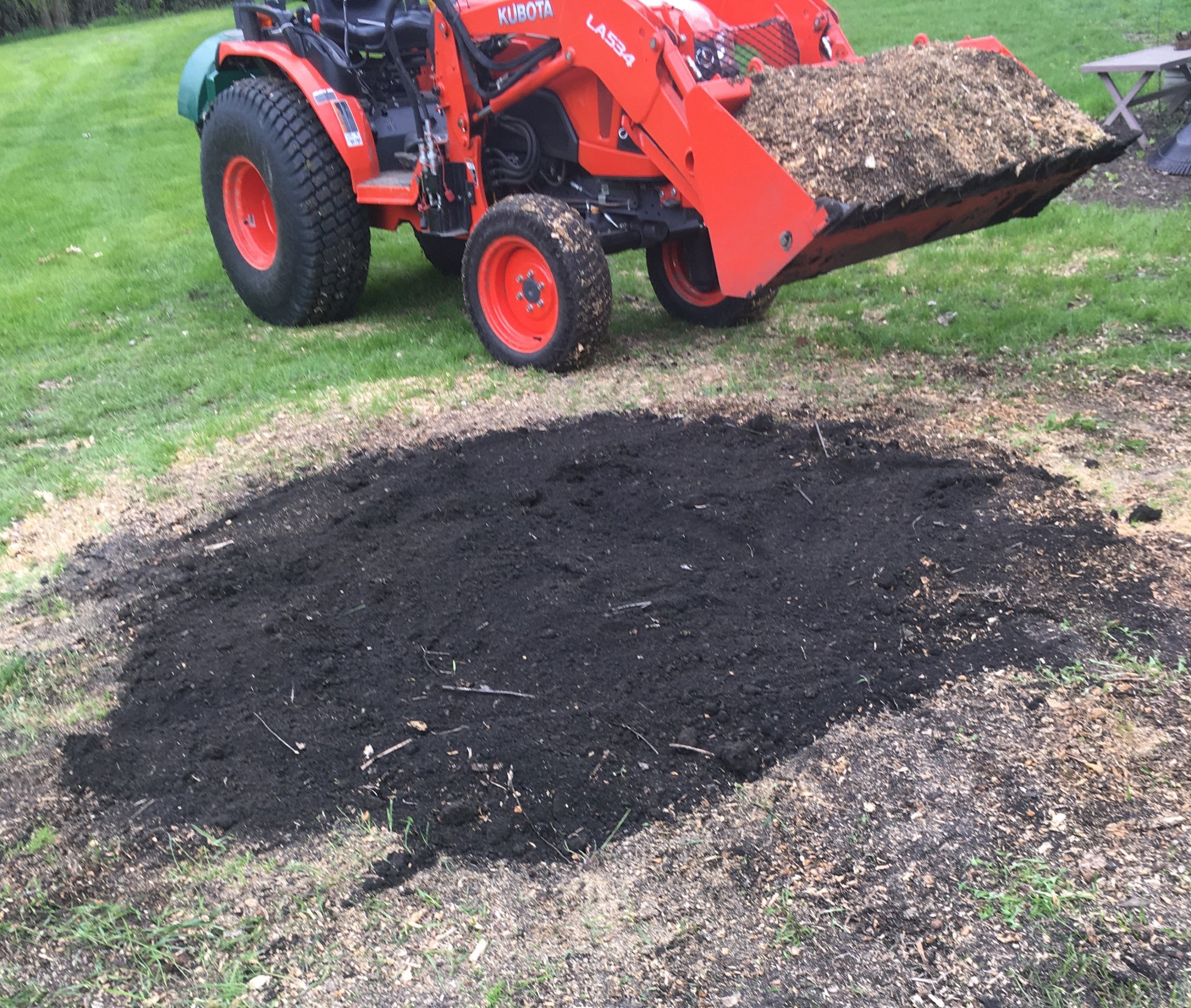

Stump grinder vs. stump bucket: Alot depends on both the size of the tree and the condition/type of ground that the trees are in. I have a lot of 100+ yr old cottonwood, ash, etc. on this farmstead. The old trees are now starting to die off.
Here's a cottonwood that was failing, so I dropped it before it fell on the house. I need a bigger chain saw!!
IMG_8175 (2).JPG To get it low enough for the Woodland Mills stump grinder it had to be cut up like a cake! :)
When cut low enough for the grinder it was a little over 5 ft across at the base.

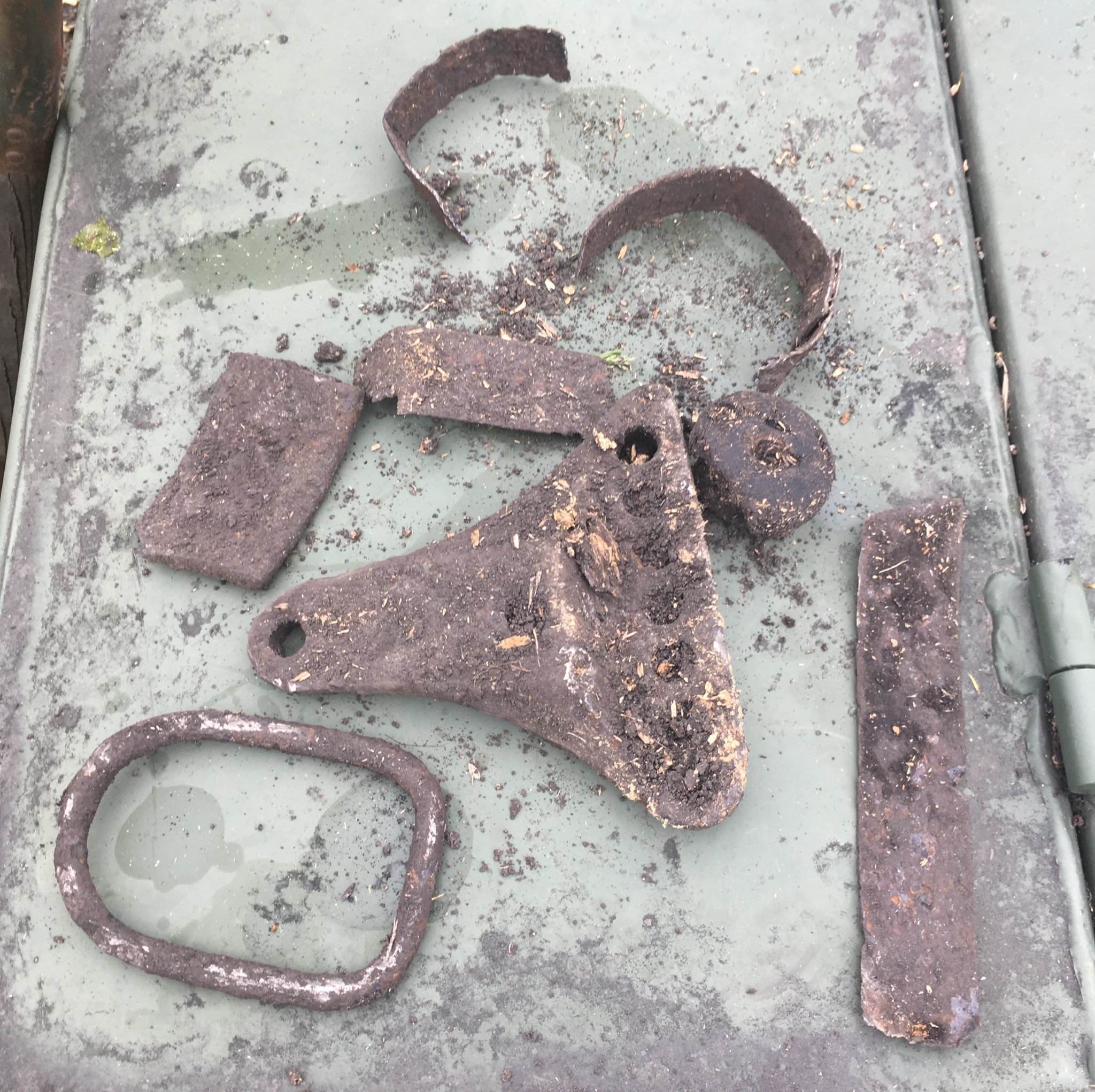

I was smart enough this time to check for buried metal with the metal detector before spooling up the stump grinder...... darn pioneers that left things laying around at the base of trees!! :ROFLMAO:
Shortly after the WG24 was spooled up behind the B2650 and black fill dirt spread in the hole....it was ready for some grass seed.
The Woodland Mills WG24 earns its keep around here!
