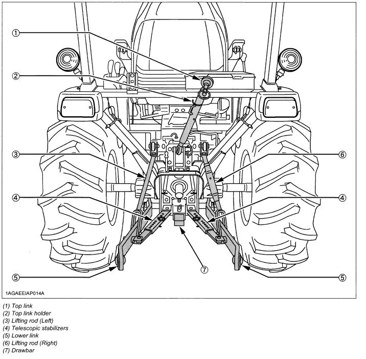

I'm not sure where you saw the part list showing the lower link rods being the same part. From the factory, the left side is a fixed rod and the right side is adjustable. You can kinda see it in the diagram below, notice the right side (#6) is different from the left (#3).

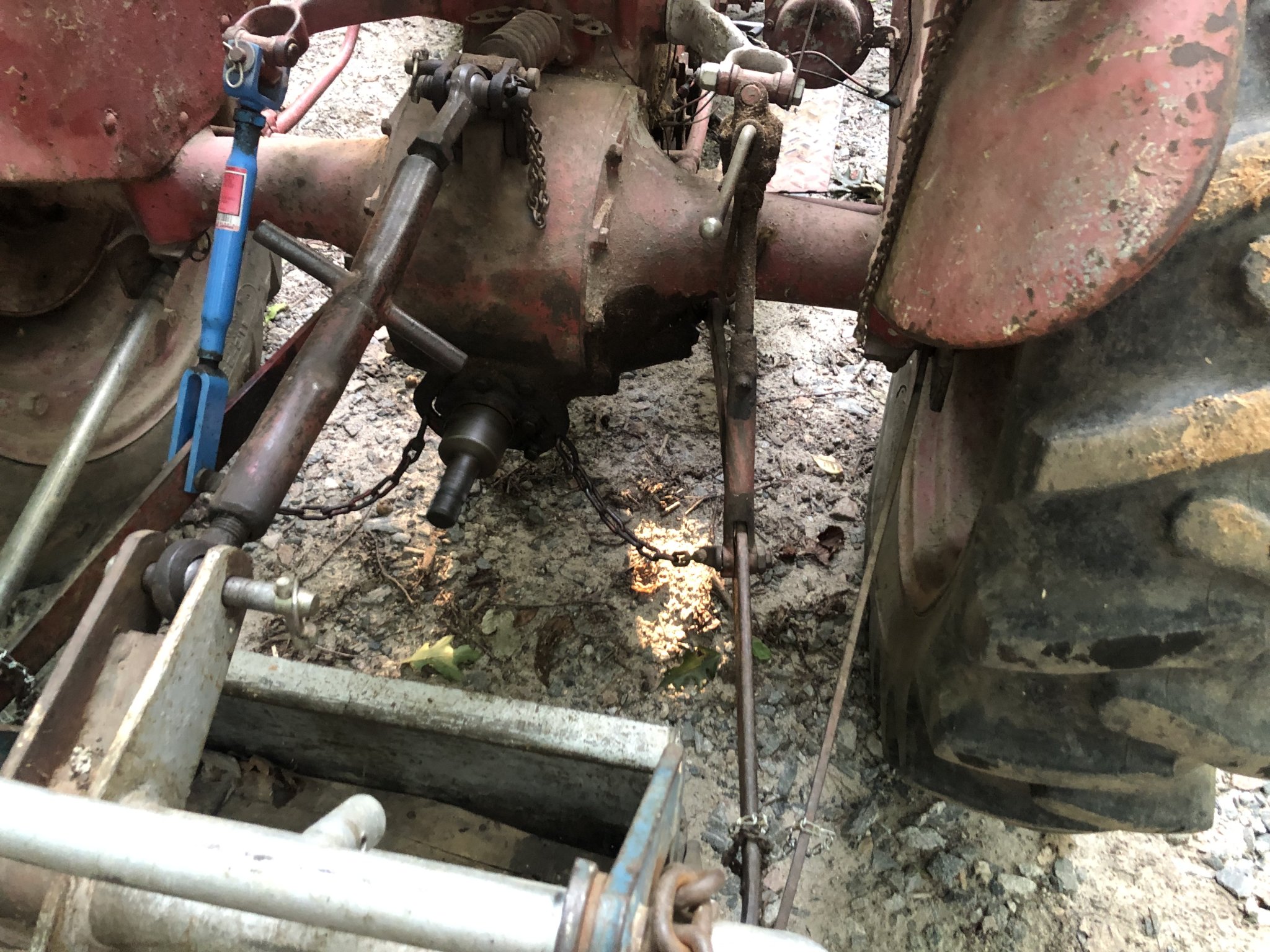

BTW: Looking at the pics below, the sidelink clevises probably all look straight but, just like yours, they all have that little angle.

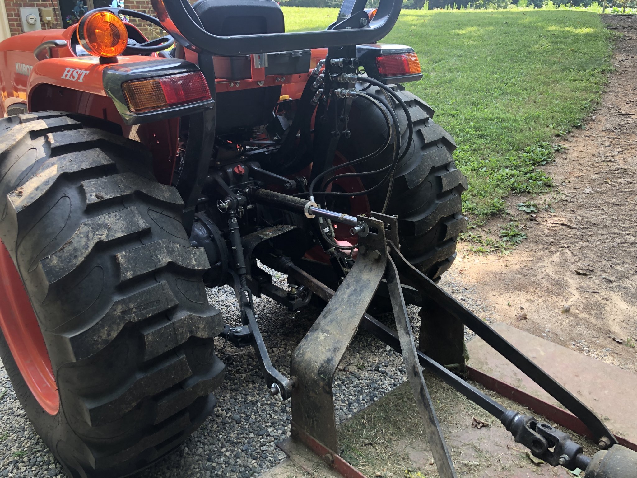

The 3pt lift arms on my B26 has two holes. Installed geared side link adjuster (Weaver Tractor) and Pat’s quick hitches (longer arm length) gives easy and good amount of adjustment for grade work. Did require a little bit of fabrication.

msm's drawing nicely shows the extreme angles the 'lift rods'(3 and 6 ) have,unlike the parts page.
all my tractors (older, like 5 decades ..) I can swap lift rods. it might be a size/design challenge, hence the big bends. I have a 9N adj lift rod on the shelf here,just no tractor for it.
It's the 'lower links' that are the same part numbers, just flipped over.
