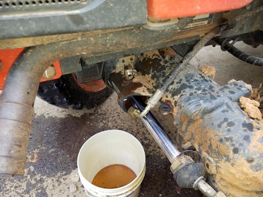

To confirm, turn the wheel one direction remove the hose off of that side of the cylinder that is now extended, secure the hose in a bucket (it will just seep fluid) put the bucket under the cylinder, turn the wheel the same direction if fluid flows, blow center seal. ;)

Okay I turned the wheels to the left, removed the line on the left, turned the steering wheel to the left oil under pressure came from the hoseand when I turned the steering wheel to the right very little oil came from the hose but no oil came from the cylinder at any time. :confused:

the more I think about my results the more I believe the controller is bad, but I am going to test the right side of the steering cylinder like I did the left curiosity is getting to me.
