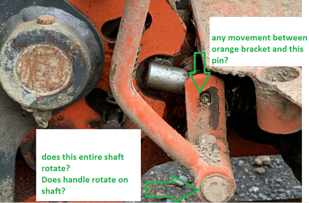

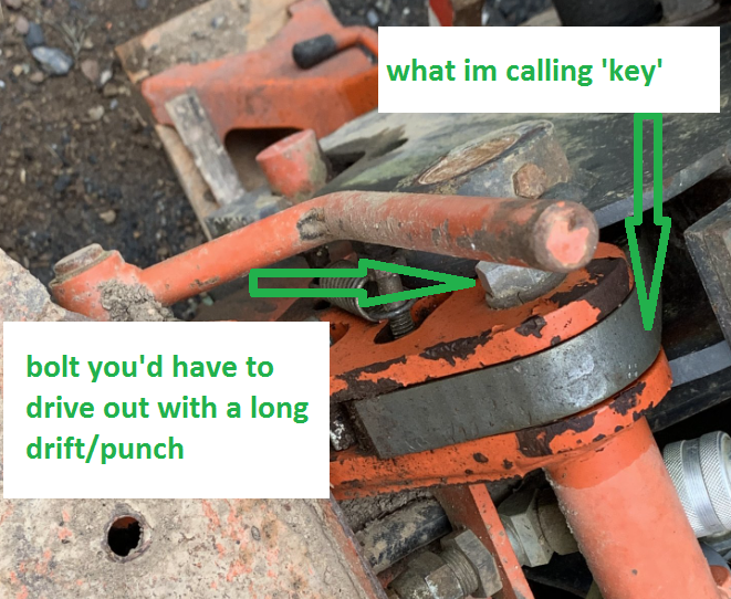

Ok im trying to understand this problem:
Depending on which part is stuck determines what i would do next.
IF the orange handle is able to move and is just banging back and forth on that small pin without actually retracting the silver 'lock', i would just pry between the silver lock and the C shape of orange bracket it's in, to try and get it moving.
If you can't get it moving by prying in that space, maybe remove that small coil spring and get a punch/drift and start 'driving' it.
By the way if you are using a 2lb or smaller hammer it's going to feel sketchy and dangerous to put in the amount of force you need. A 3 or 4lb sledge would be a lot more comfortable in terms of not having to swing it as hard or fast.
If none of that worked i'd take out the long bolt that those locking 'keys' pivot on, then after it all falls apart you can clean it up and put it back together so it works right.

The handle pivots on the shaft and moves those blocks (for lack of a better term) out of the way so the “jaws” or “key” can unlatch from the pin they encircle. The shaft rusts and prevents the handle from pivoting, nothing can move because of that.
