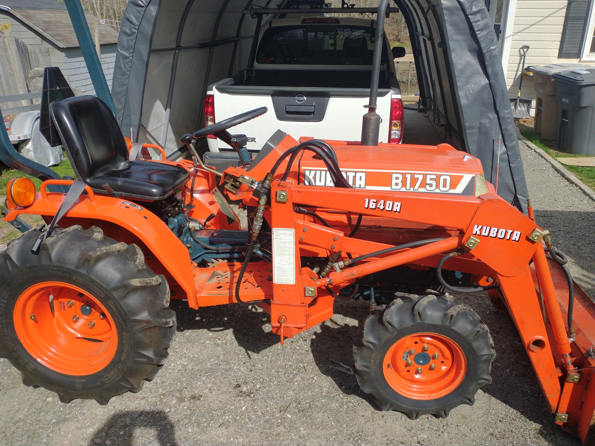

Here's a pic of the tractor. It looks 3 years old not 30
