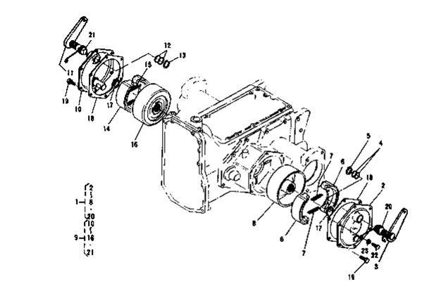

Hi Wolfman - My current problem is that I think I need to replace the brakes on my B1600 since the pedals hit the floor even when I shorten the connector rod to it's minimum - and then they don't hold properly.
Ideally I'd get a worshop manual but they dont seem to exist so I was going for a close equivalent.
I can probably do the job but some sort of diagram / method would help since they don't appear to be like car brakes!

Well I've had a look on everything I can think of but I can only find user manuals for the B1600 - no workshop manual
I'm a bit nervous of just taking it apart without some sort of guide even though it's "just" the brakes :eek:
28,824
5,191
If the brakes do match the B8200's then it's a very simple system.
Dive in and if you run into issues just take pictures and post them and we'll be able to point you back in the right direction.
This is what the B8200 brakes look like on the inside.
