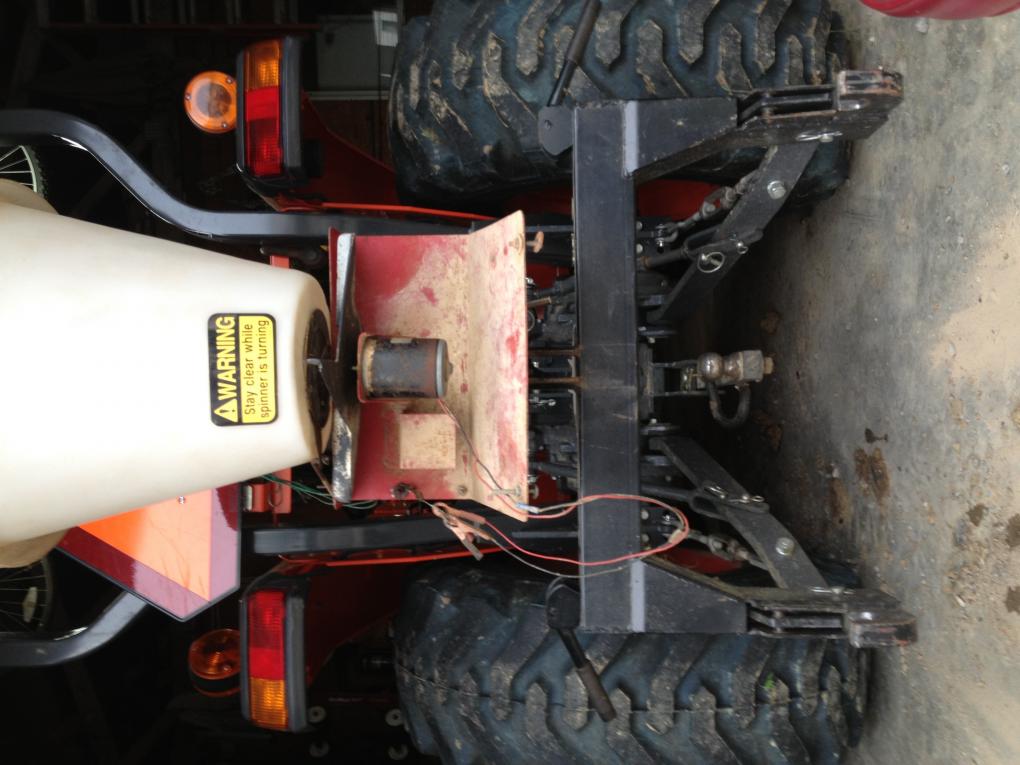

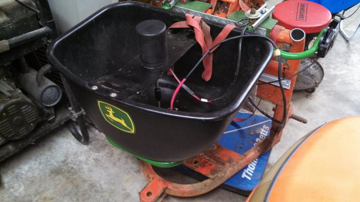

Here is the 12v spreader that I modified. I changed it up a bit from the pic, put an on/off switch on it and used the work lamp accessory plug to power it. Works great too, but I can see where the salt would end up getting on the tractor. When I used it to spread grass seed I got it all over the place. You could probably rig up a piece of cardboard or something to block it from flinging all over the tractor.
