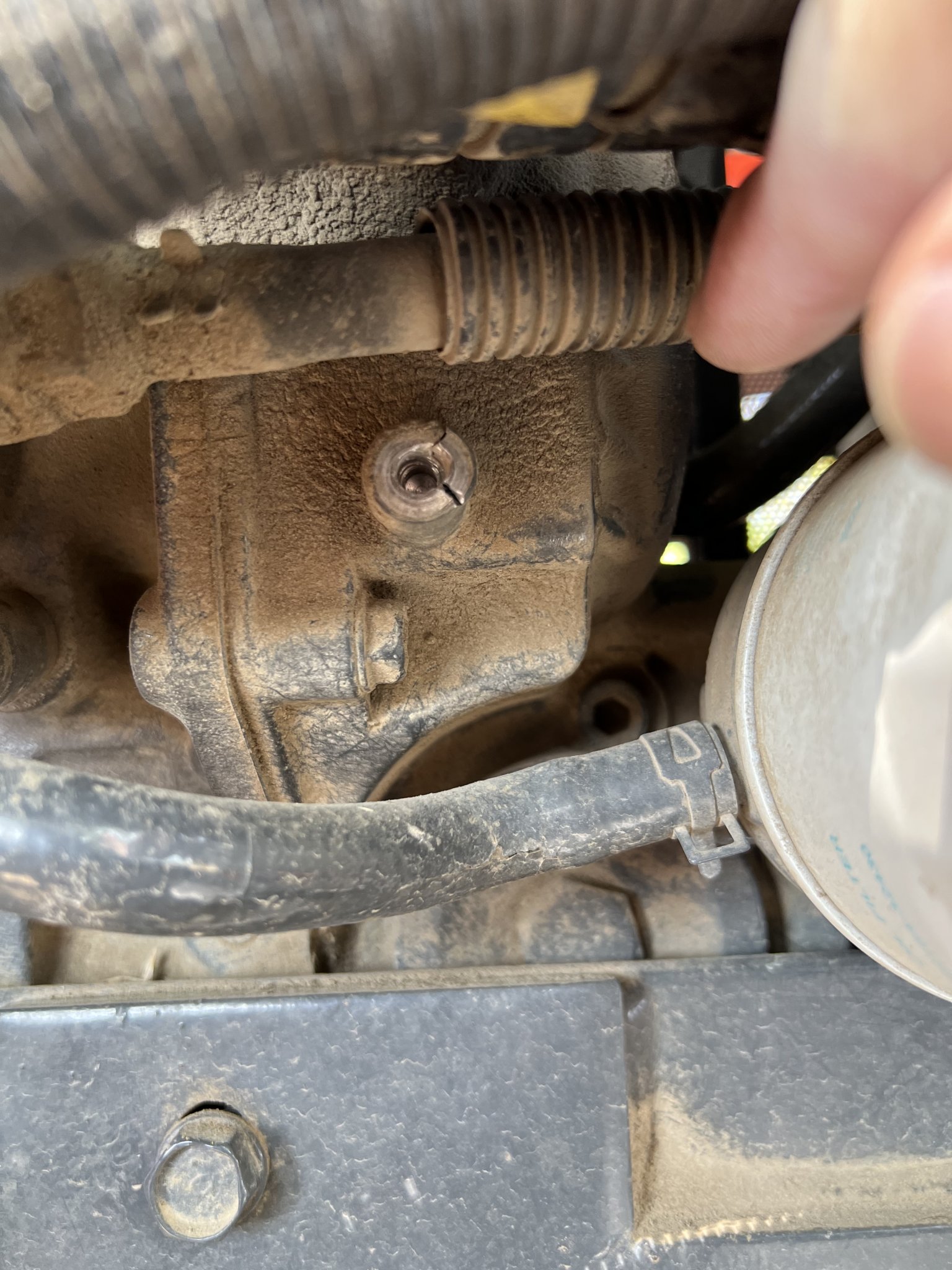

I was cutting trees in my pasture. I went to pick up several with the grapple. 1 slipped & ended up hitting the front tire, then rolling against the side of the motor. Not sure how it missed the plastic side cover & hood, but did break off a bolt that was holding a bracket with 2 wire bundles in it. This is on a 2018 L 4701. Unfortunately, the bolt didn’t break, the threaded pocket cracked & the threads stayed on the bolt.
Thinking about filling in the pocket with JB weld, drill & thread the pocket again.
Or make a stud to JB weld into the broken pocket. The stud would have the proper threads inside it. Shorten the spacer & bolt, then reassemble. Or make a stud to JB weld into the broken pocket. This stud would be cross drilled to allow me to Zip Ty thru the stud, to the wire bundles. I believe the original bracket was controlling the wire bundles. It would be expensive to replace the gear case.

If that’s it’s only job to hold a wiring harness in place you really have nothing to lose.
I think you’d have better success with this rather than trying to drill and tap the JB.
A nutsert may also work well in what’s left of the hole.
You can also fabricate a sheet metal bracket mounted to the bolt that goes perpendicular to the one that is damaged. Bend, weld, and twist as needed. Two holes for a cable tie and you're all set.

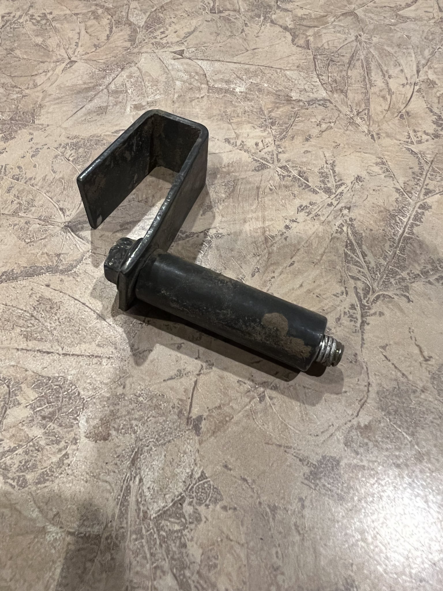

I should have supplied pics of the parts with my original posts. The 3 wire bundles are pretty tight against the side of the motor & run over the oil filter. I do not believe I could get them around/under the oil filter without damage. I am not sure why they have the additional support. If Kubota put the bracket on the bundles, I shouldn’t 2nd guess them (I think).
I am going to try D2Cat’s idea of forming new threads out of the JB weld & with the same sized bolt & Teflon tape. I will test this off the tractor first. If successful, I’ll do the tractor. If it does not hold, I’ll make a stud that fits inside & completely around the outside of the boss (more contact area), thread it & install the shortened bolt & spacer. If all this fails, I can mount a sheet Al or steel bracket to some other point.

Ya, boy, looking at those parts the engineers never counted on that bolt having to sustain any side load! Just a few threads to hold it.
Is there any chance you could drill the hole slightly deeper and to a larger diameter and then tap it out for a larger bolt? You could always get a larger sleeve to match.
You could try the J-B Weld, but I doubt it's going to be able to handle the leverage from that long bolt with just a small area of adherence.
Keep in mind too that J-B Weld does NOT like oil or grease. I've tried using it to fill pits on seal bosses, and it doesn't last in that application. When it's continuously exposed to oil or grease, it gets soft.

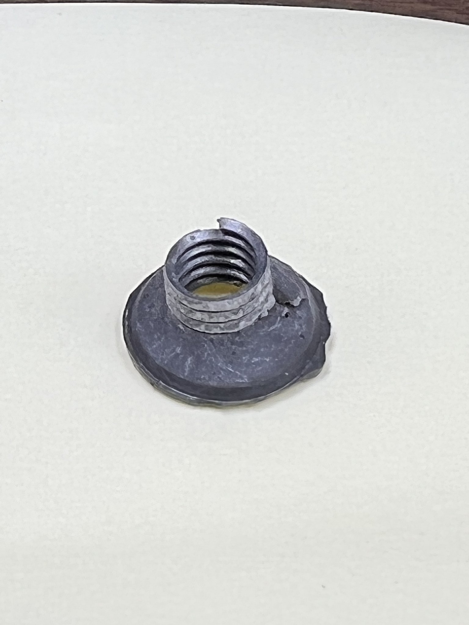

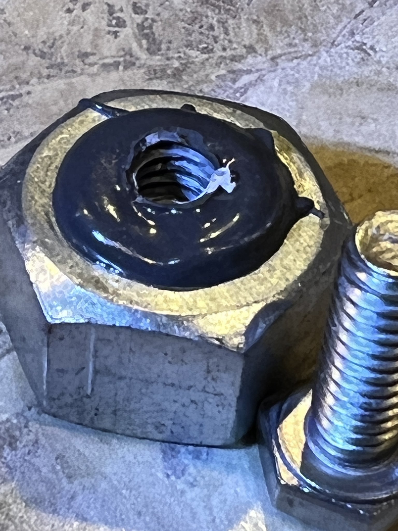

I tested D2Cats suggestion of forming threads with the JB Weld use a bolt wrapped with Teflon tape. It worked. The bolt released very well, leaving very good threads. I tested the strength of those threads & was not pleased. The 1/4-20 bolt stripped the threads pretty easy. I tapped the JB Weld to 5/16-18 & had more strength, tapped again to 3/8-16 & found this to be pretty strong. Good enough for my needs. I believe the strength issue was related to the surrounding thickness (to the bolt) of JB Weld.

My plan is to use this cap & JB Weld it into the boss on the tractor. I will wrap the bolt with Teflon tape so I can remove the bolt if needed. The cap gives me 3/8” more threads. I believe the key to success lies in the bond of the cap to the tractor, by the JB Weld. I will thoroughly clean all the parts before bonding. I made a shorter spacer. I’ll assemble all the parts after the JB Weld cures. 🤞🤞🤞
