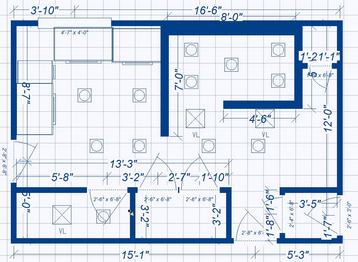

We have a small 4-bedroom house at ~1,500 sq. ft..
1 and 1/2 baths right now. Full is downstairs, half is upstairs where bedrooms are.
One "bedroom" is very small, and thinking it will be sacrificed for a bigger bath.
We're looking to re-do both bathrooms at once to get to 1 and 3/4. They're located directly over each other.
Our parameters are:
Upstairs would be about 8'6"D x 14'6"W. Hope to have walk-in shower, tub, and double vanity, toilet, some storage, etc.
Downstairs could be up to 10'10"D x 6'W . Hope to have walk-in shower, toilet and single vanity.
Both have a 20" x 30" metalbestos chimney chase in them.
I think downstairs bath needs a handicap accessible door. Not sure we can fit all the HA features beyond that, except the toilet (?).
We're both crowding 60 years old hard. In good shape.
Design is not my strong suit.

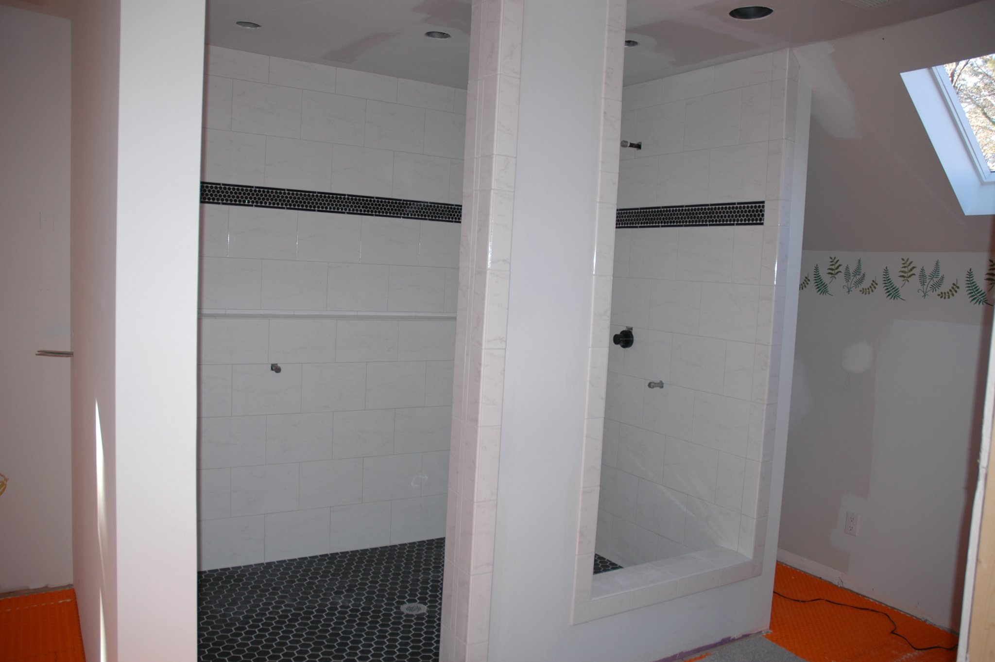

We redid our bathroom two years ago. Got rid of a giant Jacuzzi tub and a 4X4 stall shower. We had to have the shower floor up 2" because the joist below could not be cut out and scissoring in doublers would of aded too much to the cost. The 2" can easily be dealt with for a wheelchair by a micro ramp. Two hand held sprayers. One wall mounted shower head. Wall length shelve Five lights in the ceiling. large glass panel. No shower door needed.
36" doors. Heated floor (it is over a garage).
