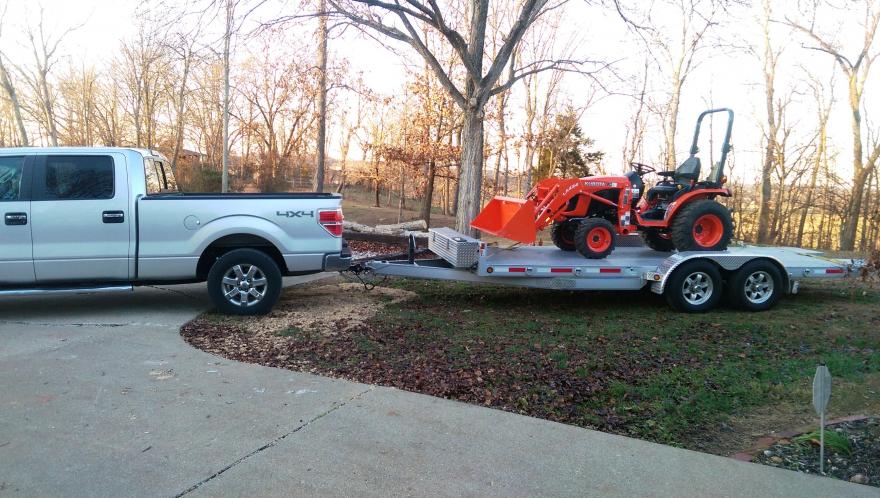

I have an 18' Car Hauler with a 2' dovetail. I haul my Farmtrac with 6' bush hog and still have room in front of the tractor for a box blade or other implement. The ramps for mine are fold up and can be easily slid apart or together. The axles are 5000 Lb and the capacity is 9k. Paid $3000 at port city trailers in Mobile AL. There is absolutely no substitute for a proper trailer to haul your gear on. Also....make sure that your ramps have feet. When my ramps are down, the feet keep the trailer from picking up the back end of my truck when I load. (Makes it where you can load without being attached to the vehicle).

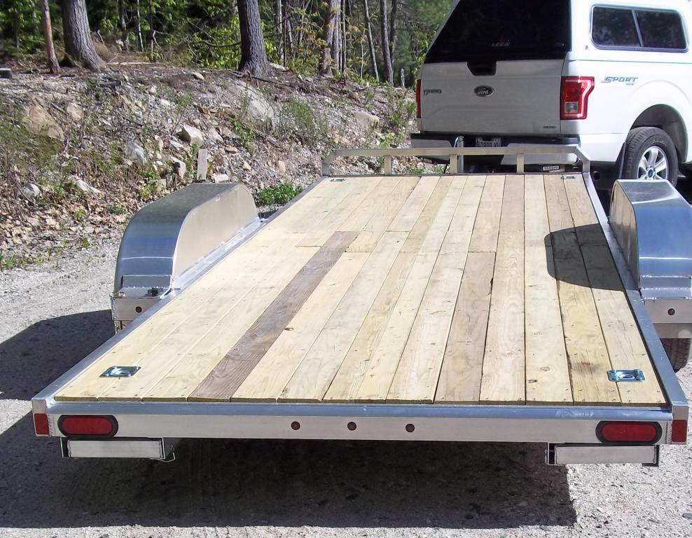

I bought a 18' mission aluminum car hauler a few years back. I was looking a camper trailers one spring and ran across the trailer 'on sale'($3400.) The ramps slide into channels under the trailer. Slide them out and adjust the width as needed.
One thing that sucks was the tiedowns. Hardly any at all. I haul my tractor, ranger , ect on it and the lack of tie down points stink. Or did for a couple days.
I bought a length of 2x2x1/4" aluminum angle. Chopped off a bunch of 4'' long pcs. and mig welded them in the vertical position to the sides of the trailer every 2'. Works great no matter what your hauling. Yes there is a tie down point close.
I didn't have a photo of the trailer side but will take one soon.
