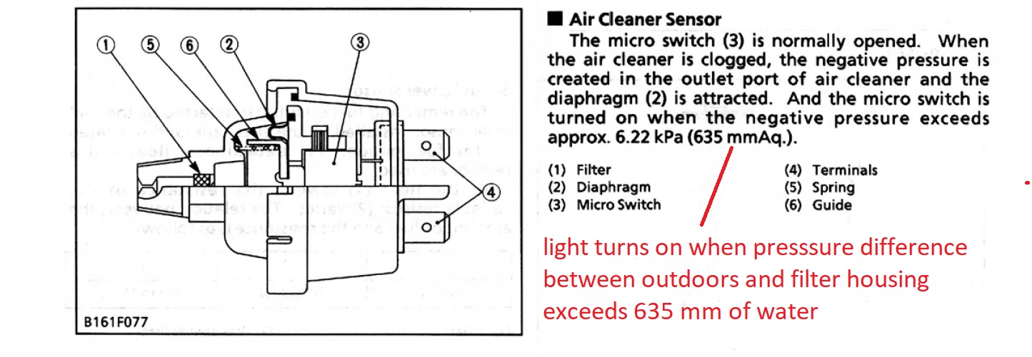

I think your sensor is doing exactly what is was designed to do which was to sense a restriction caused by the filters. Such differential pressure switches are used on lots of air moving equipment and have always been much more accurate than someone's visual exam.

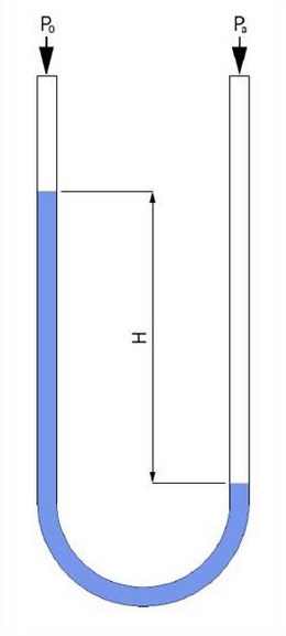

If you don't trust the switch, buy a piece of clear plastic tubing. Get a tube which will tightly fit into the hole where the sensor was removed. If this is a large hole, just leave the sensor installed and drill a hole to fit a 1/8" tubing adjacent to the sensor Size the holes so the plastic tubing is a snug fit in the hole. Add a bit of water with food dye into the tube which you droop down into a U shape.
Start the engine. The water level in the U shaped clear tubing will be high in one leg of the U and low in the other leg. Using a simple ruler measure the difference in fluid levels in each leg. That measurement is your pressure drop through the filter in inches of water.
The switch turns on with a difference in pressure of 635 mm of water which is 25" of water.
Your U shaped tube must be long enough to deal with a difference in water height in each leg of over 25"

The dimension H will be 25" if the light is turning on and the switch is operating properly.
