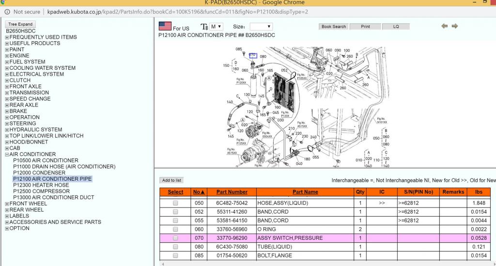

I looked for the LP switch in B2650HSDC parts catalog again with no success. Can you PLEASE reveal what section you located switch in?
Thanks,Jim
200mph
Mar 3, 2017
1,228
60
PA
200mph
Thanks,Jim
I applaud the effort in looking!!!
It's shown in drawing P12100 AIR CONDITIONER PIPE
See attachment for more detail.
Let me know if you need more help.
I agree Kubota doesn't always make it easy to find the parts.
