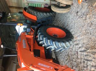

What a pain they don’t fit worth a darn !
Even in instructions it says “cut to fit”
My suggestion is !!
Keep your money or look for aftermarket answer !
I can take Better pictures of you guys want them ?

If you want extensions for the rears or fenders for the front's, get yourself a plastic (polypropolene) drum and cut them. You'll have to make attachment brackets for the front's but that is what I'd do. In fact I'm gonna makes some for my M's as I'm always tossing crap up on my front glass on the cabs.
IMO, all FW assist tractors should come with front fenders.

I've seen a few of the big boys with gen.. I mean fenders and they look about like your photo.
Were you able to see others in person before purchasing?

Nice. Wheel cut on both my M's make front fenders a touchy issue. I'm going to fab up something because just one mud puddle on the dirt roads I run on to get from field to field can really play hell on my windows. Wht I may do is offset my fronts (they are adjustable) out as far as possible and then add fenders made from a plastic chemical drum. I need to paint my rims anyway and mount new front tires on both machines.
