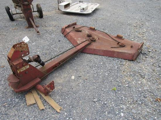

So i feel like the odd guy out for even asking since so many people are sticking right to the main topic, but.. why even mid mount? Why not 3pt?
I know some people have maneuverability concerns but.. if you're buying a whole new tractor, you're way past zero turn money so the tractor must be intended to do something else anyway... loader? If you've got a loader and are leaving it on for mowing then in my mind you can afford to give up the 'rest' of the maneuverability of going from mid mount to 3pt mower, and in terms of maneuverability if that's really the big issue would you consider a 54" for that reason? Because if not, i would postulate it is not that big of a concern.
I have a 48" 3pt finish mower that is light enough that i can push it around on dirt to line up the 3pt links easy enough. I have a 60" MMM from an old cub lo boy that i am planning to build into a 3pt mower (48" is for sale, its a little small for me). I also have an old 54" Continental drive over 3pt (!!) mid mount mower deck i haven't tried yet, but SEEMS like it could be a nice drive over mid mount option because all the attaching you need to do is basically out in the open at the rear.
Is that a "Rube Goldberg brand" mower?:love: That thing is weird looking but I love it!
I believe the brand is Continental Belton. In my mind 'its gonna be great' but i haven't run it yet so it's all theoretical right now.
Makes perfect sense, knowing that. (y)(y)
Apparently, it is KTR-60 model and it works a lot better than I thought:
Mine is a 54 but i know they made several versions.
itBmine’s comment about the pto shaft is one reason why i figure these might be less annoying.. all the connections you make are in the open at the rear, and the back of the mower (the 3pt end) is light enough to push around a bit if you need to.
