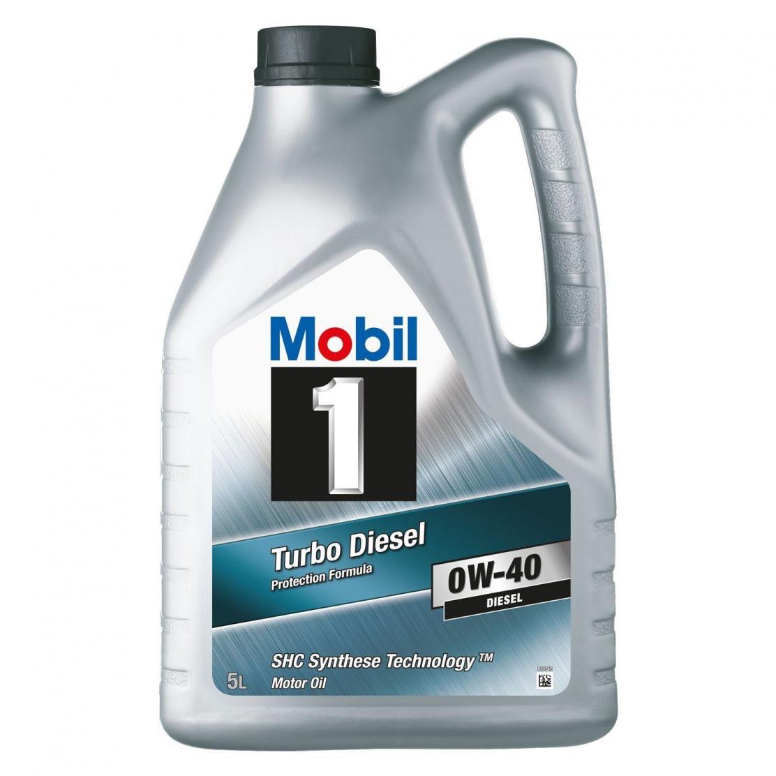

i put mobil 1 turbodiesel 0 w 40 in my B2620, and the engine seems much quieter
10,423
2,215
I would love some of that stuff !!! - where you find it??? cost? $6 per quart?
