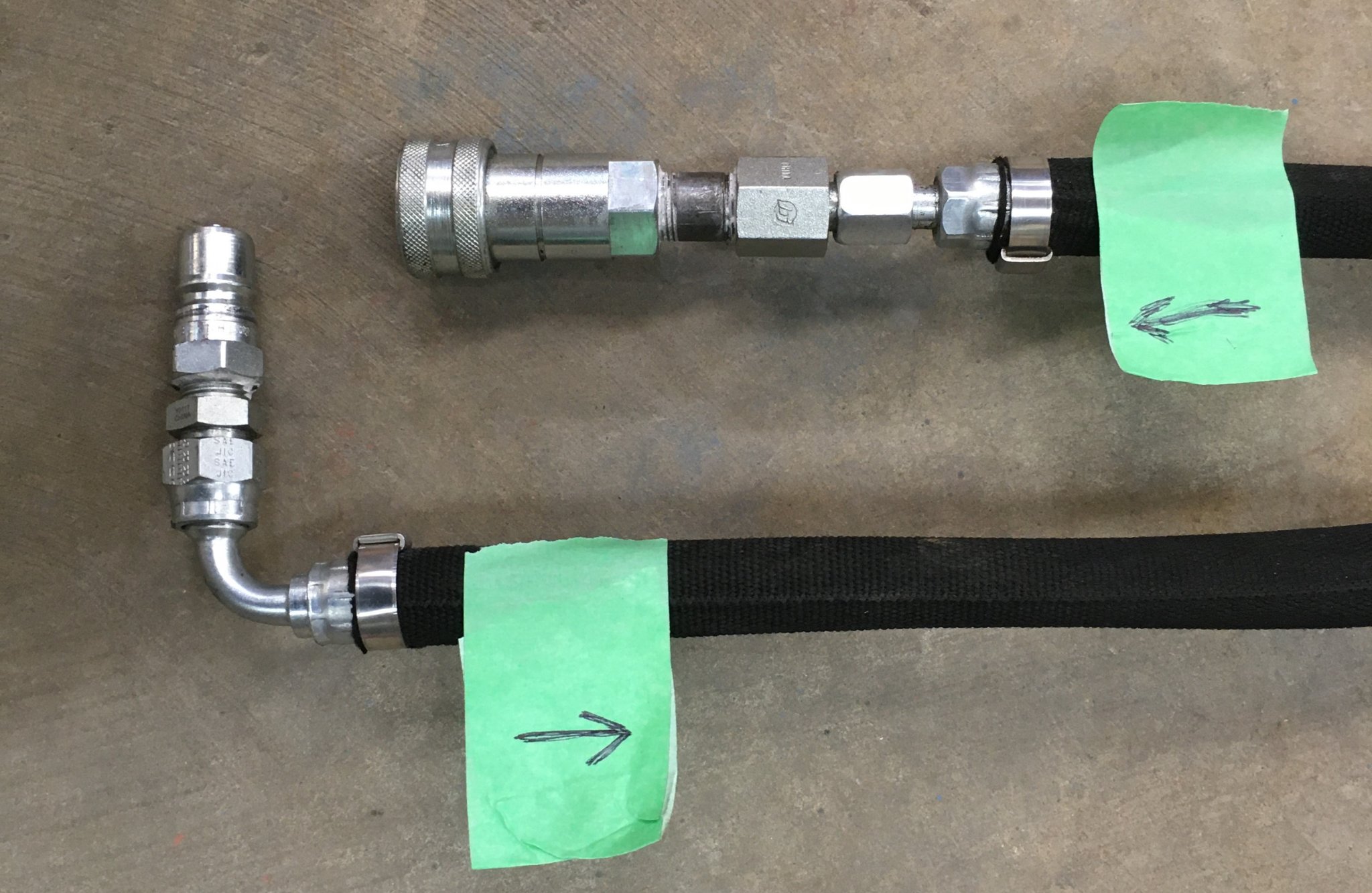

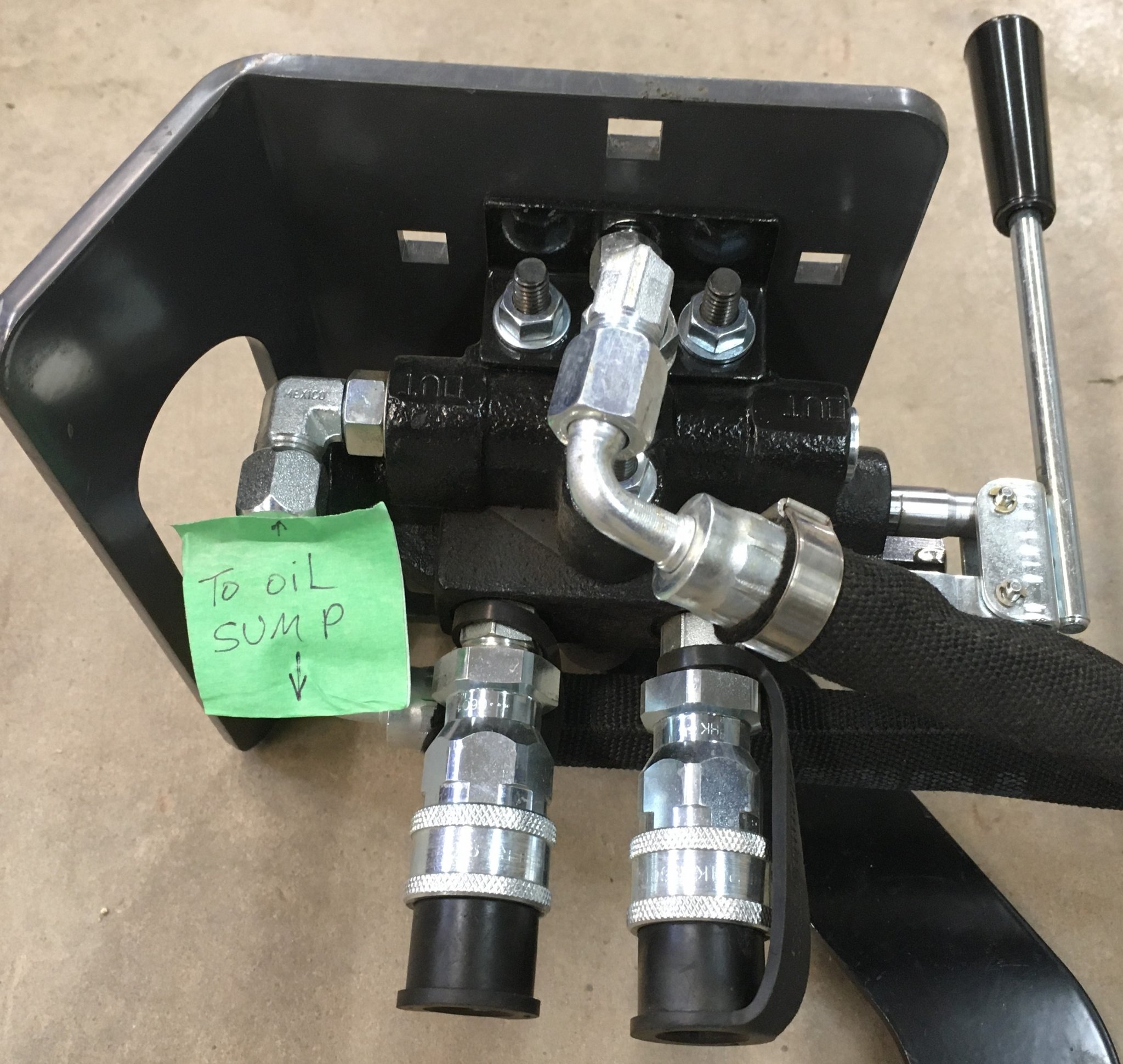

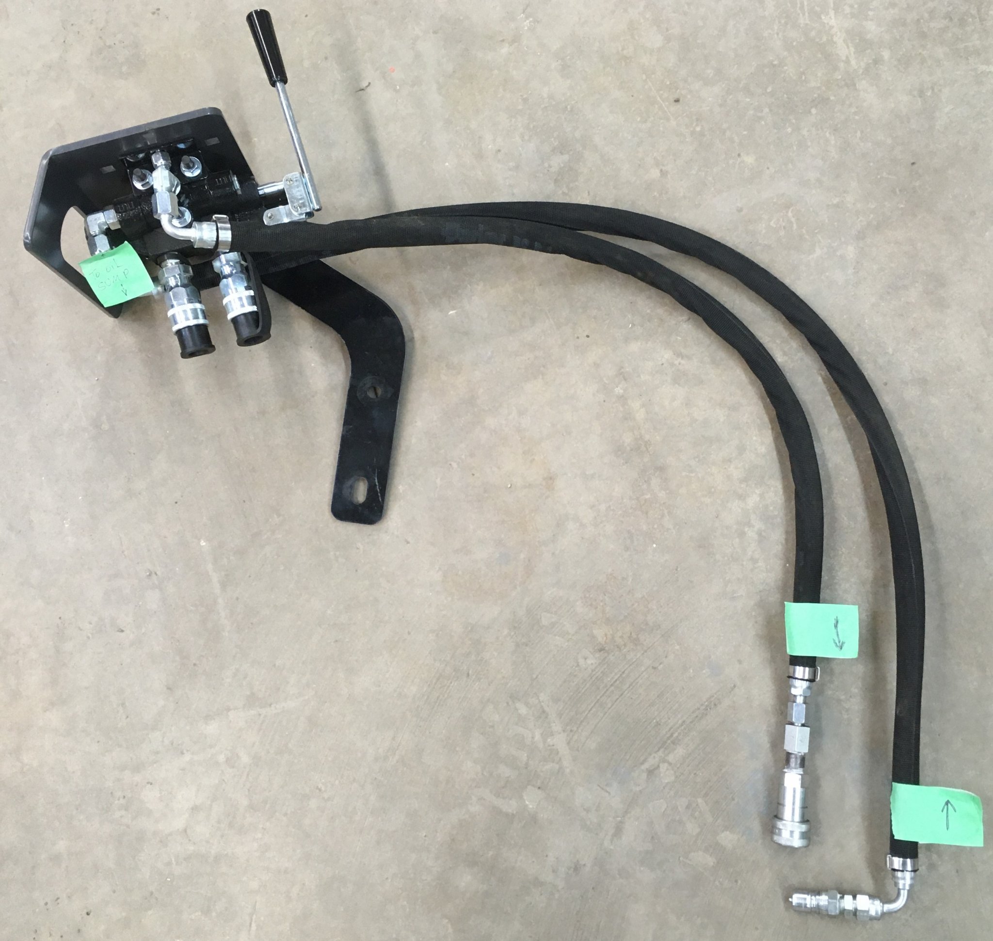

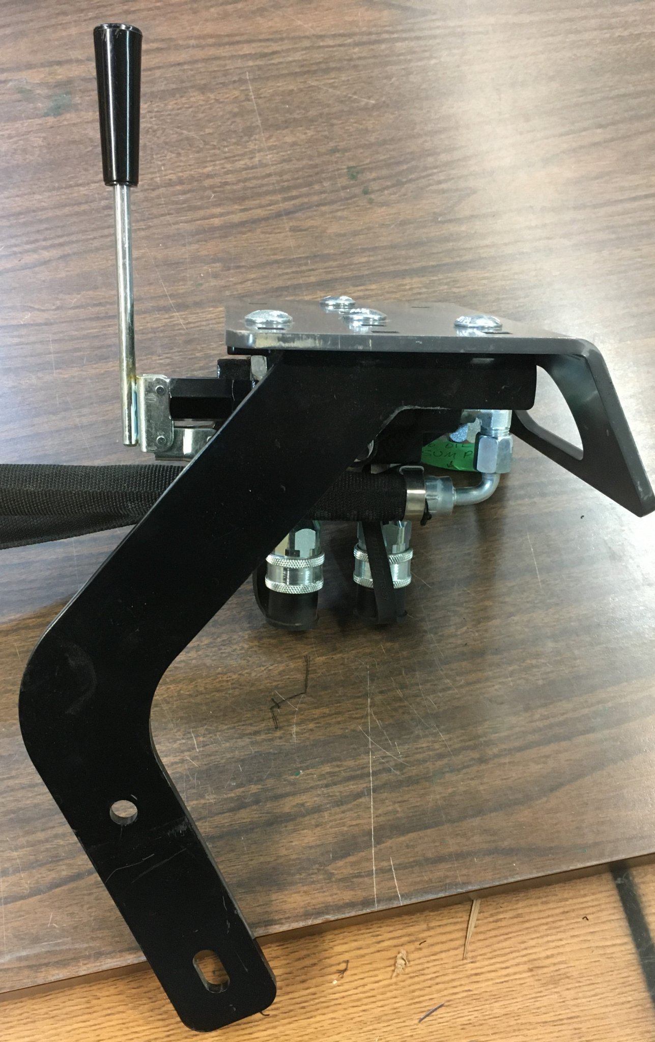

My backhoe (BH77) only has two quick connect hose hookups. Hydraulic in and out. Here's some pics of the rear remote that the dealer installed. The pics show the assembly as removed from the tractor. The two hoses connect to my backhoe quick connect couplers. Not shown is the return hose that connects the valve to the oil sump. I leave that on the tractor and just cap it off when the assembly is removed. You'll see the return (out) port capped off on the valve also. The way this is presently set up....I can not have the backhoe operational at the same time with the rear remote.
B2650 ROPS Rear Remote.JPG Hookups to Backhoe Quick Connects.JPG Sump Return Capped Off.JPG Rops Bracket Mount.JPG
The last pic is of the mounting bracket that gets clamped to the rops above the right hand fender. You can see the auxiliary quick connectors pointing straight down and have their rubber plugs in place.
There is a hydraulic "T" fitting off the tractor's sump where the hydraulic "return" hose from the valve is plumbed into.
"Hydraulics" is not my strong point by any means. I'm not sure if there was a reason that the rear remote could not have been installed in "series" with the power beyond circuit to the backhoe's pressure input connection. Is there concern with these valves of possibly too much back pressure developing from the backhoe? Or maybe the installers didn't want to hassle with more complicated hydraulic plumbing? With a hydraulic thumb on the backhoe....it might be nice to have.

The valve could be installed in series with the backhoe. Connect tractor supply to IN on valve. Connect PB on valve to IN on backhoe. Connect tank port on valve to sump. Connect PB on backhoe to return on tractor.
To remove backhoe simply unplug both backhoe hoses and connect PB on valve to return on tractor.
