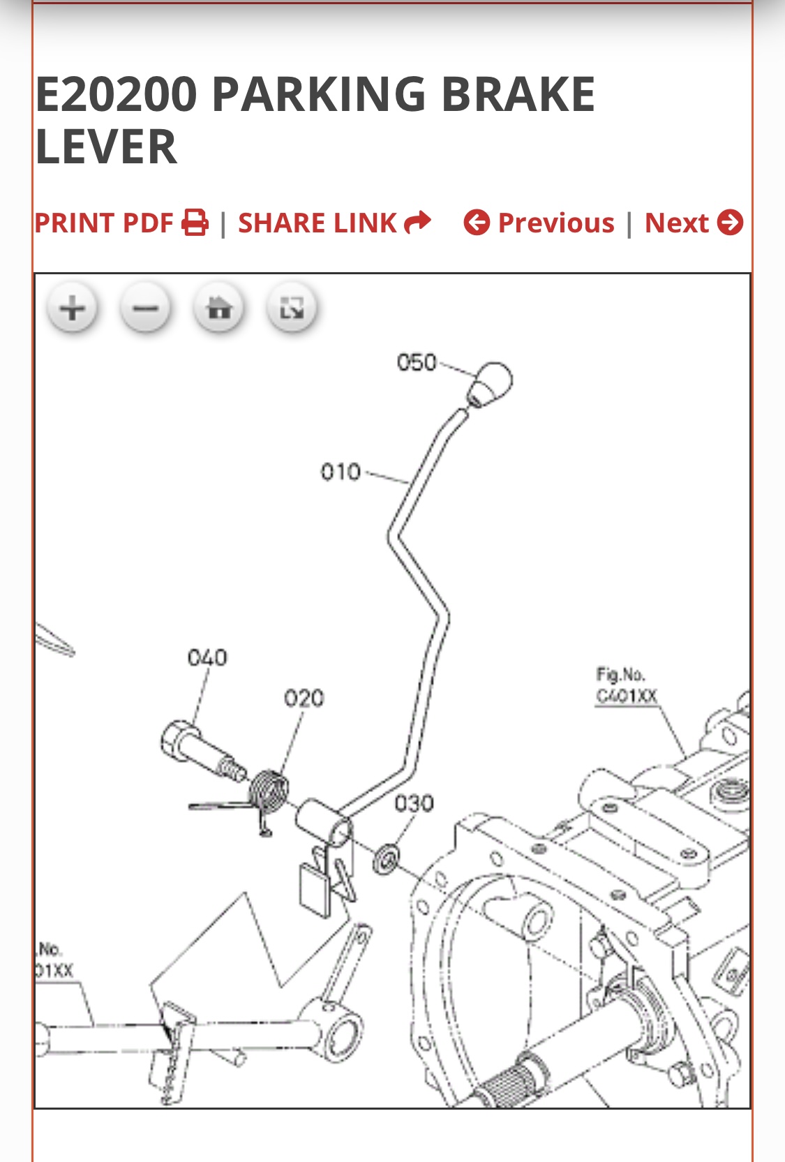

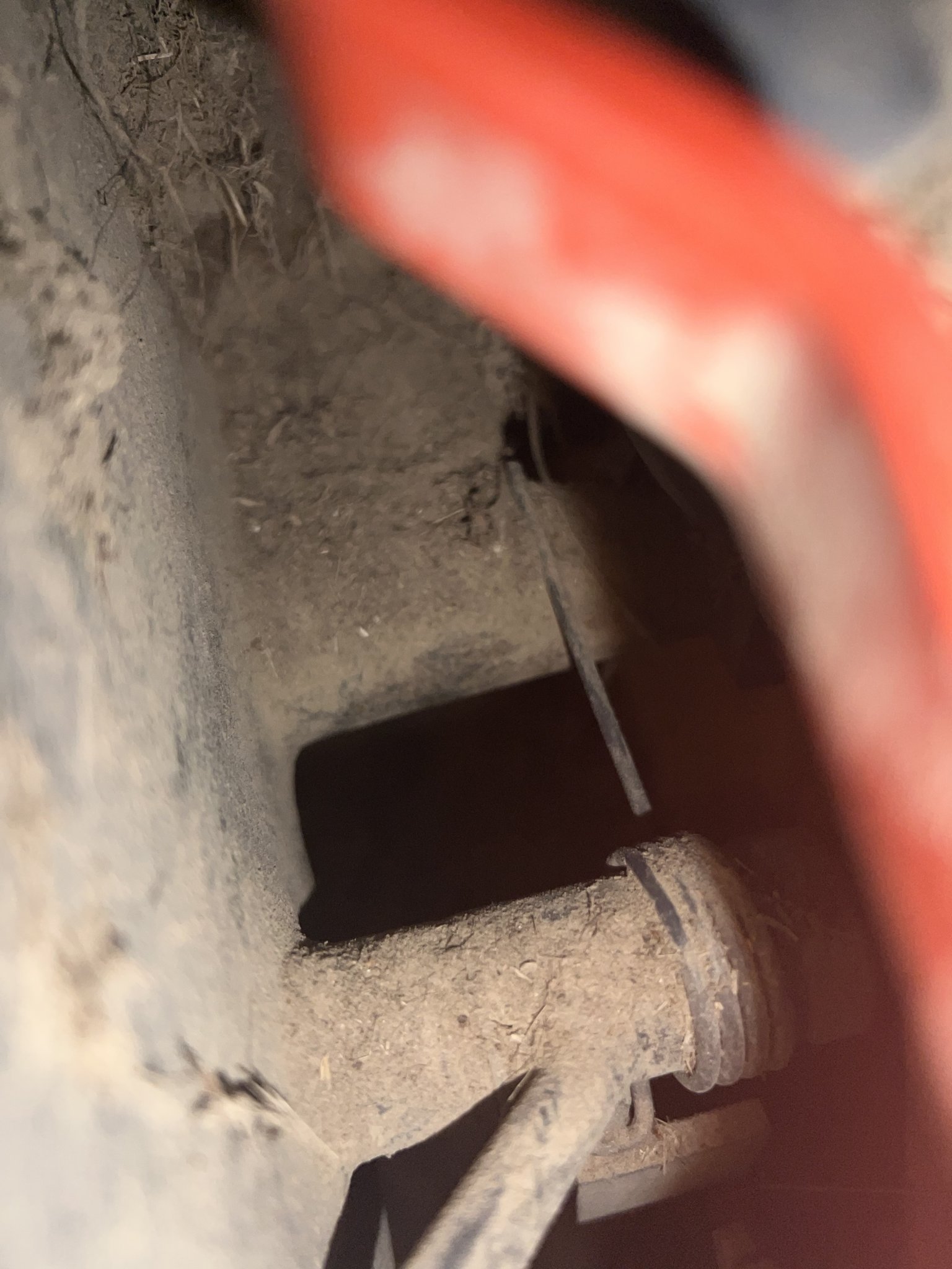

Hello:
The subject spring came loose that provides tension to engage disengage the parking brake light when the brake pedal is activated. I purchased a new spring thinking the exsisting one was damaged. The new and existing one are the same.
I have poked around in the web and YouTube to see how this spring should be reconnected. No luck. I am hoping someone could help share some light on this one.

Not overly helpful, but found this on Messicks:

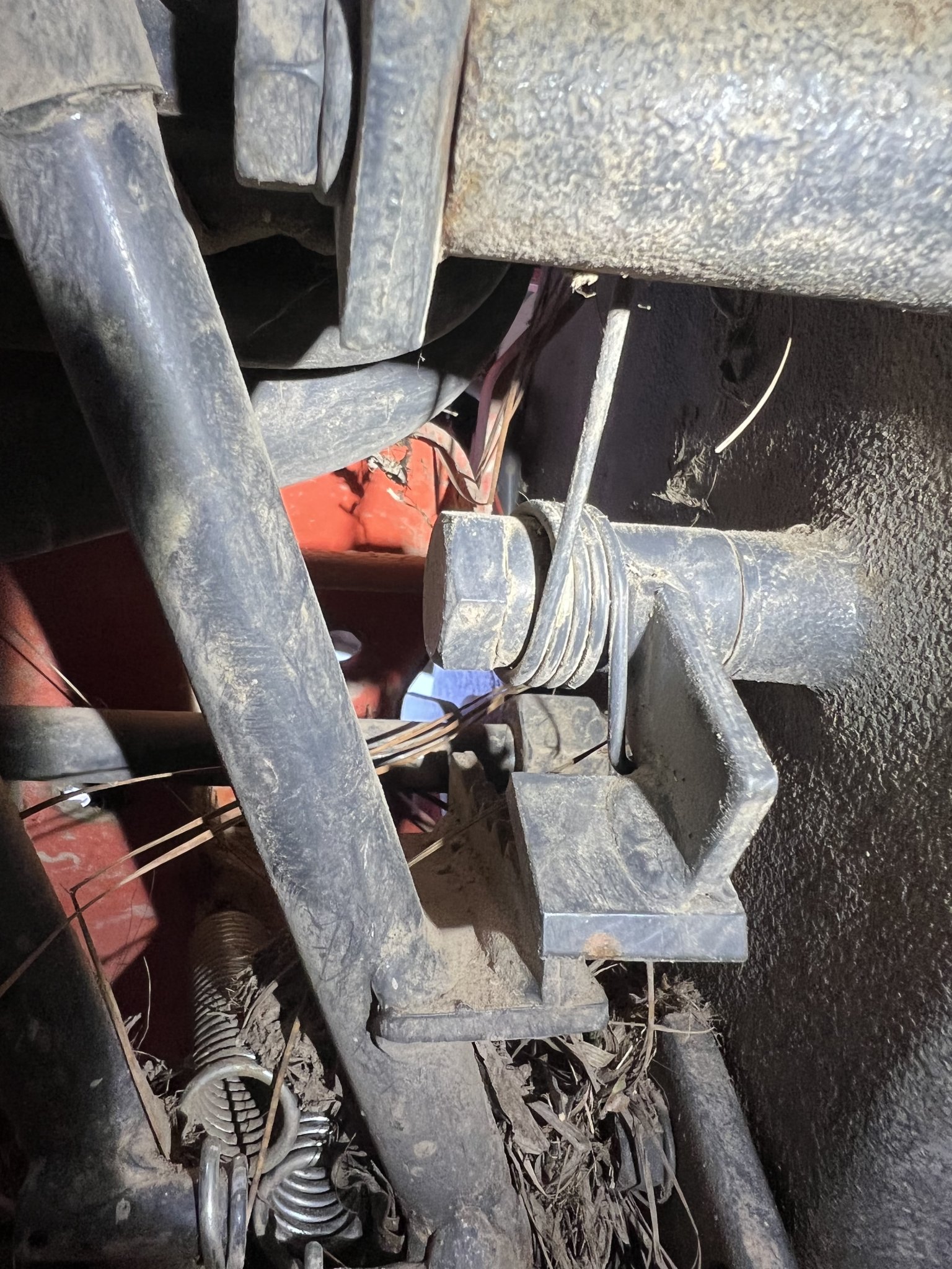

Does this help any?
the long end just sits on top of the trans housing boss where the floorboard support bracket bolts to

Does this help any?
Wow! This sure gets me started in the right direction.
Would a top side pic looking down through the step deck add any more clues?
Your help is greatly appreciated.

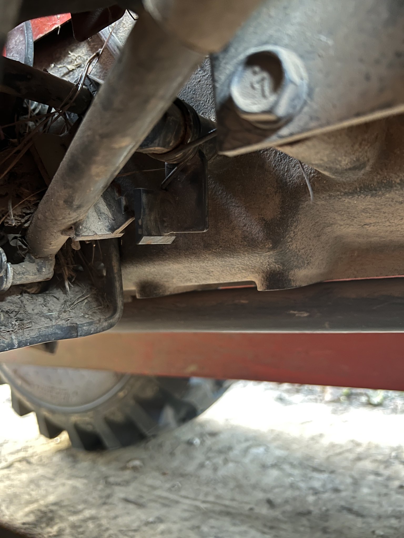

thats kind of a hard spot to get my phone in for picture but I’ll try.
With this pic and your comment, I successfully reattached the spring today.
Working from below did not prove to be productive. It took removing the transmission cover, and the right step deck to gain easier access from above. Smaller hands would have helped too but, got er done.
Many thanks again for your help.
