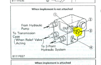

At the factory parts website you'll see the L3450 had a lot of optional hydraulic setups. If the machine has a loader its supply and exhaust hoses would connect to the "hydraulic block"(bolted to the frame). That block has a slotted screw head that operates a diverter valve inside, sending flow to the three-point hitch. Even if there is no loader, the diverter is still there, and could be in the wrong position - or partially out of position. Look for a slotted screw that can be turned 1/4 turn and see if its between positions. Hope this helps. Dick B.

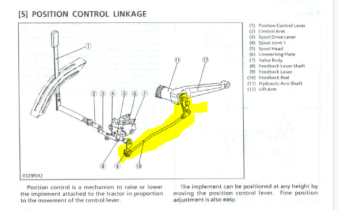

First you have PS so power is going through the pump to the second pump stage.
Since you have a WET clutch and it's moving that tells me the the first pump is working so that rules out suction issues and firsat pump issues.
Like @rbargeron suggested check the selector valve on valve block just under the pump.
It should be in this position with no loader attached.
Next check that the feed back linkage is intact and the rod is locked to the adjustment point and not loose.

There is only the one lever for 3 point adjustment, then the flow valve knob at the front of the 3 point assembly, under thefront of the seat. The linkage is intact, and is moving well.
Since the 3 point was working before the tractor was parked, I don't think the selector valve would be in the wrong spot, but I'll certainly check that. I'm working 12's until Wednesday, so I'll check then, when I have some daylight after work.
