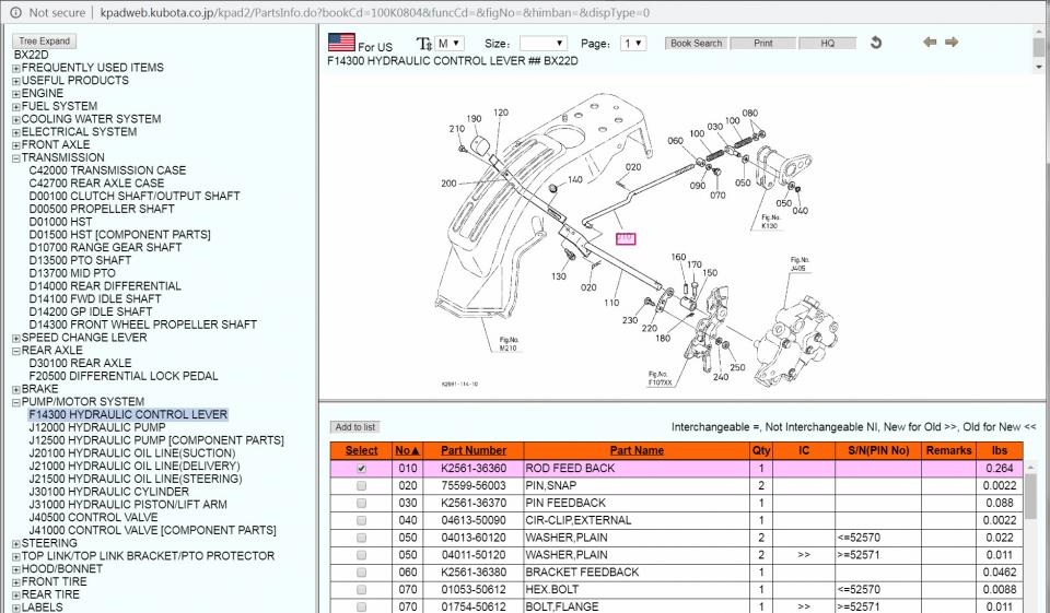

I believe there is a "feed rod lever" adjustment on the right side. Not sure what it's specifically called hence the quotes.
Your close:
Feed back rod / linkage. :D
And yes that out of adjustment would cause the 3 point to act very weird! ;)

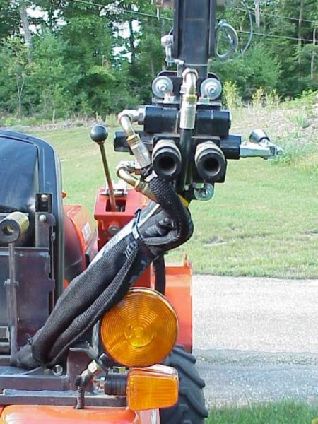

5,196
3,850
One more follow up post on what was the root cause of the 3 point hitch not working. When I got the tractor back, I reinstalled the Curtis Cab, and the rear remotes (BX7322 Remote Valve Kit), which I removed prior to sending the tractor to the dealer for repair. Once I put the remote valve back on the tractor, and tried the 3 point hitch, I found that it wouldn't work. I also tried the remote valve to see if it was working, and learned that it had failed. I have since removed the valve and its piping, and the 3 point hitch once again works the way that it is supposed to.
I contacted Messicks looking for a repair kit for the Kubota remote valve BX7322, and they can't even find the valve assembly. I then contacted Kubota directly, and spoke to someone in customer service, and learned that the part had been discontinued, and that no service parts were available. At this point, the only choice that I have if I want to have a rear remote valve on the tractor is to purchase one from one of the hydraulic parts supplier.
